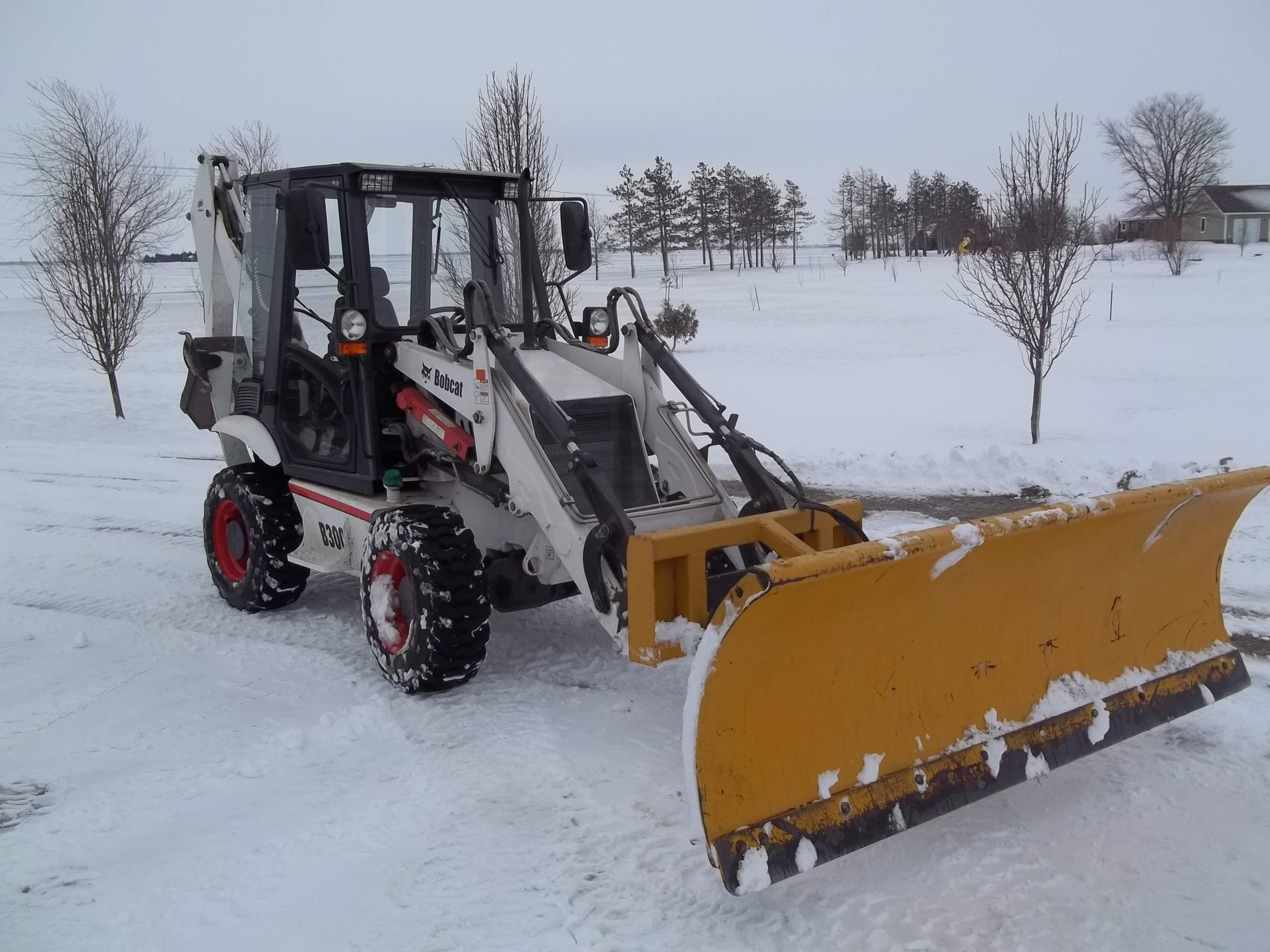

I have a 2005 B300 TLB with cab and heat. I bought mine from the original dealer who had it in his rental fleet. It was one year old with 69 hours. I used it to build my house, landscape, install all utilities and put in a septic system. It now has 385 hrs, and still looks like new. You will have plenty of power and traction in snow. I have a 9 ft. plow on mine, and it just plays with it, It was an old plow I just put a QT plate on. I have a set of forks, a couple of buckets and the plow. I have rented many attachments for it and they all work great. I hope to never sell this machine, so my heirs will have to fight over it. By the way, I had an excavating business for thirty years before I bought this. Will try to post a picture. 100_0691.jpg100_0689.jpg100_0694.jpg
