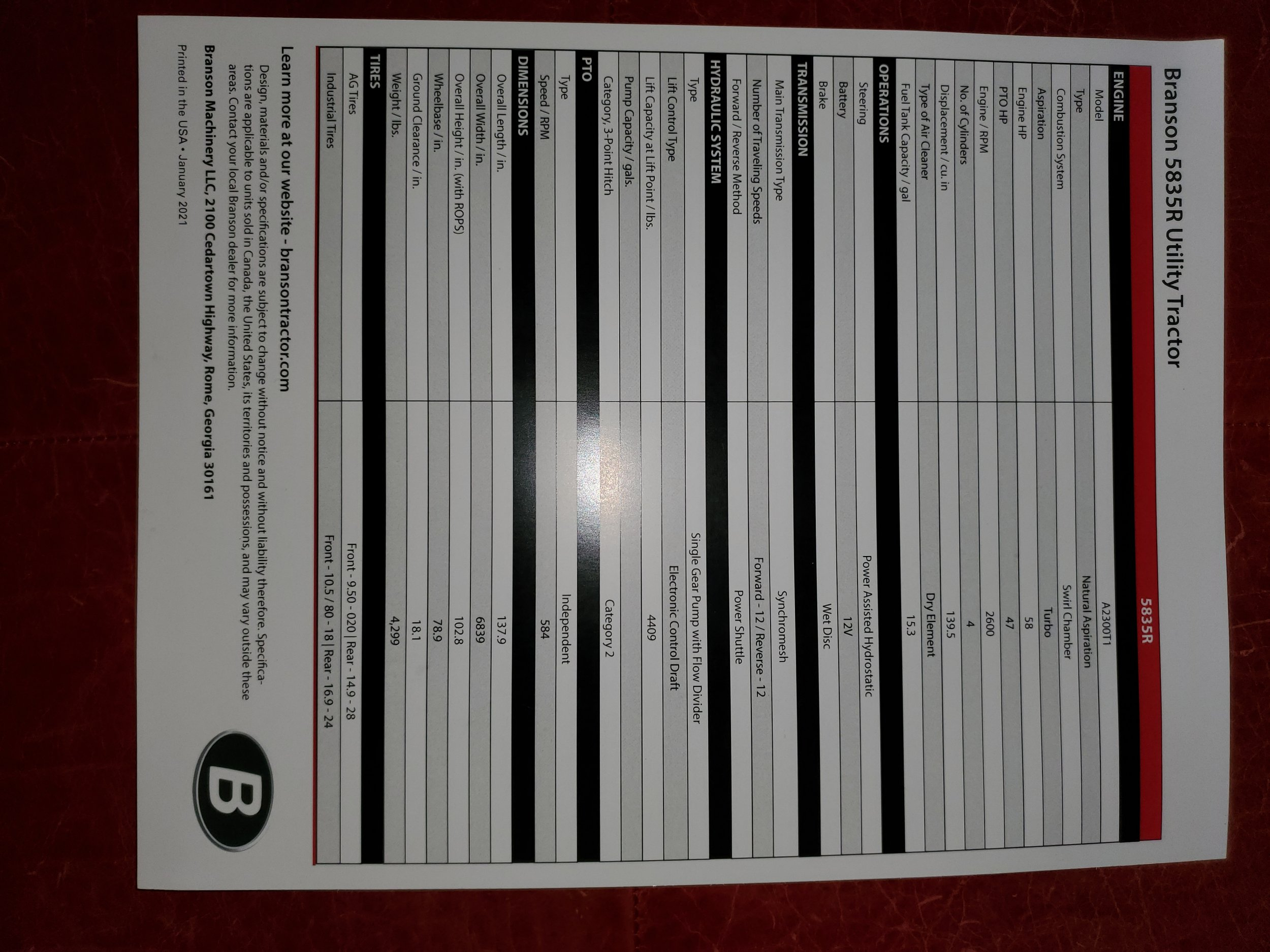

They had one in stock yesterday at the dealership. Here is the spec sheet...
   / Anyone with a Branson 5835R having opinions of comparables? #39
The back...
