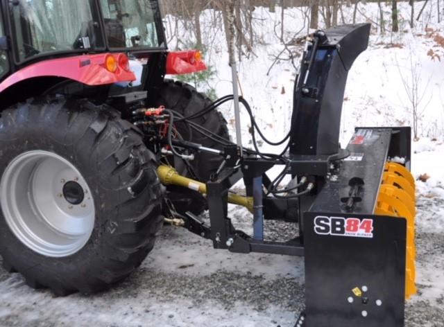

I have an 8' Fisher plow up front and a WoodMaxx SB-84 on the back of my Mahindra 2655 HST Cab with 44 PTO HP and have no issues. You need to look at the snowblower and consider how much volume it is capable of moving. A large diameter impeller with throw the snow further but will also require more power to do so. A deeper impeller throws more volume of snow. You need the right balance. The SB-84 has a 24" impeller and it's 7" deep. You don't want one with a 26" or 28" or bigger diameter and 9" deep or you'll definitely need a lot more HP to run it, the HP curve required is not linear. Be reasonable in what you're trying to do and you'll be fine. I don't know why more people aren't buying the WoodMaxx than all of the more expensive brands. It's built better than others I looked at and it's under $3k new delivered with full hydraulic or electric chute and deflector controls.
I do both plow and snowblow any storm more than 6". I make my first pass with the plow pushing snow from one side toward the middle of the driveway then the return pass is with the blower to get rid of all of it. Seems pretty efficient to do and it puts the snowbank 30 feet off the driveway.
