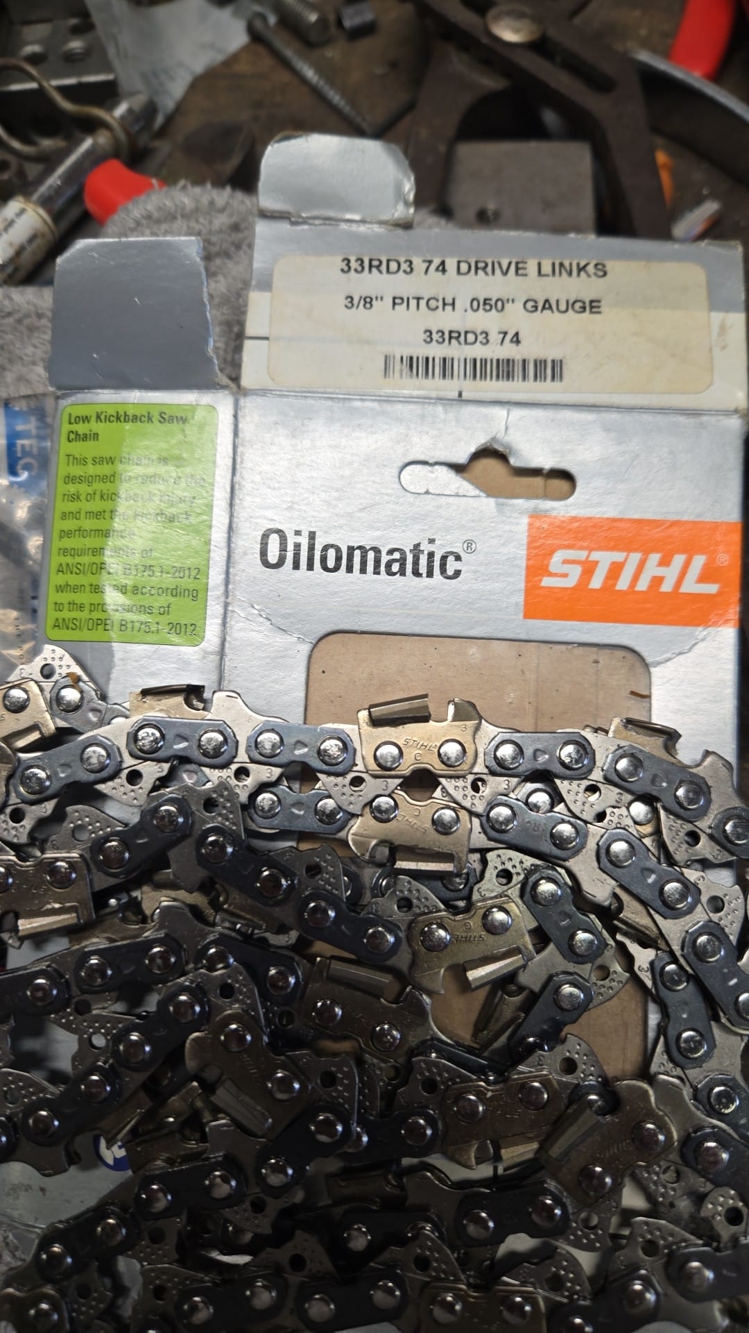

Semi might do what you need. What most folks use for dirty or sandy wood.
But if you run into something like I did this year. Carbide was only thing that make it cake work for me. Not the cheap china made carbide ones either that come apart easily.
You need diamond coated files to sharpen or to make it easier diamond dremel in size needed or diamond grinder wheel.

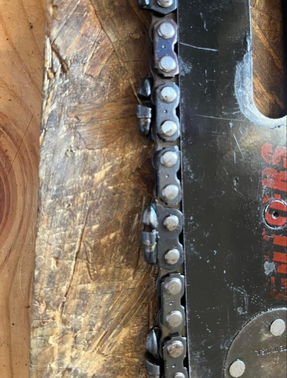

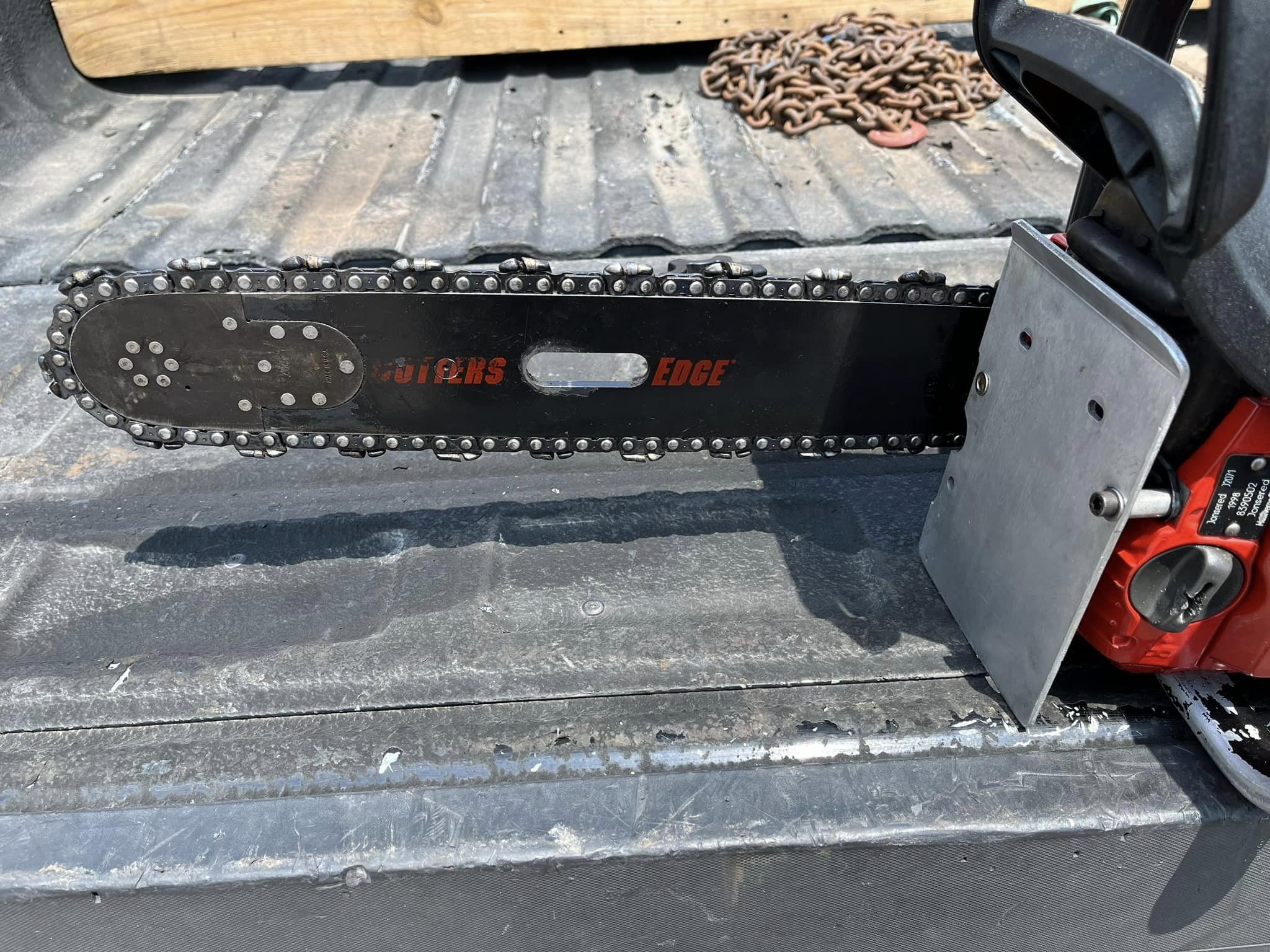

In the fire service we ran "Terminator" chains by Rapco for roof ventilation. As 5030 pointed out, a conventional chain would only last minutes. These chains did not cut, they ripped through the material because there was no passing of the chip through the link.
It was always amusing to watch a new firefighter try to cut a 12" tree. After he got frustrated, we handed him the "tree saw" and success. :)

I wondered about that bullet design one too for FD. I figured it does same thing as that one. Rips not cutting.
I'll grab the pic of one FS in my group.

Bullet chain I think it is made to do as your describe. Just rip the crap out it.

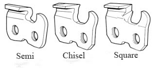

I love chisel chains. Most of my chainsaw work anymore is making/maintaining trails. Lots of cutting off stumps at ground level. I've always "heard" how bad chisel chains are in dirty wood, but honestly, they don't seem any worse than semi chisel chains. Dirty wood does dull chains, but when that happens, I hand file them to (mostly) bring them back. After 5-8 repetitions of that, I get it sharpened at the shop.
