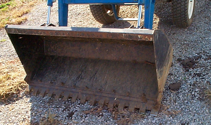

Yes, I have the Rezloh tooth bar on my bucket, it is really great for all my uses. I like it so much that I had it welded on. Does a fairly good job when digging and just in the last few days in breaking up the ice that covered my driveway. The ice was so hard that driving on it would leave NO tracks. But I was able to backdrag with the edge straight down and rake the ice enough to break it up. The edge also allows me to overfill the bucket when hauling dirt, pickup large tree trunks/limbs without getting off the tractor. There are a lot more things that I do that with a standard tooth bar I would not be able to do. About the only thing that a standard bar might do better would be starting holes, once the surface is broken, the rezloh works real well.
It may cost a little more than a standard toothbar, but it never needs to be taken off, adds a lot of strenght to the bucket and the extra lenght allows more jobs that can be done with the loader.
Here is a picture of my tooth bar on my old tractor, it was bolted on. When I got my new tractor, I had the tooth bar welded on. Note that it sticks out about 8 to 10 inches from the bucket edge, that little bit really makes the tooth bar more useful than any other toothbar. Also I've had the same toothbar for over 6 years now and it show very little use.

Here is the picture.

Thanks for the report Mike. Does the $600 ballpark sound right? How wide is your bucket? is the bar about an inch thick?

Foreget what it cost, about $400 5 or 6 years ago. Guessing that it is 3/4 to 1" thick and heavy and came in two pieces that are placed side by side. In visiting a New Holland dealer last year, I believe I saw an even better model of the bar that had longer teeth on it - would be even better at back raking dirt and snow. I'm guessing the price seems right based on rising prices and the thickness of the medal. And it is good medal, with all that I've done with mine I would think it would be really worn down, but it bearly shows any ware.
I think my bucket is 5 1/2 feet, I got the shorter heavy duty bucket so I could use the tooth bar on it. I think the normal bucket for the TC33da is 6 feet.

Looks like a nice tool if you have the extra money to spend. For what a person would pay in freight my tooth bar is on and working. If it takes five minutes to take the two bolts off for removal in my book it is not a big deal. I saw a rubber blade for my snow plow I would like to have also. For the price of $300............ my steel one works just fine.
