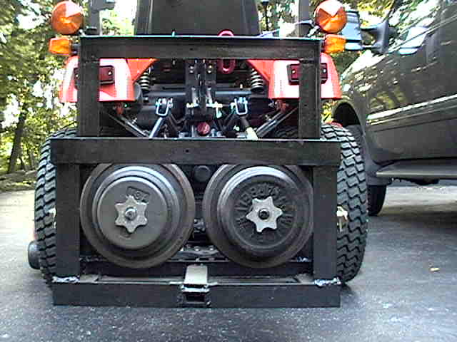

I don't use bar bell weights on the wheels, but I do use them on my weight box. You can usually get them pretty cheap at garage and estate sales.

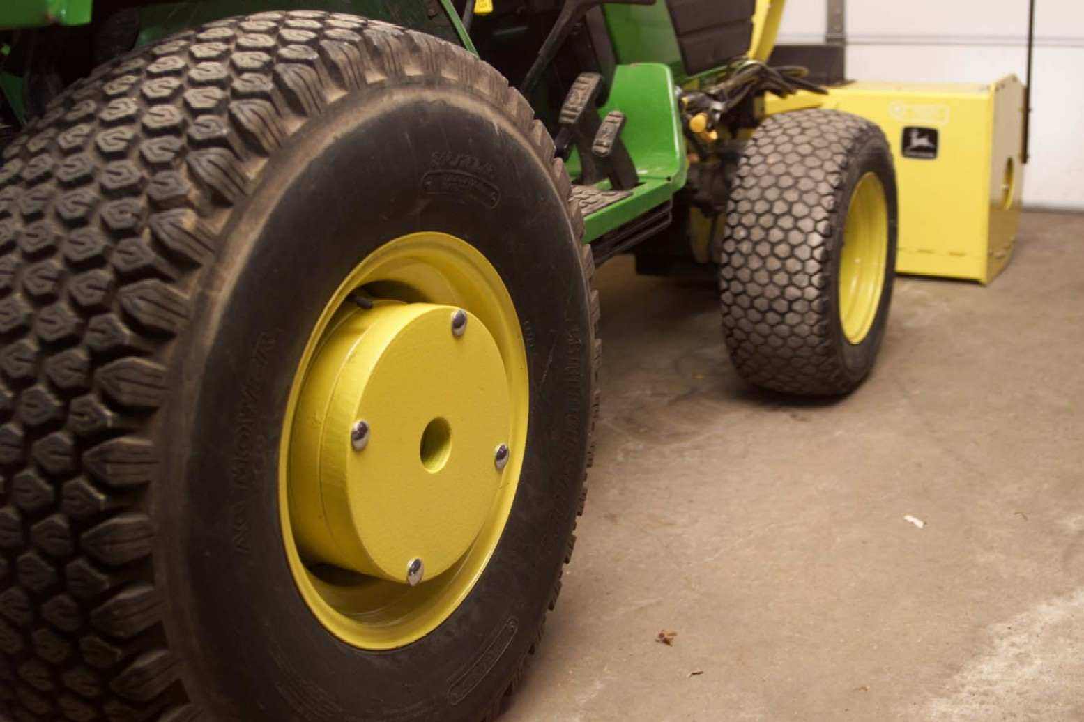

I used dumbell weights, but without the easy-weight bracket. I just drilled holes in them to match the factory weight holes already in the wheels, painted them yellow, and bolted them on.
This arrangement is not as easy to take on and off, but I just leave them on.
I only put 125 lbs per wheel on my little JD 4100.
I think the JD wheel weights are 60lb each and you can put up to 3 on each wheel.
- Rick
