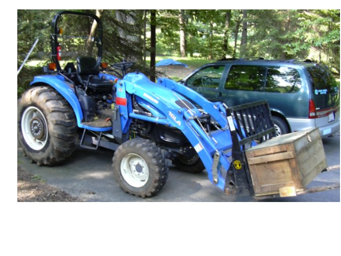

Yes - EZweights. They are great!
The brackets are about $36/pair and hold 1" plate weight. I bought my used weight for about 20 cents a pound from a Play it Again Sports store. 400lb = about $80 + brackets = about $85, incl tax and shipping. I have had them a year and have had absolutely zero problems with them.
They are simple to get off and on, since you only handle up to 50lbs at a time. During mowing season, they are off (along with the loader) when moving and on when using the loader. Takes less than 3 minutes. No rattles. Very stable. Highly recommended!
Picture attached.
Mark
