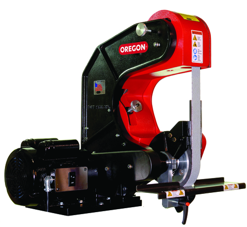

Anyone have an electric mower blade sharpening machine and if so, how do you like it? What kind do you have and are they worth the price of $400 to over $1,000? How often do you sharpen blades? Would you buy one again?

I use a small jig from a small business guy on eBay. Strap in my angle grinder with 40 grit flap wheel and all is good.

That is a dream grinder but too pricey for me. I'm looking at the Oregon 1/2 HP or even 1/3 HP model. Keeps me around $400. Any more is hard to justify but I do love the look of the lawn with a new Grasshopper blade. Best looking cut I've seen and not sure why. Maybe because they're so thick?
Option B is a hand held grinder or flap disc and new blades every other year. I would like to sharpen 5-6 times a summer and keep things balanced.
All I cut is grass. No sand, no rocks and I've outgrown accidentally mowing down errant shrubs. So just a dull edge with no nicks.
The big Oregon wheel grinder or my current Oregon/Burrking 760 belt grinder are outside the use of anybody other than a repair shop like myself or a golf course that does hundreds of blades a year. the smaller wheel grinder would be a good option for somebody that just does a few blades a year.
Cadillac of blade sharpening
