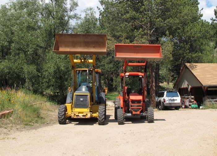

They are all good. We looked at the L39, L48, and M59. The M59 had just come out and that particular one was on special. so that one came with a lot of options at a special price. Ultimately it was my wife who put her foot down and declared that we were getting the M59. The reason for our M59 might not be what you think. One big reason was that the seat revolved into backhoe position with room for my 65 year old long legs and big feet to turn around easily. Another was the creeper function that works from backhoe position. The greater reach is something you do use a lot. The spec is for greater digging depth, but how often does one do that? You use the greater horizontal reach everyday. And then there was the loader lift ability. We had a need to lift the occasional three to four thousand lb load and have it stay stable on a slight slope - but most do not.
There is a power & stability advantage to larger machines of course. But they will always be there. And since you are looking at used machines, I'd also not ignore the L39. It has that 12x8 glideshift transmission which is a plus, and a good reputation. Somewhat smaller, but rugged. You might save enough to get the thumb. It's just big enough to be a decent size tool for 10 acres.
Just so you know, it wasn't the smaller size that bothered me about the L39, and I think that 39 hp is plenty. My problem was getting into backhoe positon on the tractor and also with it's shorter wheelbase it bounced my back around more when carrying a bucketload down a dirt road. One L39 owner put a hydraulic damper on the loader lift arms to stop the hobby-horse bouncing. It's an inexpensive modification - standard on full size TLBs - that would benefit all of Kubota's TLBs. It's not just Kubota, all TLB's bounce too much in my opinion. Hard not to bounce when you have big soft tires, a lot of weight on both ends, and are frankly trying to go too fast... Someday I'll put his mod onto the M59
rScotty

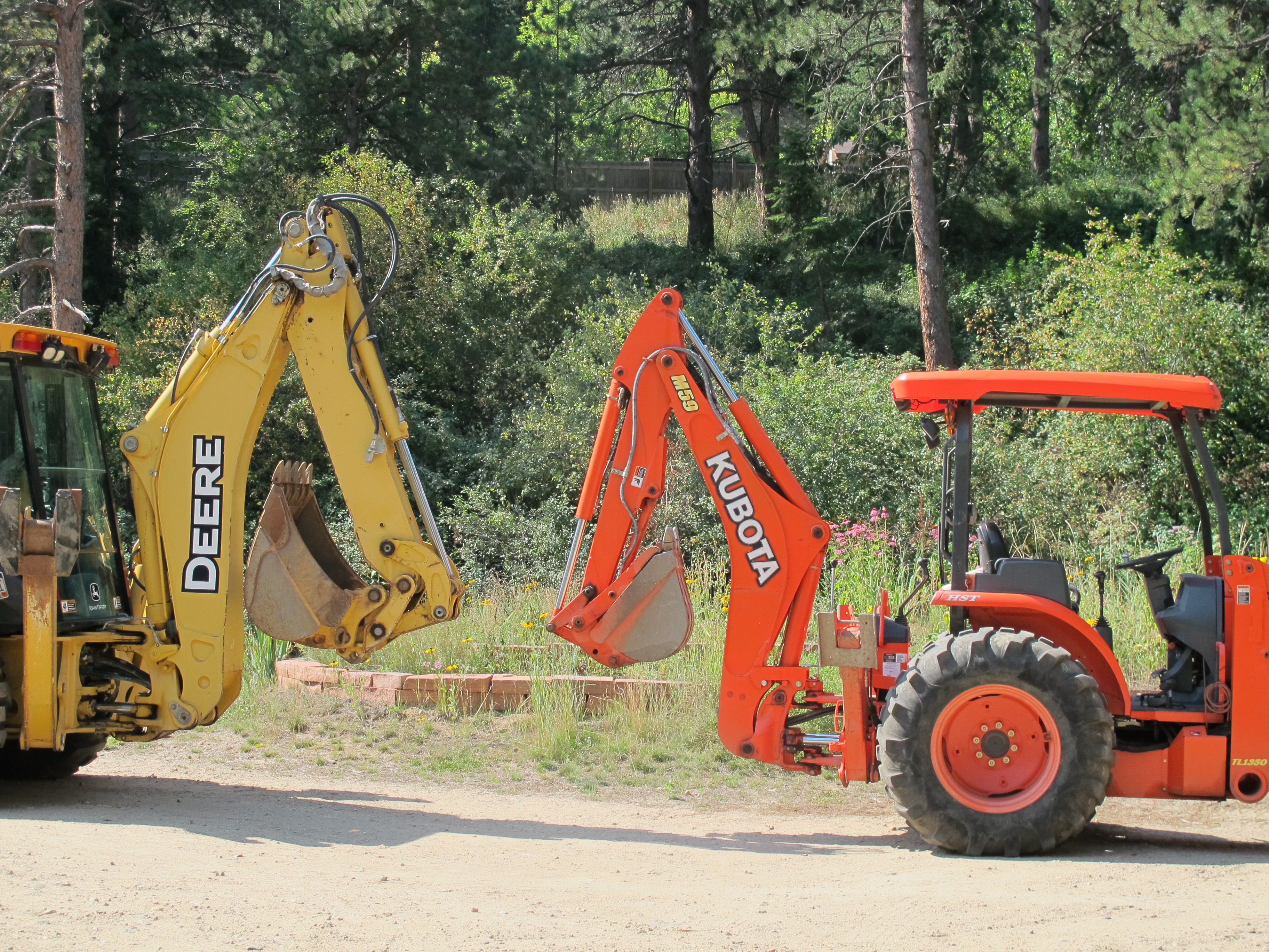

Well, before you get too excited....I was just thinking about the difference in weight for our different woods. Here we have pine, fir, and aspen - all destined to be firewood, and most under 18" in diameter. I normally cut logs into 12 foot lengths and then using thumb and BH bucket swing them parallel to the tractor to carry them home. There they are cut into two foot rounds and stacked to be split.
That technique works great for our firewood collection in the Colordo mountains., but I doubt it translates to big diameter hardwoods like your black walnut. Especially when you want them to remain as longer logs for lumber. I'm not even sure that the big JD310 would handle a two foot diameter 18 foot long black walnut log that way..... and it's a 15,000 lb tractor that dwarfs the M59. In fact, I'd probably just drag that log with a chain...
rScotty

My 310 would lift 5,000 pound concrete blocks with the boom. My M59 lifts a pretty respectable log with the boom but a 24’x18’ probably isn’t happening. The M59 stabilizers kinda suck that doesn’t help the lifting ability. Sawing 18’ lumber is pretty much non existent though.
