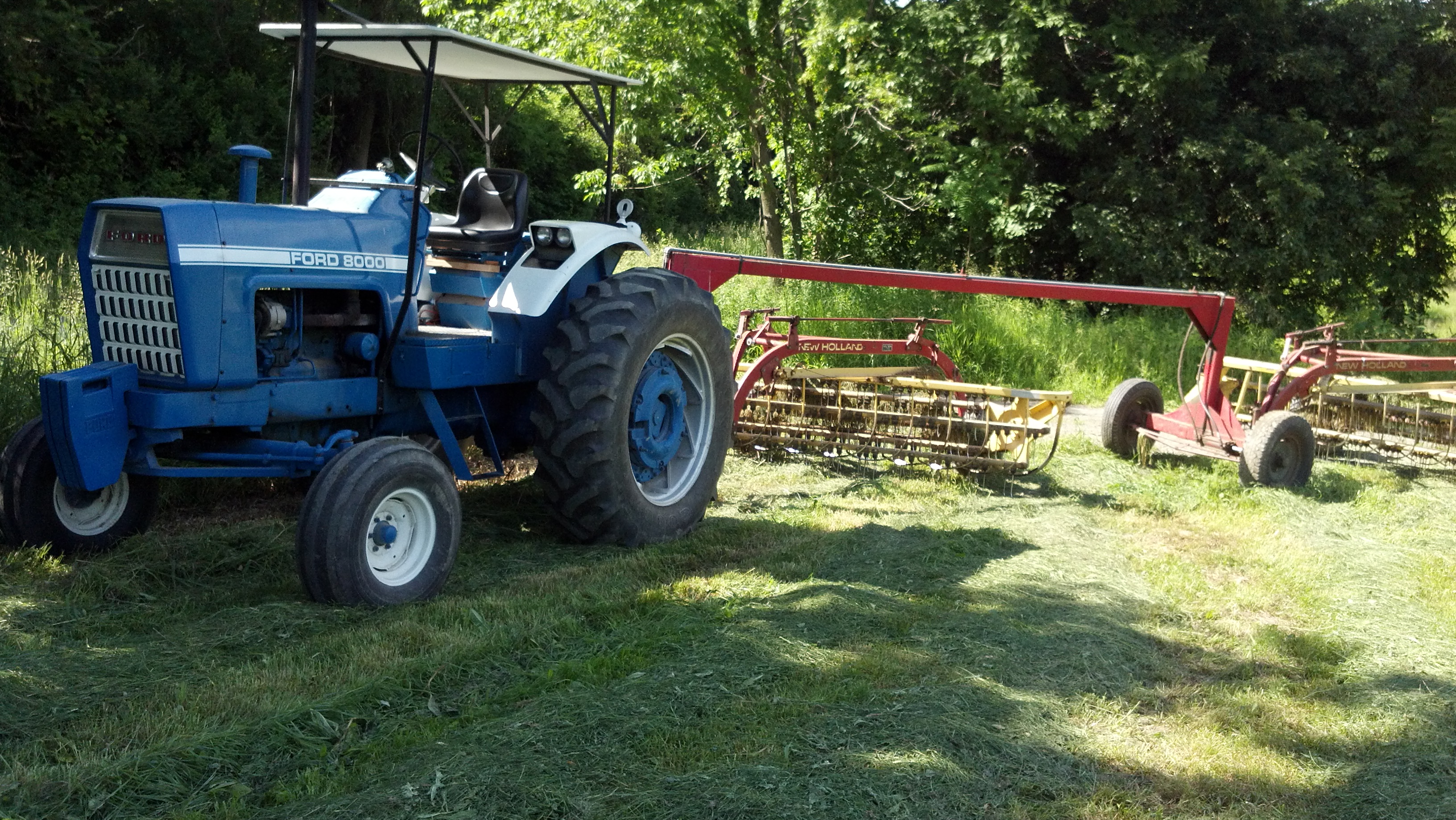

Depending on the yield of the field will decide how we will rake, normally we will double up the windrows.
Some times on a light field we will even put 3 or 4 into one.
This has several purposes, it makes the baling or chopping go much faster. It is a lot less trips up and down a field,
which results in less ground compaction and less fuel consumed as well as saving a lot of time.
For baleage or haylage the optimal moisture is supposedly between 40 to 60%, for balage we like it closer to the 60%.
For haylage we like 45-50%.
This got baled at 65% at the start then the weather got us we finished baling and hauling in the rain and one field was close to 70% to start with.
If the bales are well sealed with the wrap even the quite wet ones will cook up, they may be more of a sauerkraut then a nice smelling baleage.

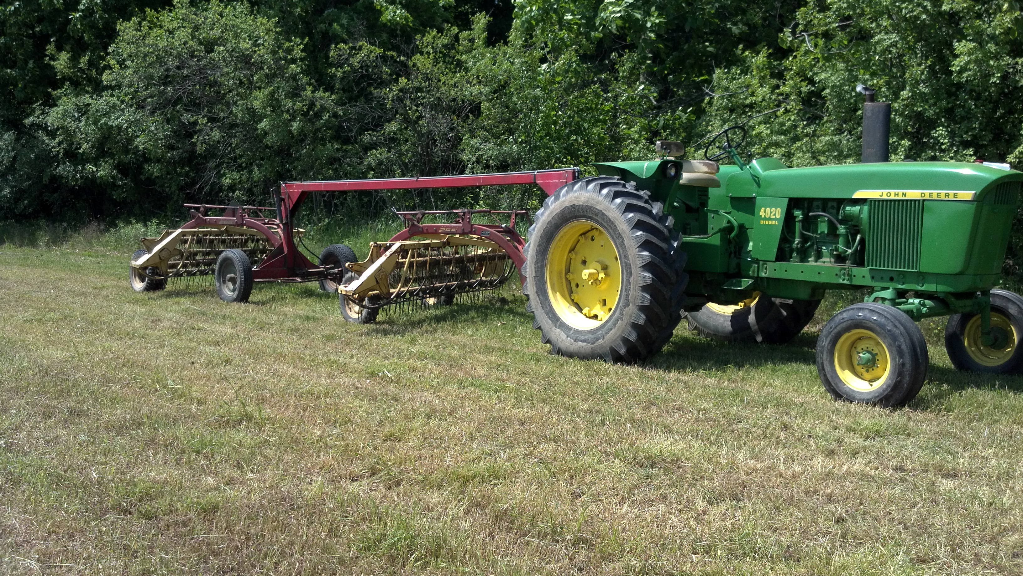

A couple of pics of the double rake setup, today we actually had one of the IH656's on the rakes.

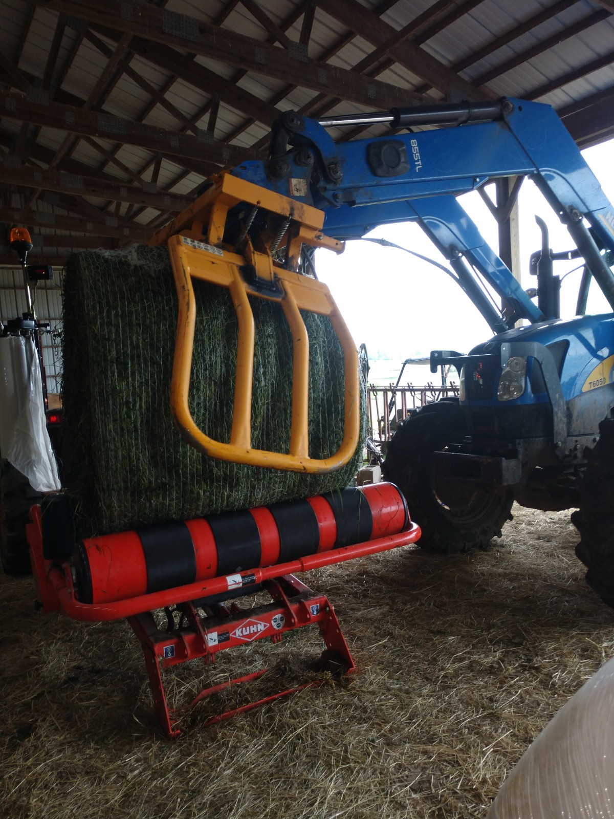

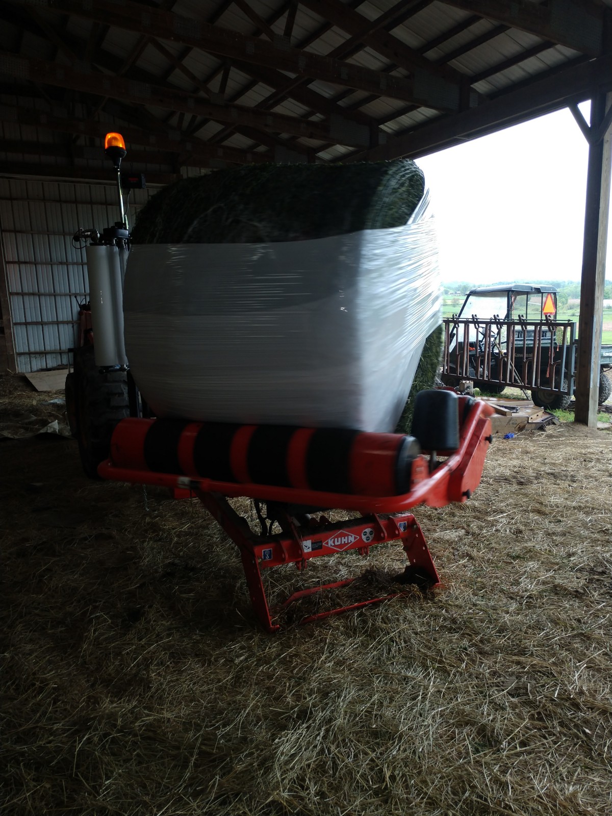

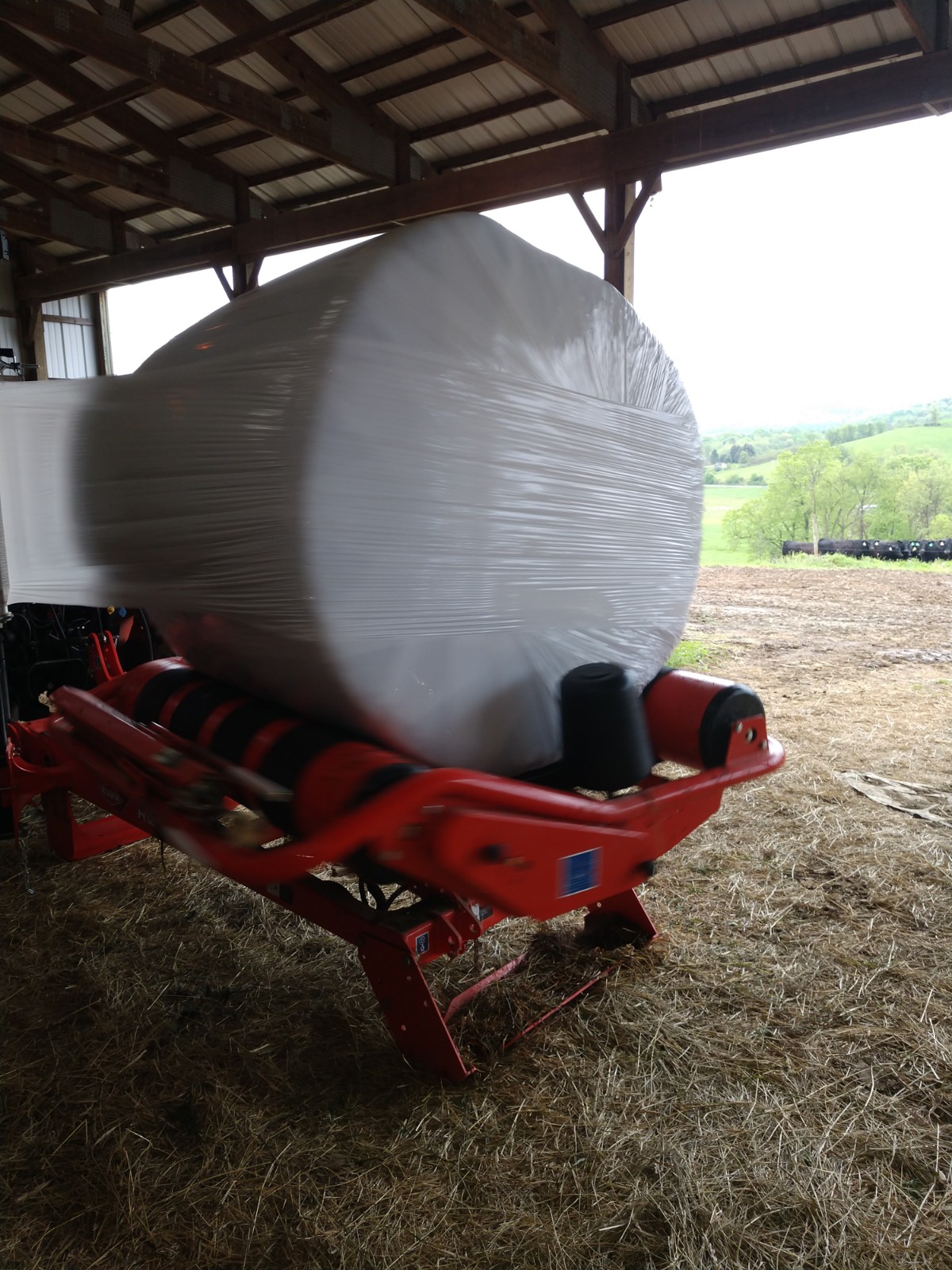

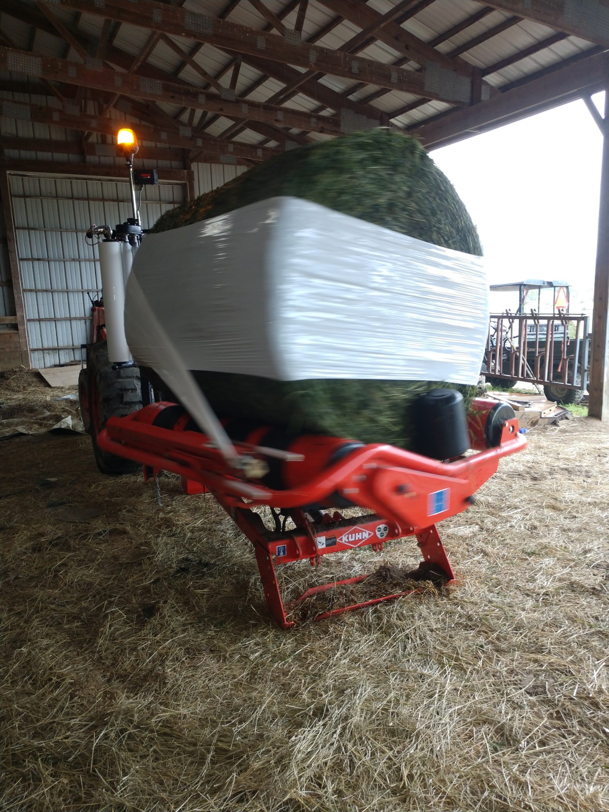

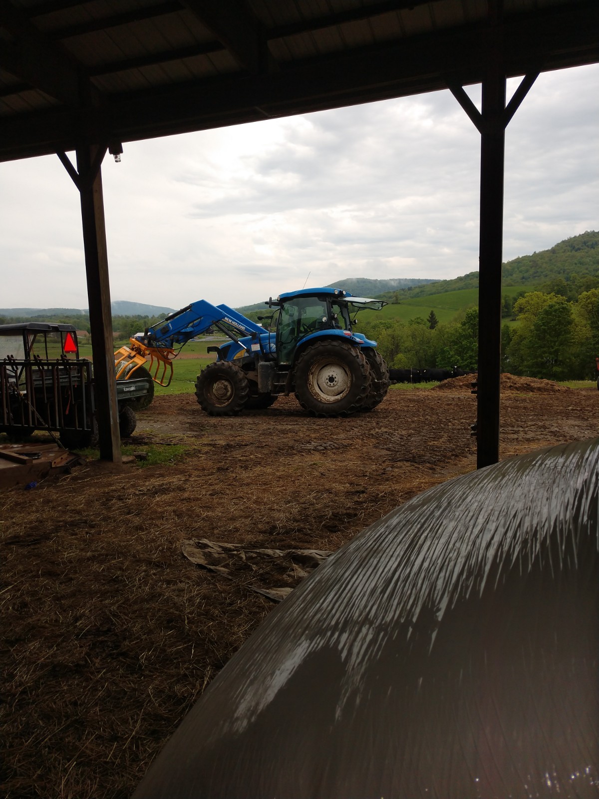

Then some pics of the wrapper operation, because of the rain we had to move the wrapper inside,
if the bale wrap gets wet while wrapping it will not cling to itself and seal the wrap which lets air get to it and causes it to rot not ensilage.
wraping 1.jpg wrapping 2.jpg wrapping 3.jpg wrapping 4.jpg wrapping 5.jpg wrapping 6.jpg
Our bale wagon will hold up to 10 bales, we bring a load in and dump them, then using the grapple pick one up and bring it to the wrapper, while it's wrapping take the one that was just finished and go set it in the yard, come back grab another and set it on the wrapper, when the wrapper completes wrapping a bale the final step is that it dumps the bale of the back of the wrapper.

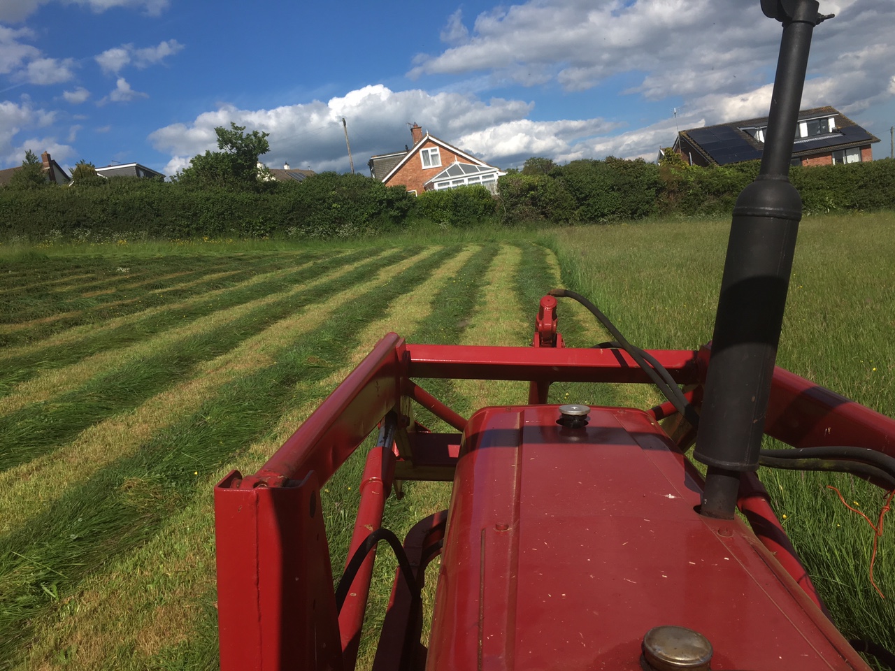

Back out mowing again. First field of hay!
   / Anyone Started Hay/Grass Silage 2019 Yet? #26
Very nice PROFarms,
Looks like I'll be cutting at the end of the month or thereabouts. We did freeze about a week ago. Looking at the field I think I came out OK, not much loss at all. Last year I lost about 1/2 the field due to freezing.

Looking at the rakes here I would say you could gain about 3 to 4 hours on your hay to go to a rotary rake. There are pluses and minuses as to the base designs for repairs if needed but they are a big plus here with rain and most farmers using them are mowing one day and baling the next for balage.

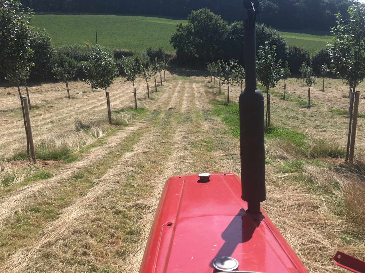

Back making some late season hay in a neighbours orchard. Not much here but full of good clover!
