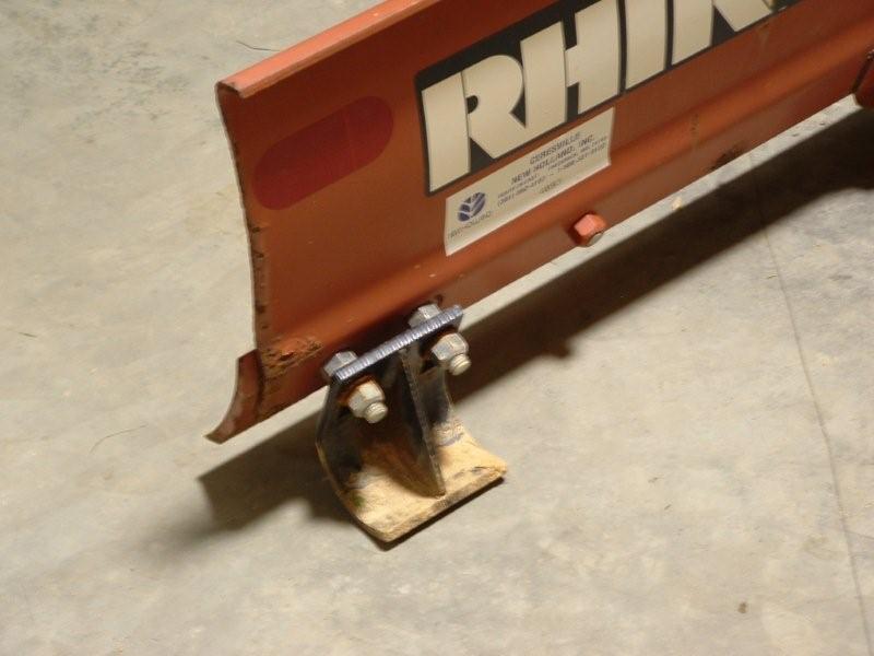

Here's a picture of the shoes on my Rhino blade. They help on my gravel driveway, but I always leave an inch or so of snow that likes to turn to ice after being driven on. Still it's better than taking off a layer of gravel by trying to plow a little closer.
