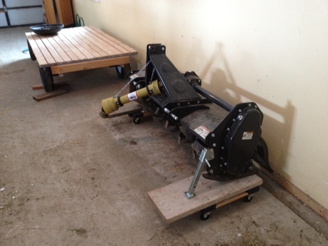

I have a CT235 and initially thought taking implements off the 3 pt would be a pain but it turns out easy so far. I bought a 15kW PTO generator off Harbor Freight and it was easy to hookup and works fine. I will not get the full 15kW from the CT235 but close. Below is a shot of my tiller on a couple of $10 dollies with boards screwed to them. I can wheel the tiller around the barn and it sits on them rock solid. It makes doing a one man equipment change out pretty easy. The rear PTO is the way to go with the generator and pretty easy to change implements.
Ditto above on having a licensed electrican put in a transfer switch for the generator. Don't kill a lineman with backfeed by just hooking directly into your house.
