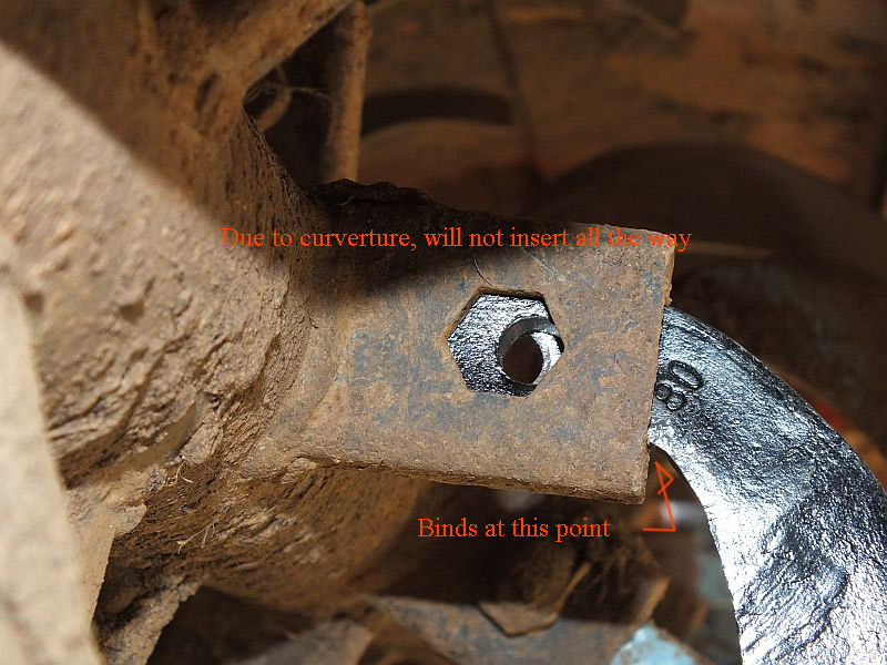

Just received my new set of tines and have started to replace them. Unfortunately, as received they don't fit. The profile on the attachment end is much different than the factory tines. Have about a third of the tines installed and had to grind on each and every one of them to make fit.
Before anyone asks, I'm not going to say who I bought these from as I have yet to contact them.
Looking at the pics it should be obvious what the problem is. Can't say for sure if my tiller is something "special" or the mfgr didn't follow the factory profile on the attachment end. Gonna take a fair amount of time to rework 32 tines to get them to fit. Hope the qlty of the steel and the temper is better than the profile.
Right now all I can say is, if you have plans to replace your tines, be prepared to modify them so they fit.
Paid ~$240 including transportation for the set and with the needed mod, it's going to take maybe 4 hrs to replace the old ones. :(

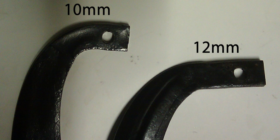

It looks like you need the 12mm version- not the 10mm version. Do you have a picture showing the two tine's bolt holes side by side? You can see the contour difference in the attached picture.

You are right about the profile looking like the 12mm part. I've rechecked to day and for sure my tiller needs 10mm fasteners. No way will the 12mm bolt work. Being an old ME, this isn't exactly rocket science so to speak.
Guess one could use the 12mm tines but keep the 10mm fasteners. Maybe I've stumbled on to something, a variation, others can benefit from from this discussion.

Think it is time to sum this thread up. It appear my tiller is "special" as I suggested in my initial post but not so special that it is the only one like this.
My tiller needs the tines with the profile found on the 12mm ones but uses 10mm hardware. I suggest before making a purchase of tines, look closer than just the bolt size. I see no reason why if you need the profile of the 12mm style but have 10mm hardware like I do, buy the 12mm style and just use the 10 hardware. Should cause no problems and is a lot easier than having to modify the 10mm style to make fit. I'm only half done and have put in more than 2 hrs getting those tines installed.

Oh, something else. Have started putting on the opposite formed tines and as I'm looking, I see more than one of the tines with the bolt hole not centered. These tines are almost too hard to drill using HSS bits. The easiest thing here I think is to grind the edge of the tang so there is more room, slop, for the tine to fit into the mount pockets and thus providing the needed clearance so the 10mm bolt will fit.
