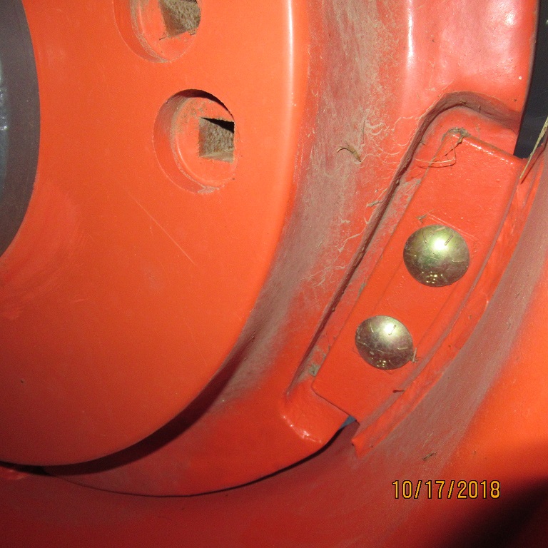

Has anyone done this? if the wheels are set to their narrowest position, the tire, wheel and cast center have to come off as a unit, and a heavy one at that. Has anyone taken their wheel with cast center off and if so, how difficult was it and how did you do it? Mine is an M7040 but others are the same.
Here's a pic of the wheel. Seems the cast center has to come off first or everything must come off as a unit.

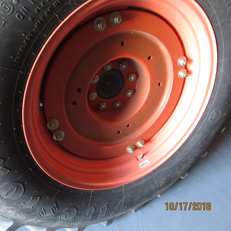

Here's an inside the wheel pic showing how the wheel and rim are mounted.

Depending on what you are trying to accomplish, normally I would unbolt the rim from the center, then securing the tire and rim to the tractor, unbolt the center and remove it.
It will be quite heavy. At that point the tire and rim can be walked or rolled or lifted mechanically.
For the first widening step then secure the center to the hub and the rim to the center,
if that's not wide enough the rim can be moved to the other side and attached to the other center.

I'm the OP and I spent a while today looking at the rim and center and have a thought. First of all, Kubota is smart enough to not box anyone in with a problem that is difficult to solve. With that in mind, I wonder if I could lift the tire slightly off the ground, unbolt the rim from the center and twist it enough so that I can get around one of the tabs that keeps the wheel on. Then I could wiggle the rim and tire off and leave the cast center bolted to the axle. I think it's possible.
For that answer I need to find someone that has done this or maybe a dealer that knows about it. If I can keep this thread alive maybe someone will check in.

When Kubotas are assembled and shipped they have the wheels set in for obvious reasons. Mine were like that when I bought it new.
On my 9540 it was possible to remove the tire/rim without removing the center. To get the width I wanted I had to swap sides.
When I did this my tires were not filled with fluid. It was still a struggle and I did it by myself. I've swapped several tires and find it easier to do by myself. With a helper you find yourself fighting each other.
Hopefully your setup is like mine. Appears to be the same center with maybe a narrower rim. My tires are 18.4x30. Not sure of rim width.
Good luck Six!!!
   / Anyone removed a Kuboata M rear tire and wheel that has a cast center? #10
Six - your tires are 16.9 x 32 - - right? If they are air filled - then I would give your idea a try. If they are fluid filled - I don't think I would try.
