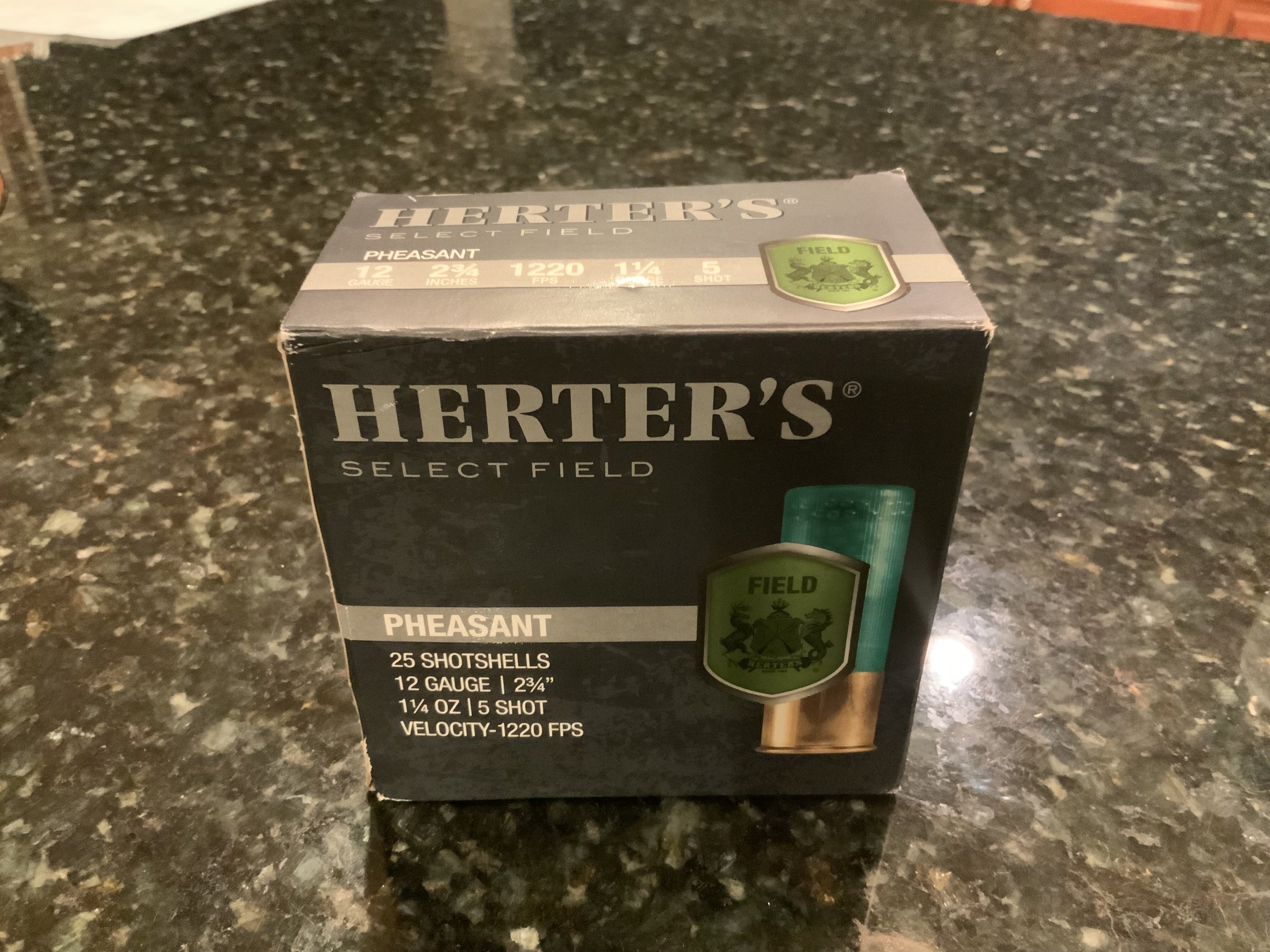

I'm curious. Why do your local Amish have 12ga ammo cheap? (Not obvious from a distance, given how little experience I have with Amish...)
All the best,
Peter
I get these from them for $6-$7 per box.
Italian.
