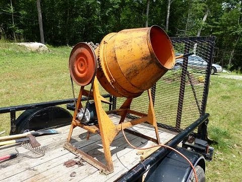

Although My mixer is not a Harbor Freight brand , it is a little bigger than their 3.5 c.f model , I replaced the motor on it with a H.F. motor , ( 1/2 HP General Purpose Electric Motor ) and it still works Great . Just ran 14 80# bags of the redi mix through it this morning . 2 bags at a time , some water first , then 1 bag , allowed to mix , 2nd bag , then add water to get the mix I wanted and dump in bucket of tractor . 3 batches to a tractor bucket , then out into the field and shoveled into a pump house to keep the ground squirrels from digging in .
Mine looks like this : hqdefault.jpg
Brother has the 3.5 c.f. H.F. model that he got in a trade with Our other brother . We have used it a couple of times and I like the way it works with the multiple positions it can be locked in . I don't think you would have any issue's by getting the same motor I used and bolting it on . RPM is almost the same , pulley would likely swap right over and guessing the bolt pattern is also close enough , since they are slotted on the mounting plate .
