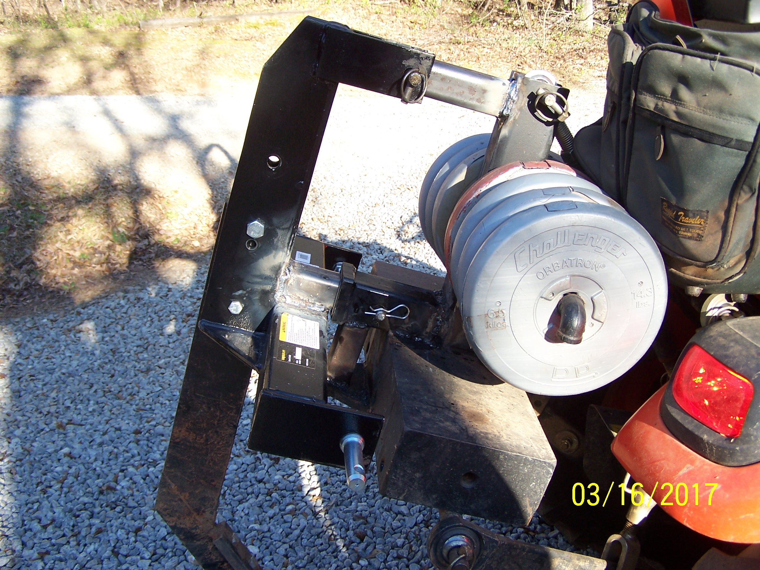

https://www.northerntool.com/shop/tools/product_200660637_200660637 I got this one for my CK2510H. I bought a sweep from agrisuply to use to put in gutter drain pipe.It is heavily built but looks cheap in the pic.It is adjustable for depth.Will need to put large nut behind top of sweep to get angle right.It should work even better on your tractor.
