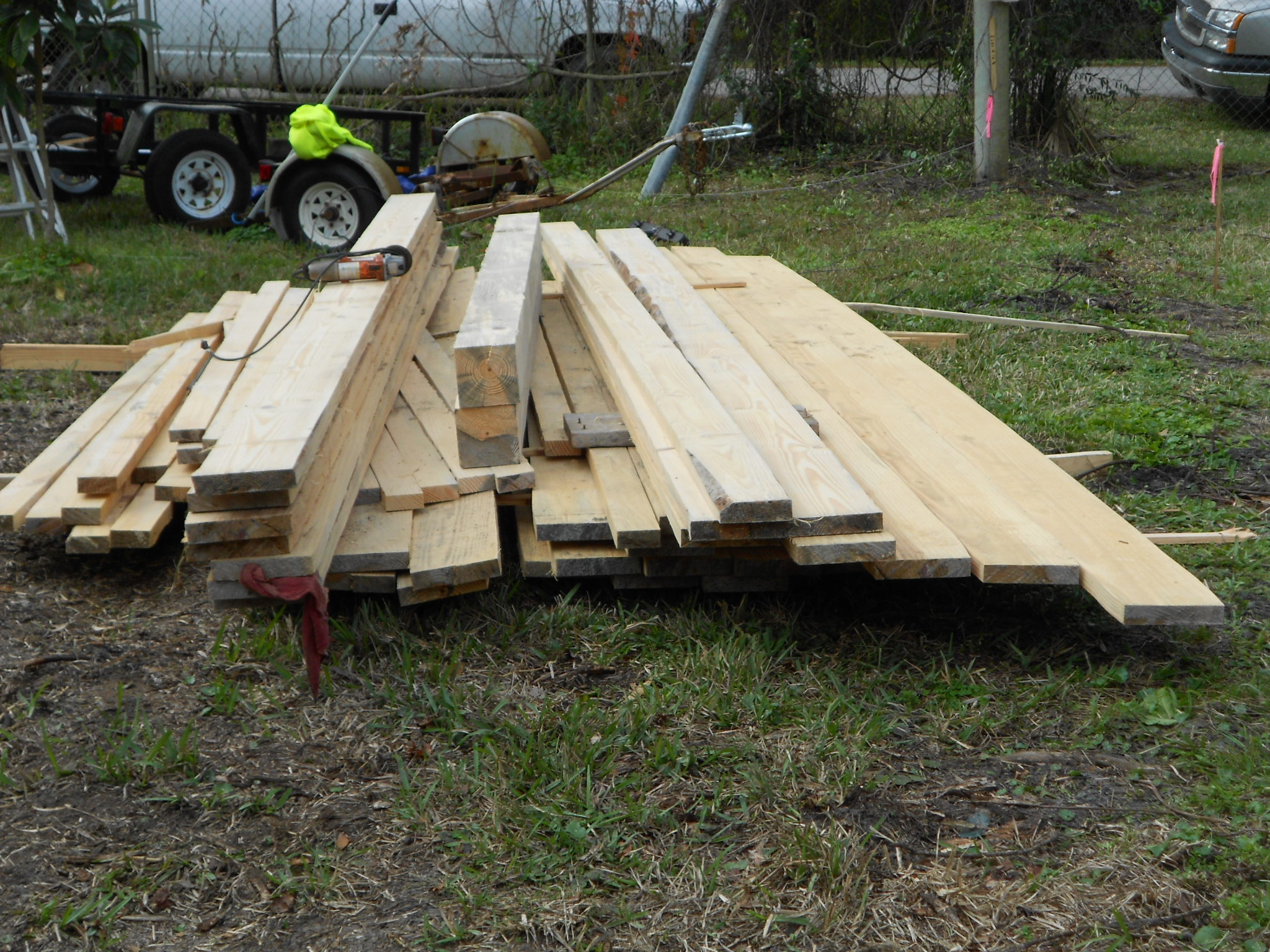

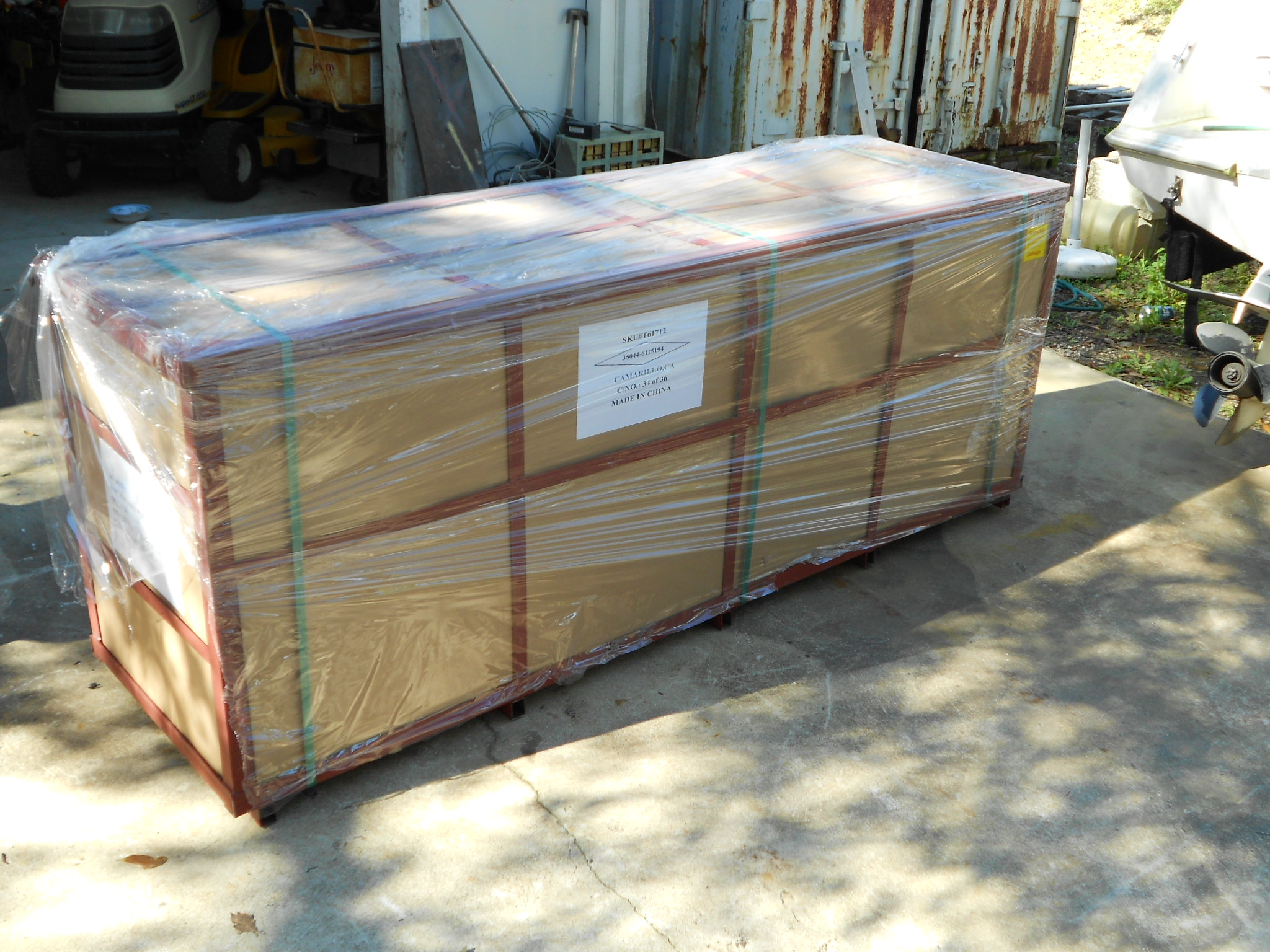

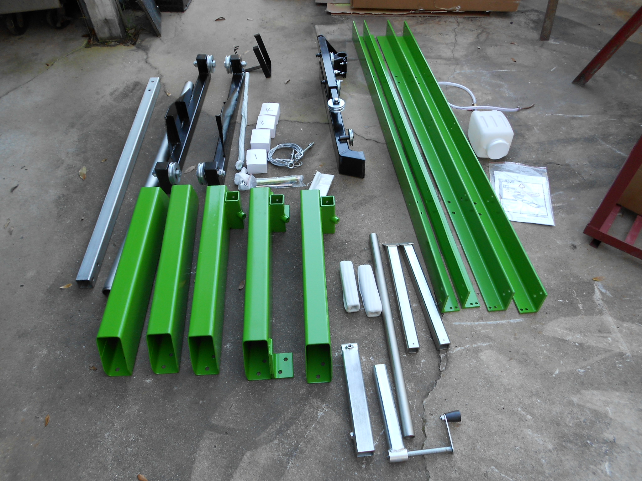

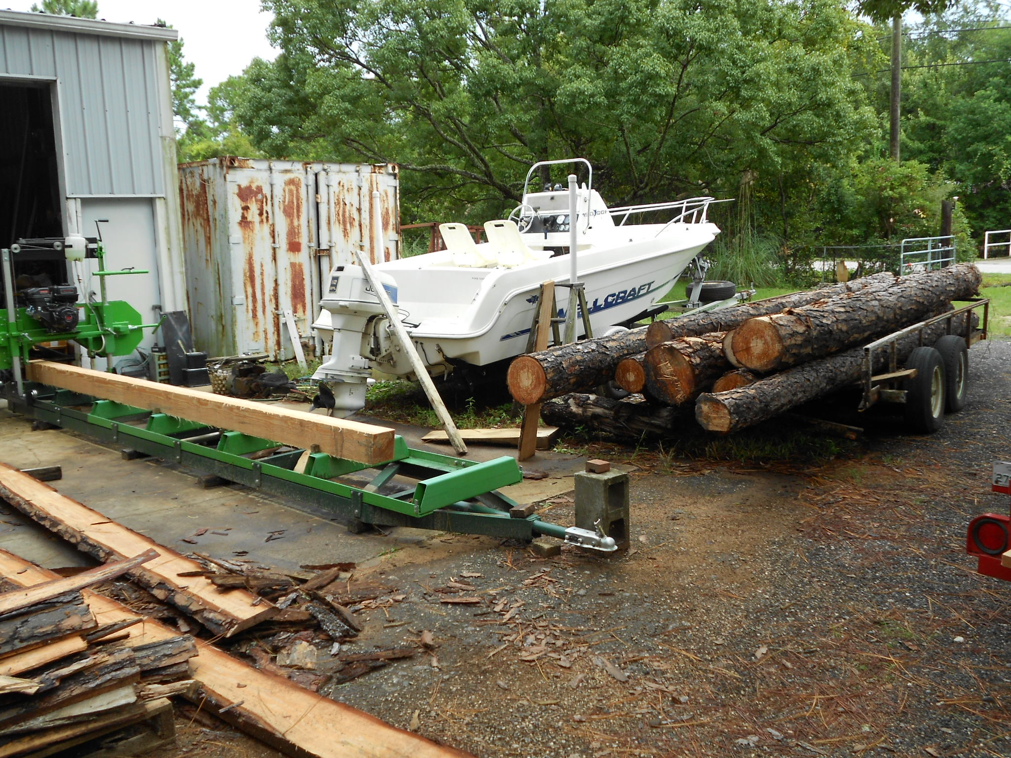

I bought the HF Mill about 8 years ago and made track extensions to cut a 16' board.
I had a lot of fun with it but wasn't using it and sold it last spring (in one day) for what I had in it!
I have owned a fabrication shop and you can't make a mill for what it costs from HF.
There is a learning curve but I got the hang of it after a while.
You need support equipment worth more than you will have in the mill.
