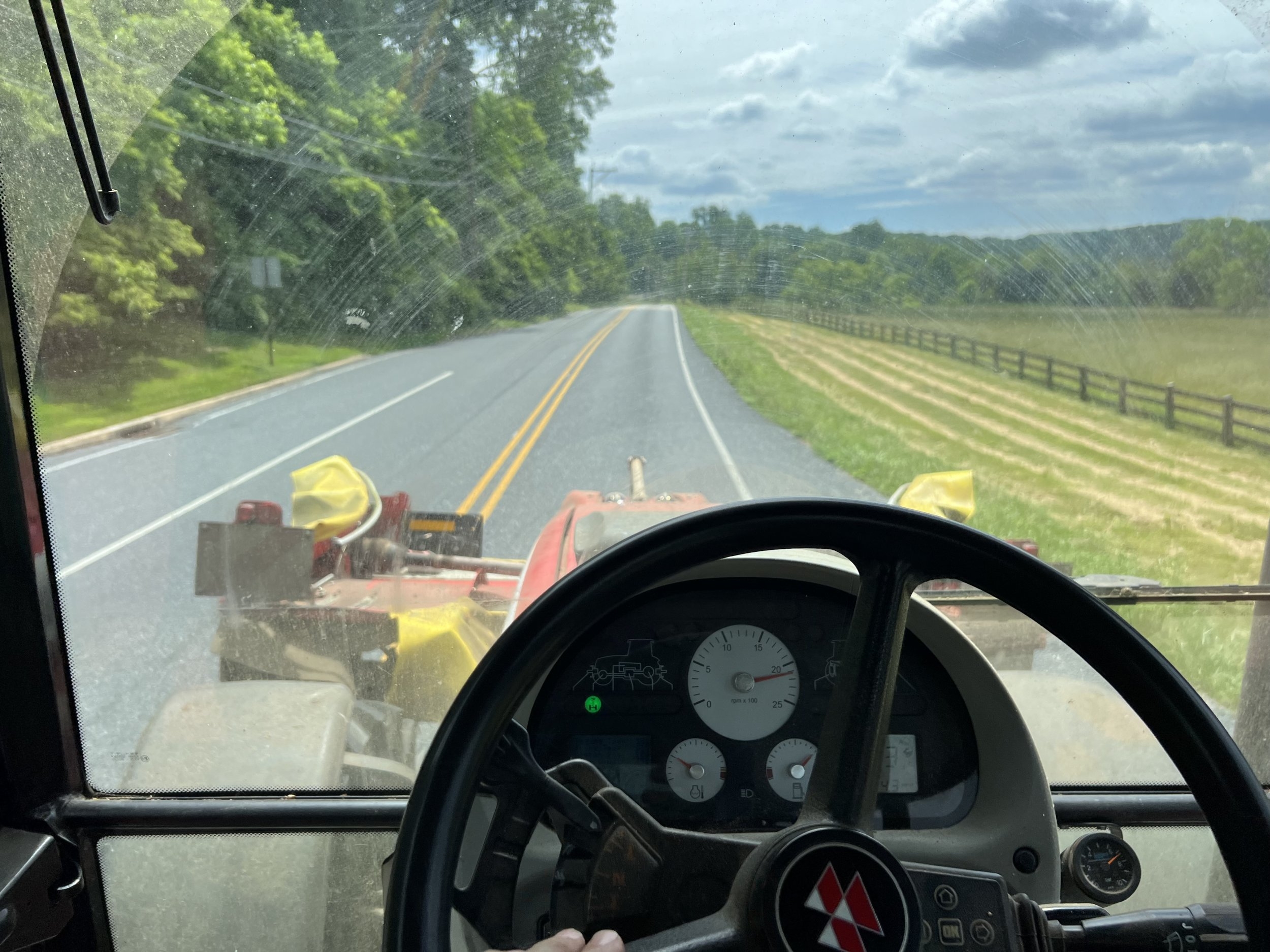

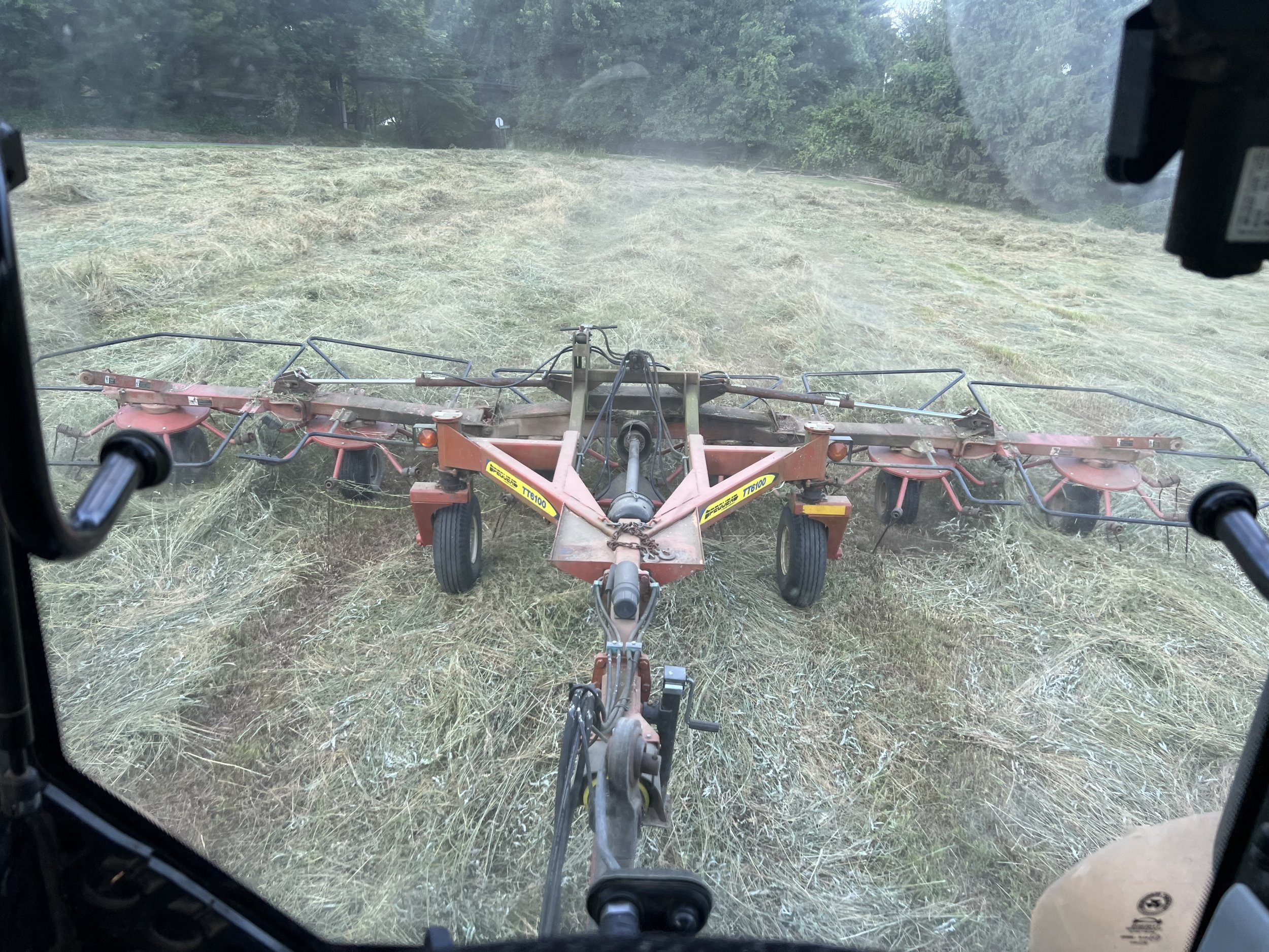

Got some mold dust coming up behind that tedder I see. Other than that looks good. I haven't pulled my tedder out of the barn in a couple years now. I just use the wide thin spread kit on my NH discbine. Fits on the deflector plate with wing nuts and carries in the tool box. I open the side deflectors all the way up and run it. Why do I assume you have the same ignorant motorists here that we have here?
Mold dust? 😂 WTF are you talking about? I just cut that hay the day before I teddered it. :ROFLMAO:
/ Anyone mow hay yet? #62
If you look at the picture you can see the 'fog' coming up off the tedded crop, least I can. Take a look....

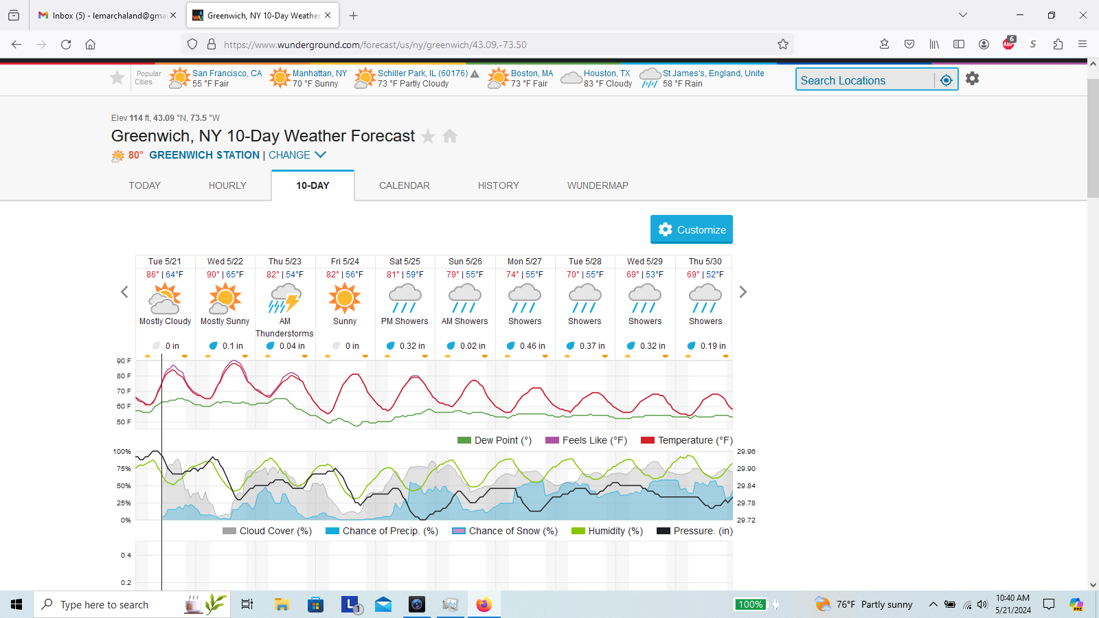

Did it rain there last night (or did you get what we got in the early afternoon)? Was headed your way...
After Saturday here, looks like we have 10 days of no rain so I'll be mowing. Besides, my customer is out of forage. Sunday.

I would expect it to be pollen, this time of year.
That’s exactly what it is, and probably a dirty rear cab window, too but you know how some people are…..

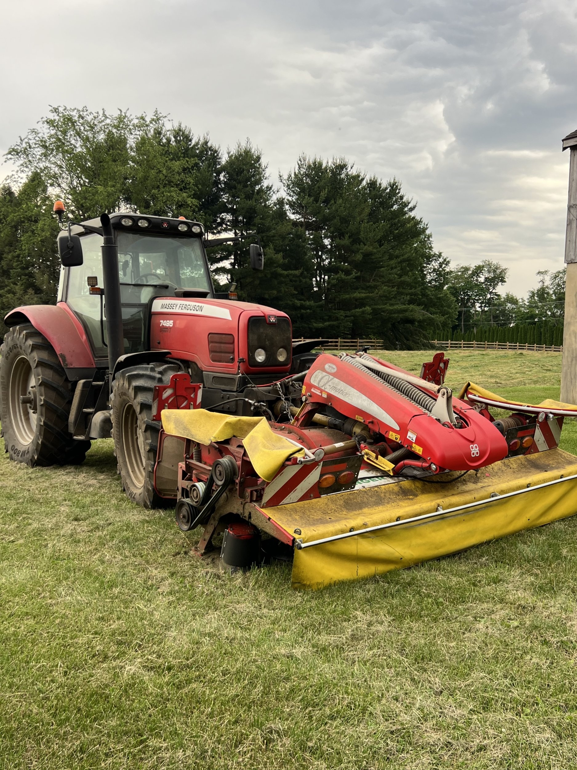

Anyway, back to mowing hay. Got the Massey repaired and got back out to mowing
Got about 6 hours of mowing done, then walked 3 miles back to my truck.

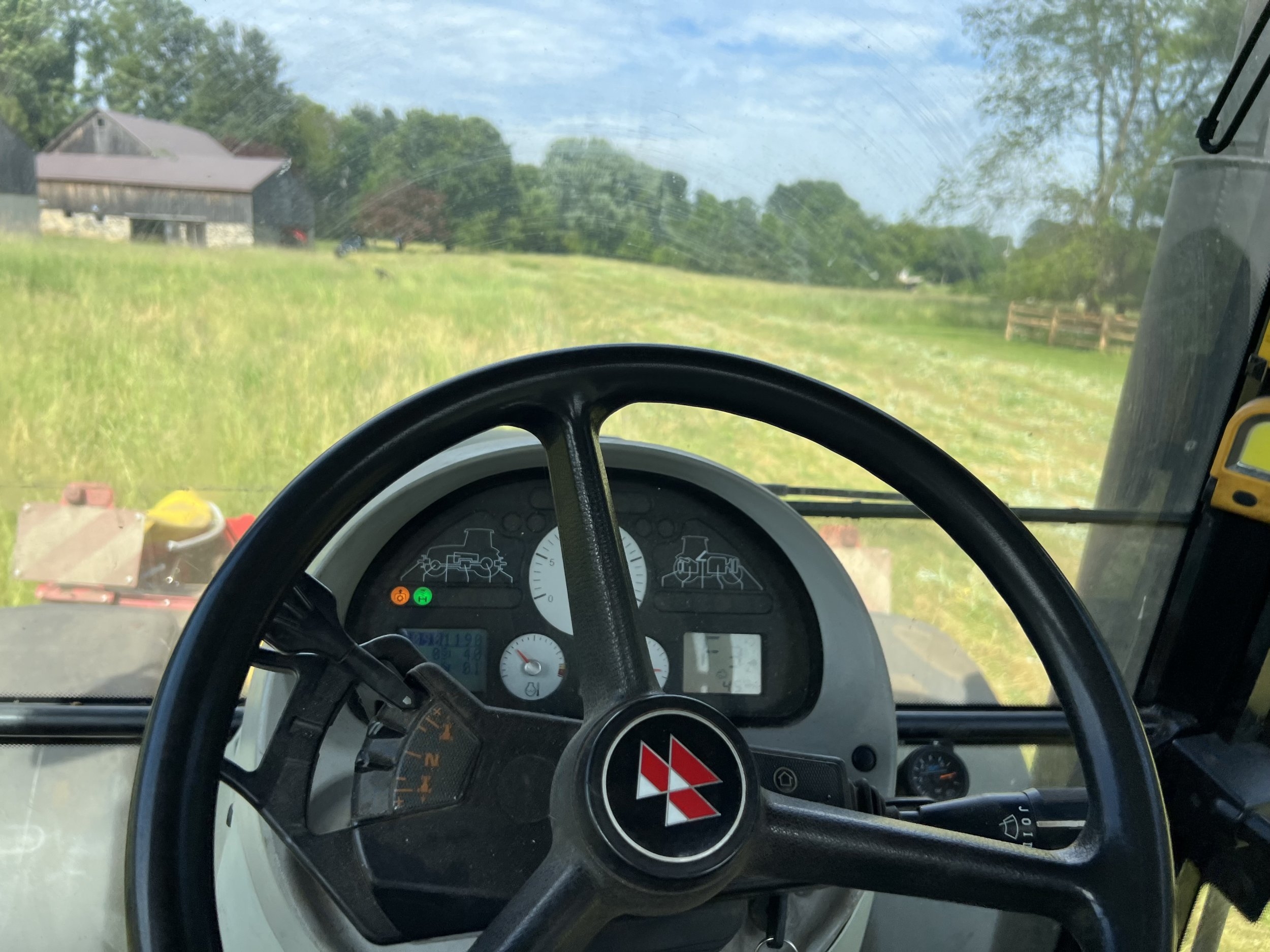

I love walking the fields with my day pack. Love the swallows flying around. These fields have been farmed since before the American Revolution. At the top of the hill in the picture above, townspeople from my area watched the Battle of the Brandywine in the valley below.
I cut a walking trail home. Looks like it needs mowing again. My work is never done.

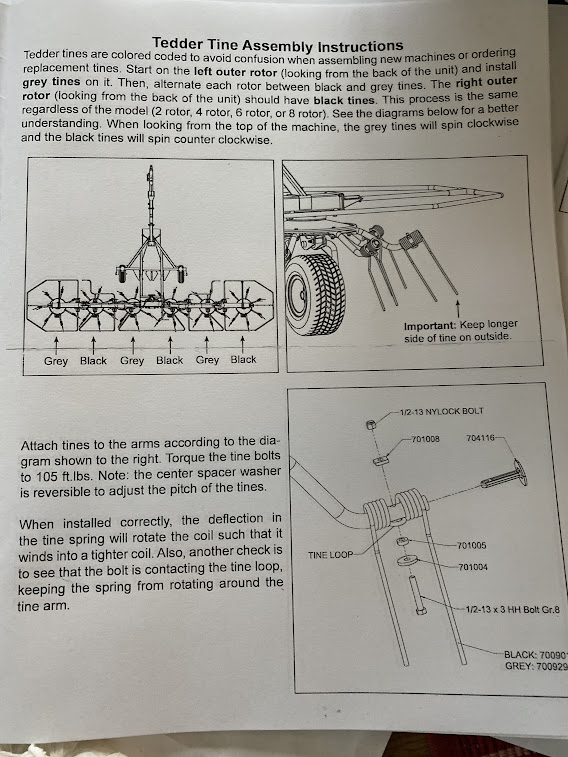

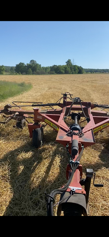

After my issues with the Pequea tedder I was looking at your picture and on the 2nd rotor from left as you travel it appears that tooth in front of tire is not correct and your spread pattern very much mimics mine making me thing they are in correctly installed. Picture of heavy straw this year with my tedder finally working correctly and the instructions that I found when demoing their newest model last year. As far as mold looks like dust/pollen. Same as what was rising out of our fields last week.

After my issues with the Pequea tedder I was looking at your picture and on the 2nd rotor from left as you travel it appears that tooth in front of tire is not correct and your spread pattern very much mimics mine making me thing they are in correctly installed. Picture of heavy straw this year with my tedder finally working correctly and the instructions that I found when demoing their newest model last year. As far as mold looks like dust/pollen. Same as what was rising out of our fields last week.View attachment 874447View attachment 874448View attachment 874449
Thanks I will check that out. I thought I had all the longer tines installed to the outside and the correct colors on each arm.
