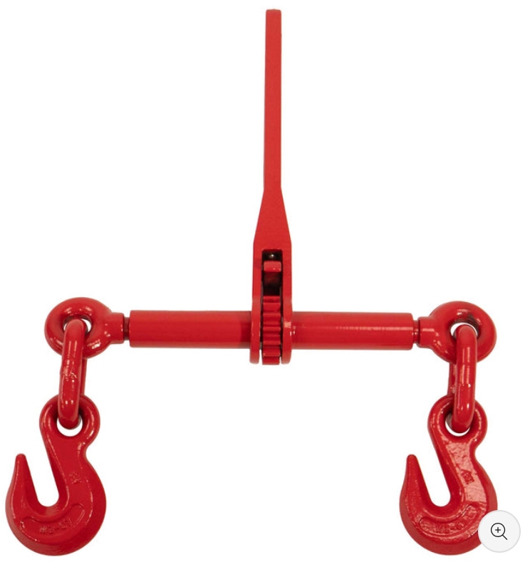

Like a load binder with spherical bearings at both ends?

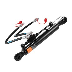

Converted mine over to hydraulic. Best thing I did for my tractor!

I’ll have to look into the chain binder to see if I can find one with a close enough length as the existing top link. Also the thread size for my ball joints.
My Massey Ferguson does not have a power beyond port for the hydraulics.

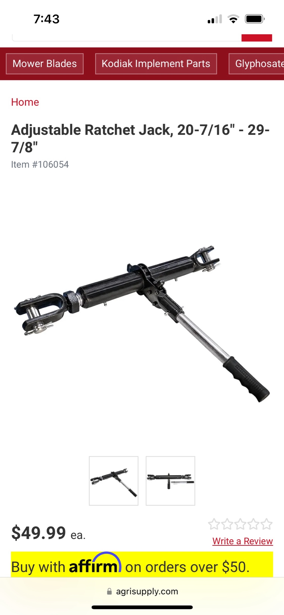

I also found this but I couldn’t find one with the more standard ball joint ends.

I’ve looked at this one and I’m still keeping it as a possibility. I could cut off the ends and weld my ball joints on. I’m a little reluctant to cut anything, that’s why I’m looking for other options.
It can be done but i would cost about $350.... Looked into it, then walked away....Decided I didn't need it...
