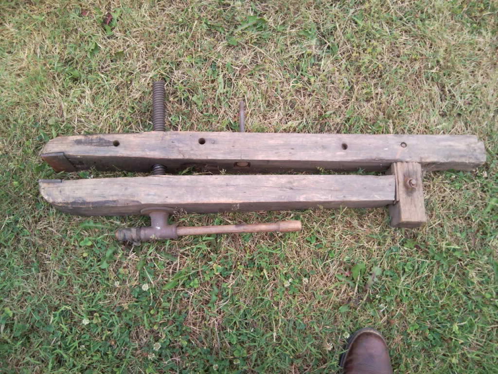

The Post Vise we had where I lived growing up was made of wood - I didn't know myself that there were metal ones until I googled them for this thread! Here's a photo of a wooden one (from the web).

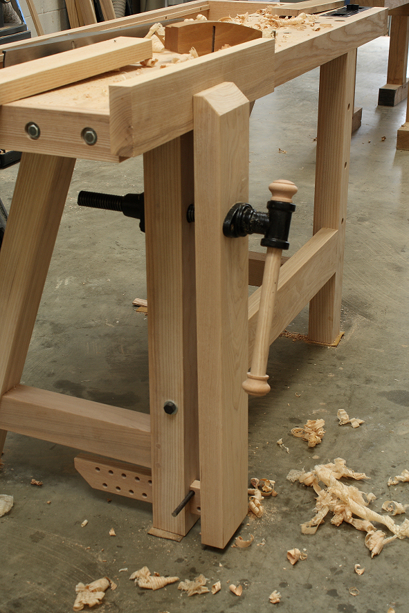

There are blacksmith's post vises also called leg vises Blacksmith Vises : Solid Box, Post or Leg Vise (Vice)
and woodworkers post vises in what seem like endless variations https://www.theenglishwoodworker.com/wp-content/uploads/2012/08/humble-leg-vice.jpg
When I was around thirteen, I saw a plan for a wood workers vise and wanted one. I got hold of the screw and nut from an old scissor jack, pinned a tee pipe fitting to one end and ran a huge bolt probably 18" long through for a handle. The part at the bottom was adjustable with holes for a pin to go through, the rest, except for nails, was made of wood. It was a rough, crude version of the one pictured. That thing worked great! It's a shame all of my projects haven't worked out as well.

Yes! That's it! Locally it was called a Post Vise because it was mounted to a post. The workbench top was made of heavy planks and sat on posts sunk into the hard dirt floor.
The one pictured in the link (below) is beautiful. Ours was butt-ugly, but it did have a pivot pin that allowed some angular movement between the main vertical jaw and the adjustable bottom piece with the holes in it. That simple change made it much more versatile.

The one my dad had was exactly like the one in rScotty's picture. Except - there was no "built in" lower leg adjustment on his. If you wanted the leg out - just put chunks of wood down there until it was right.
