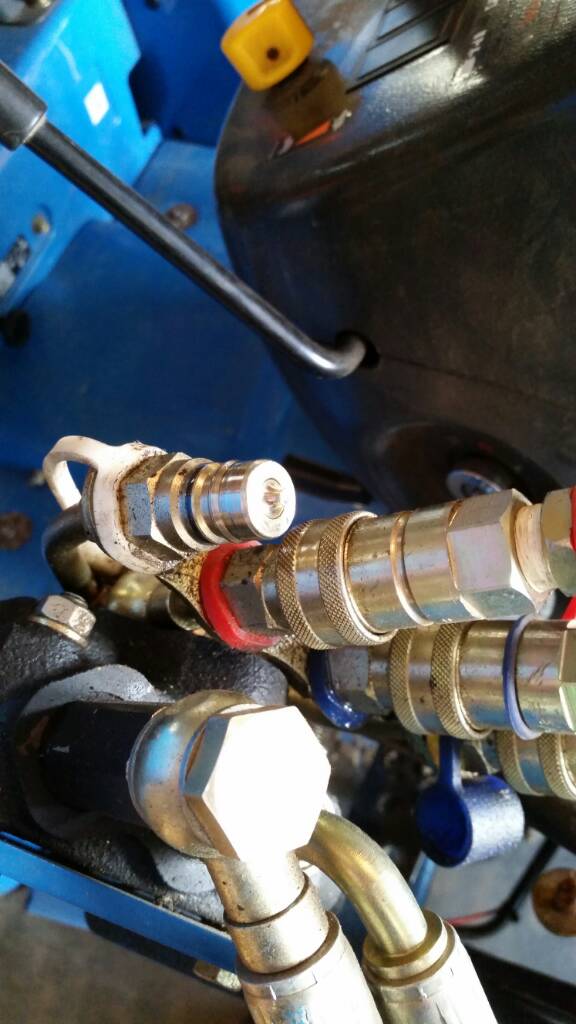

Loader Anyone know where to find this Coupler?

No. I'm still hunting for the original information I was looking for. I'm trying to figure out what this coupler is so I don't have to buy OEM. I think it's an ISO 7241-1 Series A 3/8" coupler.

Thank you. I found that web site a few days ago. They have quite a selection of couplers for much better prices than OEM. The only problem I'm still running into is that I can't tell what these couplers actually are.
I even went into TSC and showed them the pictures and they couldn't tell. Maybe I'm going to have to just order a few different ones until I find a match. Ugh. Lol

Can we get a picture of the male side?
The ISO 7241-1 Series A is a common fitting, but its hard to tell what it is from a few off angle pictures of the female side and the OEM part numbers.

Take one of the connectors off and take it to a local hydraulic shop for identification. Pictures won't work as well as the real thing.

I think I have one.
You can kind of see it. I know it's not a great picture of the male end. I'll try to take a better picture tomorrow. We got ridiculously snowed in today so I'm not going to go back out there until tomorrow.

My 3039 uses 1/2" Pioneer couplers ----- I suspect that's what you have.

Discount Hydraulic Hose has a quick disconnect size chart you can download and print it, then you can compare your male fitting to find a match. For what it's worth that is how I found the correct fittings for my Kioti, which are ISO 7241-1 Series A!
   / Anyone know where to find this Coupler? #20
99.9% sure they are:
3/8"
ISO 7241
"A" Type
I've sold gauge sets to customers with LS tractors that need this type. I have a couple in stock (I think anyway) and can drop ship some to you in quantities.
