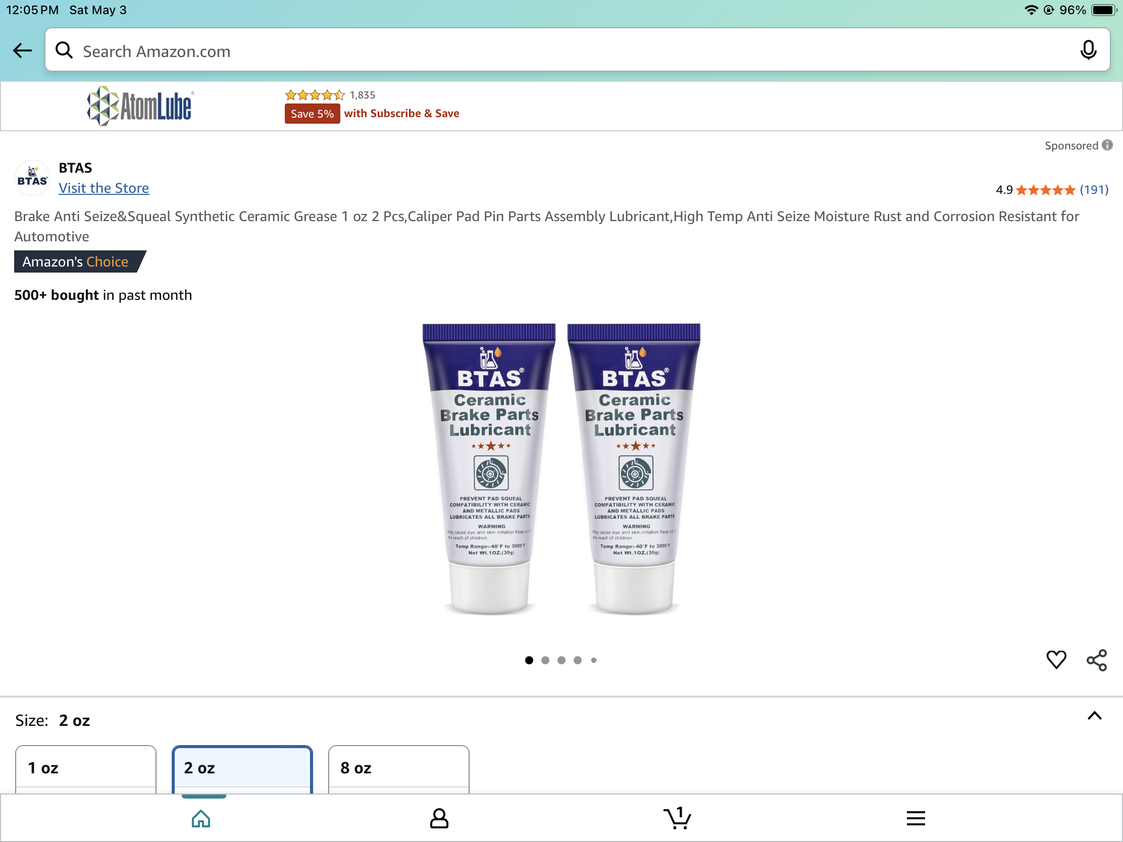

Never heard of ceramic paste. Ill look that up. Thank you. I have to wait to tackle this project until after i get done logging the back of my property. Probably will take a month to get to it.

By ceramic paste, do you mean something like this

DO NOT use anti-seize on GP threads! Use ceramic paste on the body portion between the threads and the tip as it is here that carbons up and causes GPs to stick. Putting anti-seize on the threads results in distorted torque values: someone unfamiliar with this can end up stripping things and then you're up that creek w/o a paddle.
Deep Creep penetrating fluid (or an acetone+ATF home brew) applied before removing and after bringing the engine up to temp is the best approach to removing GPs. If a GP is really tough I will first look to apply tightening torque to help break things free BUT one might want to use a torque wrench and make sure to keep it under about 25Nm. Do NOT force things as that'll lead to a broken GP: I have a fairly rare engine that some idiot trashed the head on trying to remove a broken GP [they almost certainly broke themselves]. I NEVER have an issue with GPs that I install (because I use ceramic paste). I have a fair amount of experience given many years with diesel cars, trucks, generators and tractors.
Do i have to adjust torque values if I use ceramic paste?

Sorry for the late response here... NO because you do NOT put the paste on the threads. Again, GPs main sticking area lies between the threads and the glow part/tip; this area sees lots of carbon and doesn't really get cleaned up via combustion as do the tips.
