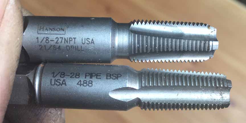

1/8 - 28 BSP looks similar to 1/8-27 NPT (USA) but BSP has slightly smaller hole.
A 1/8-27 NPT catches about 1/2 thread in a BSP hole.
attachment.php
Notice the tip of the BSP thread is smaller and the taper is steeper than NPT.
There are tapered thread fittings, straight thread fittings.
I just wanna service my machine, why are there so many different threads for grease fittings?:confused3:

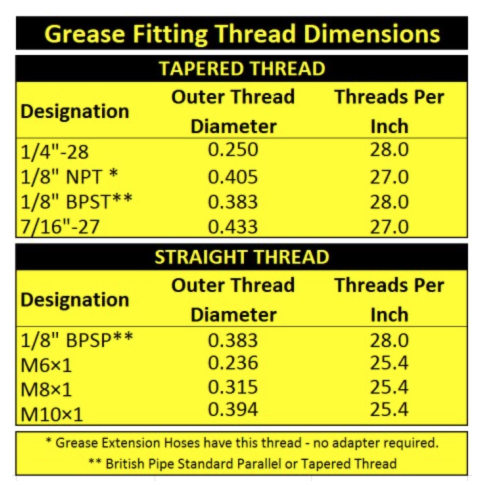

Sure could be. There is such a thing as a metric tapered pipe thread spec, but almost nobody in the world uses it. Most metric manufacturers use the British Standard Tapered Thread in applications where you want the fluid sealing ability you get with a tapered thread.
Some British Standard specs are very close to the USA tapered thread specs, but not the same.
And they might not be tapered threads at all. Lots of zerks use a straight thread. And it can be hard to tell the difference.
Plus the zerk fitting hole itself often doesn't go very deep or have very good threads.
Our Kubota M59 TLB came new with both types of tapered zerks as well as metric and USA straight threaded zerk. It also had several angle styles that had to be replaced right from the start so that a standard grease gun would fit them.
Here's a nice chart I found online at GreaseExtensionHoses.com.
