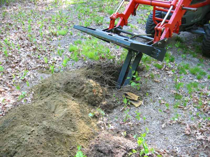

If you have a sturdy set of forks then consider the Quick Spade. It costs About $150 from Northern Tools. I have one and it works fine for digging holes up to about 4ft deep. It has an advantage over a BH when digging up plants because you can dig under them from the front and it is easy to manuver the tractor around as you dig.
They also make a version that fits just to the FEL bucket but that one can only dig about 18 inches deep.

I bought a Quick Spade based on Island Tractor's review (thanks). I had a couple of concerns - would it fit my cheap forks and would it work with a tooth bar - yes to both. It doesn't slide on to my forks for enough to be as secure as I want but it still works great. I'd buy it again in a heartbeat. Works great for popping stumps out and also good for pickin' the dirt out of the root balls so that I can burn them.

That's a pretty impressive stump to have dug out with the quick spade. I haven't tried anything that big myself (I have a BH that I bring out for that size project). Nice to know the Quick Spade was up to the task.

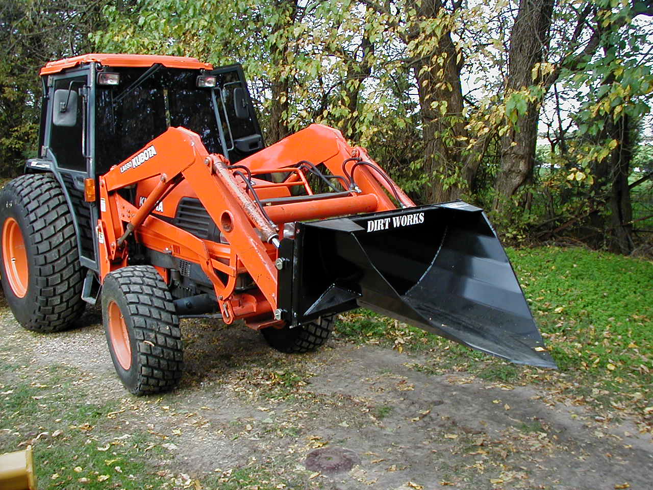

I have WR Long's tree spade. It really works great...
   / anyone know of a tree spade for FEL? #10
This works SOOOooo good... KennyV
That is pretty cool. I have seen that brand for the skidsteers but didn't know they made a tractor version.
Do you have a QA set-up (I don't) or is that made to fit your pin configuration?
