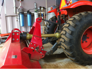

Thanks IT, now that I ordered the HTL, I'll be more motivated to install my remotes.
As for using the slot, perhaps I didn't have something adjusted properly, but it seemed the mower had a tendency to want to tip forward (toward driver). Any suggestions?
Couple of things to consider. First is that tipping forward is controlled largely by the position of the sidelinks. If those are set to a height where the mower is roughly parallel to the ground then it shouldn't tip forward. Second is to be sure you have the toplink mount, the two big triangular slabs, mounted so the toplink slot is parallel to the ground. On the Caroni it is possible to assemble it backwards so the slot points down towards the front. Don't embarrass me by asking how I know that. The toplink is then set so it is in the middle of the slot when on flat ground at rest. Third point is to check the roller height. If that is set too high for the cut height you'll find you are shortening the toplink too much (opposite is also true).
Basically, if the mower is set up properly and the side and toplink adjusted correctly the toplink will move around in the slot but the mower should not tilt forwards. If everything is basically set up right I'd play with sidelink height by raising it until the tipping forward stops.
You'll find the hydraulic topping lift great for adjusting position in the slot too.

Having the 3PT sidelinks all the way down will tilt the mower towards you. Try using the sidelinks a bit higher and lowering the roller if you want a closer cut.
