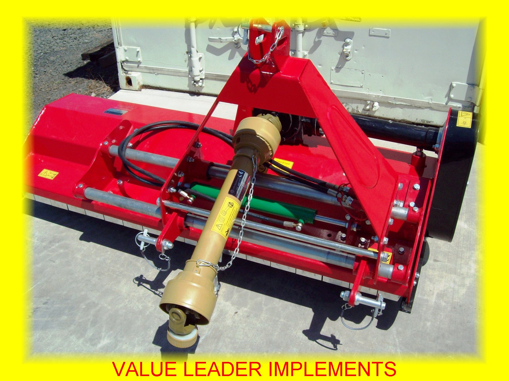

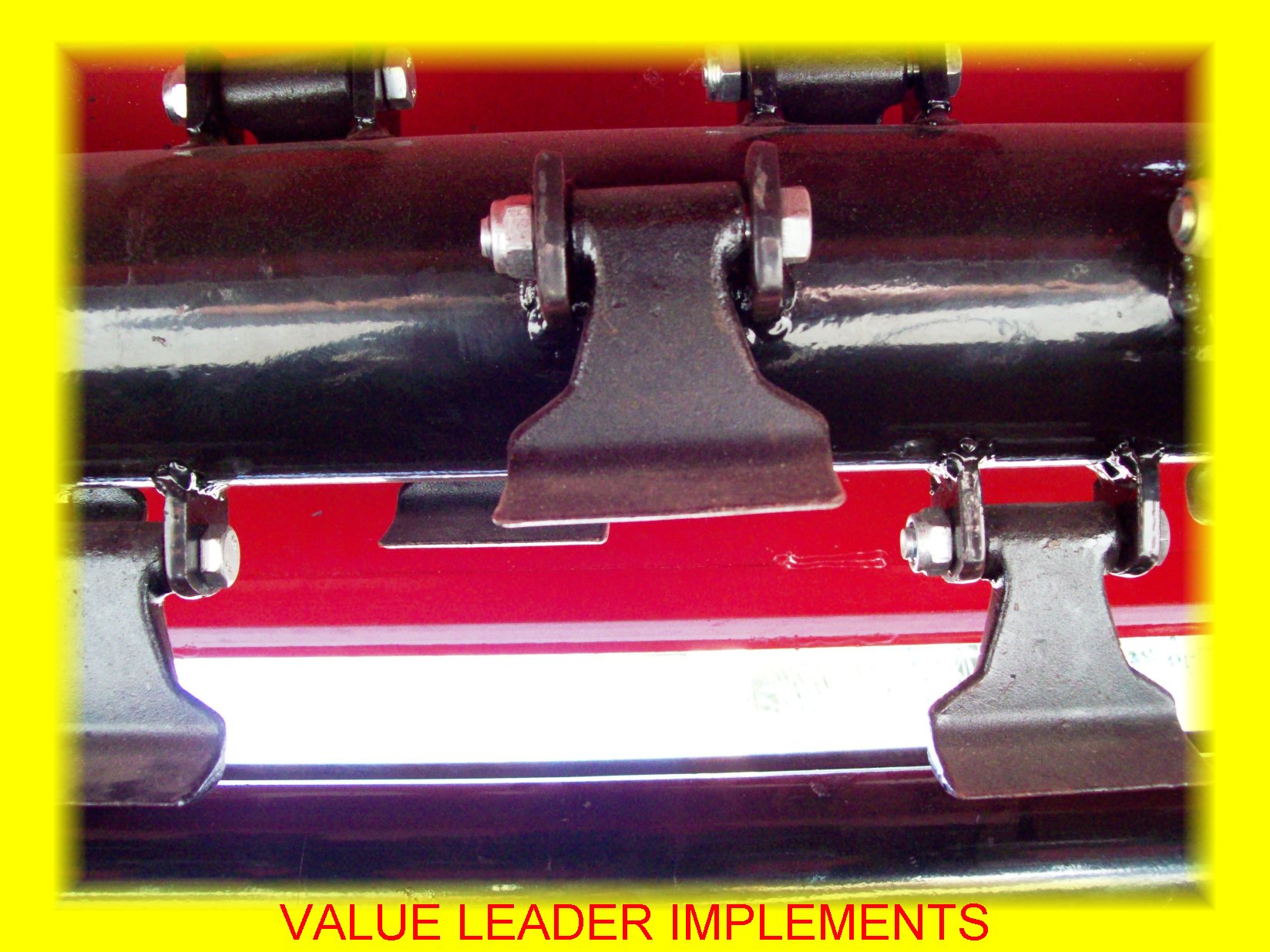

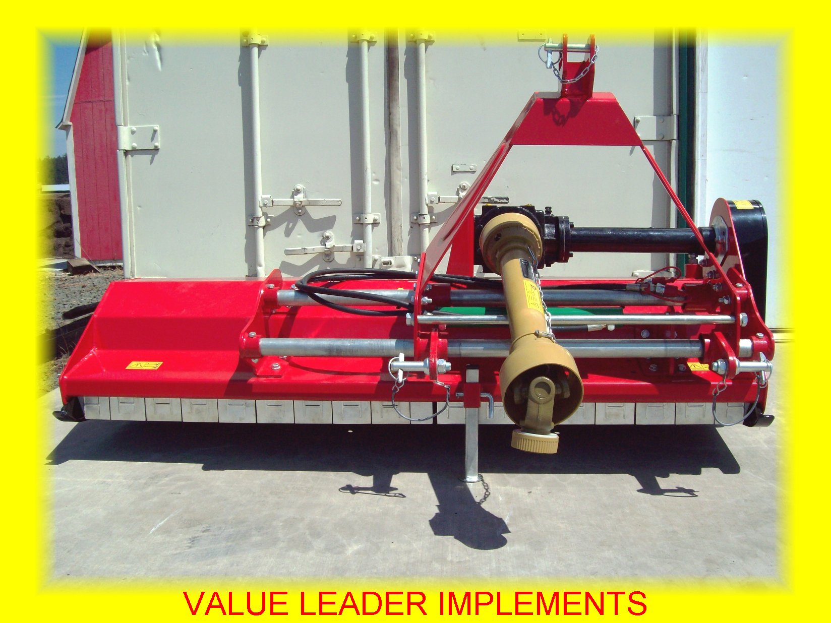

There is an implement dealer in Oregon who sells "Value Leader" brand flail mowers at what appears to be competitive prices. They also advertise on Ebay with a 100% feedback report. Has anyone used one of these flail mowers, or know anything about the quality and parts availability? Thanks

The lack of exterior structural steel worries me more than anything as it appears to have no bracing and the side weldments seem have no bracing either, the lack of skids or appearance of skids has me scratching my head too.:confused2::(
Is it me or is there no rear roller on the mower?, it would explain why it is so low to he ground and skid if any are not visible

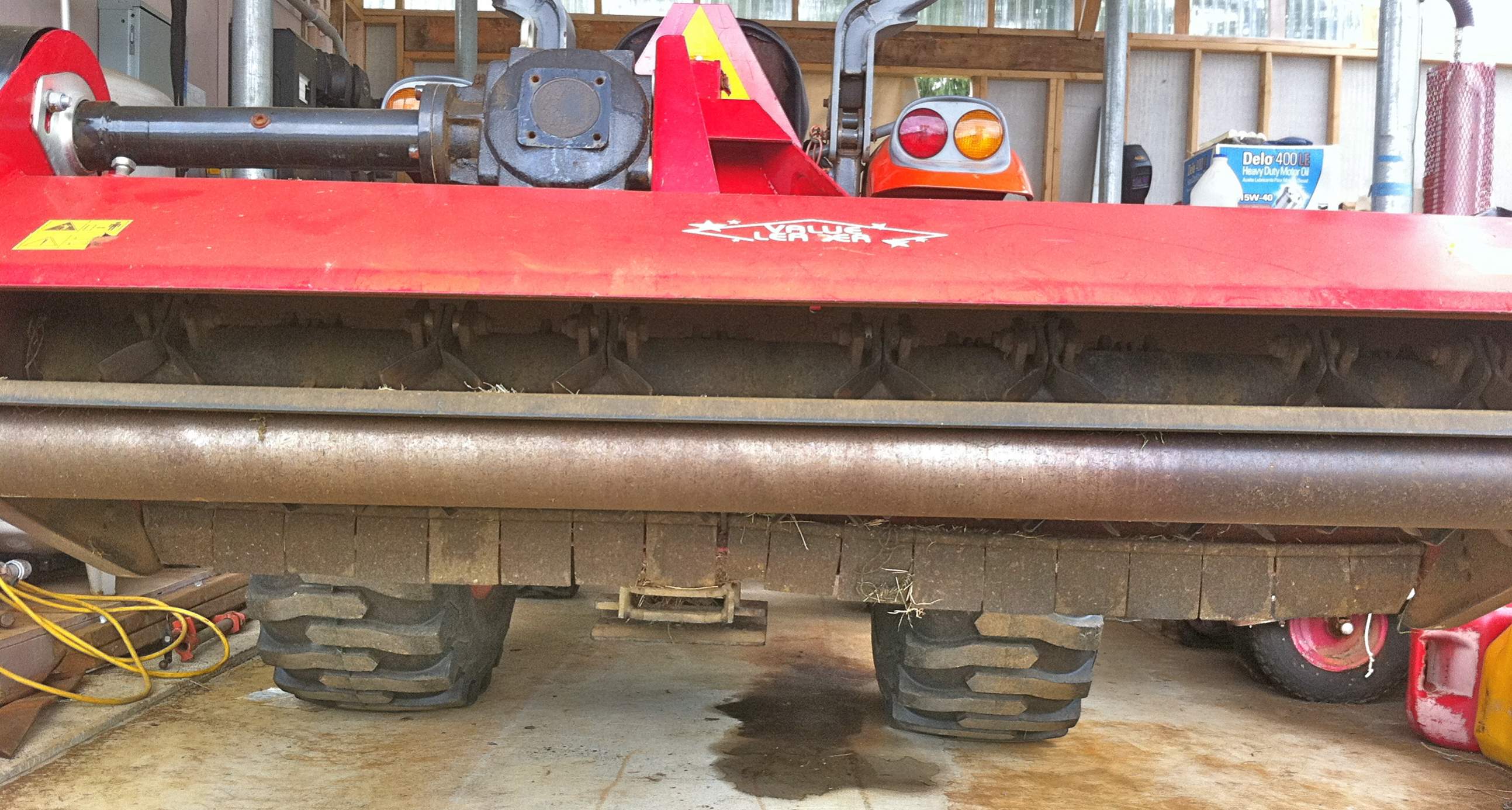

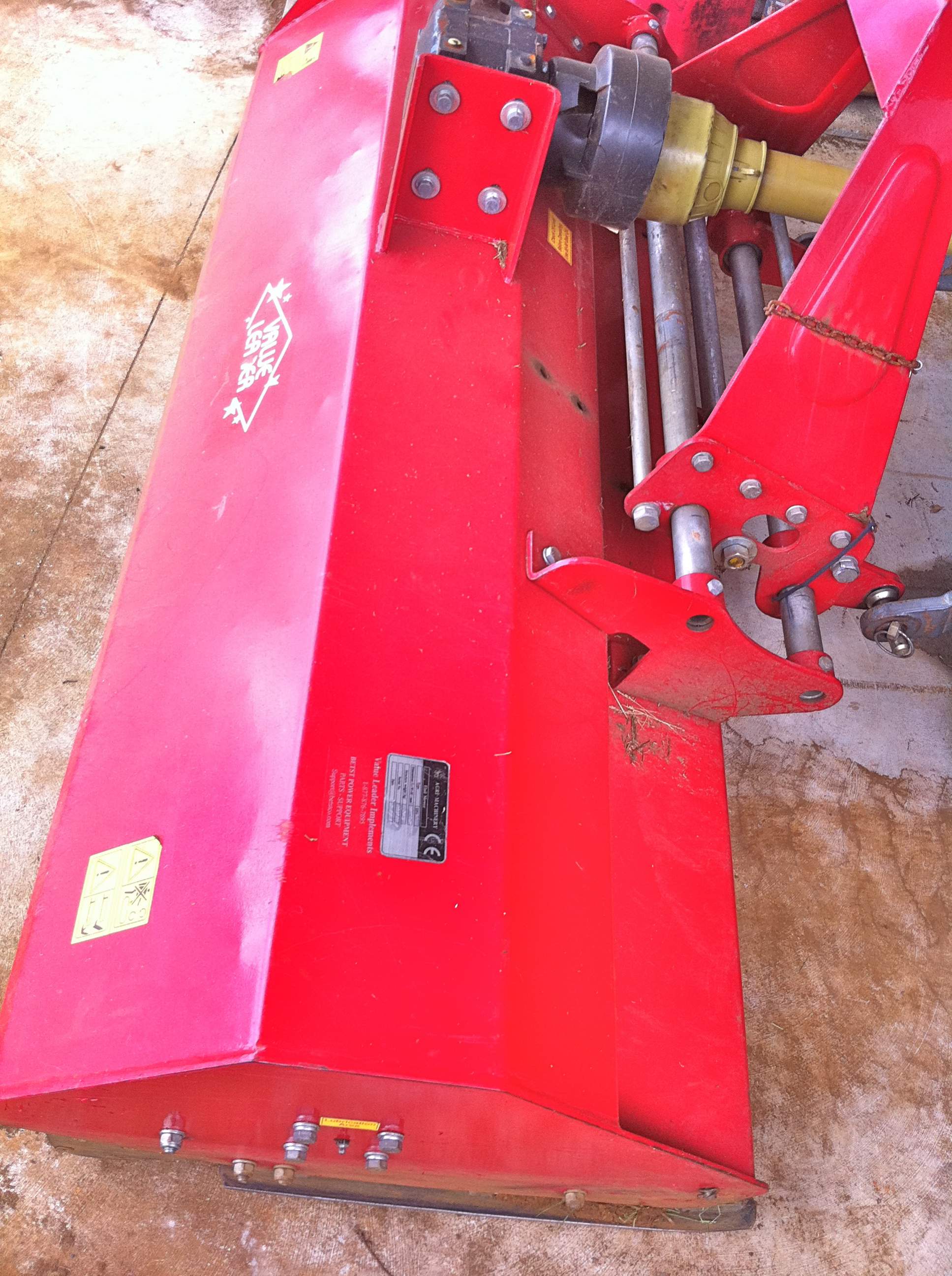

Do you have photos of your mower??? Not the website photos...
   / Anyone Know Anything About This Mower? #9
I 'll get some later today, but I'm not washing and waxing it. LOL
   / Anyone Know Anything About This Mower? #10

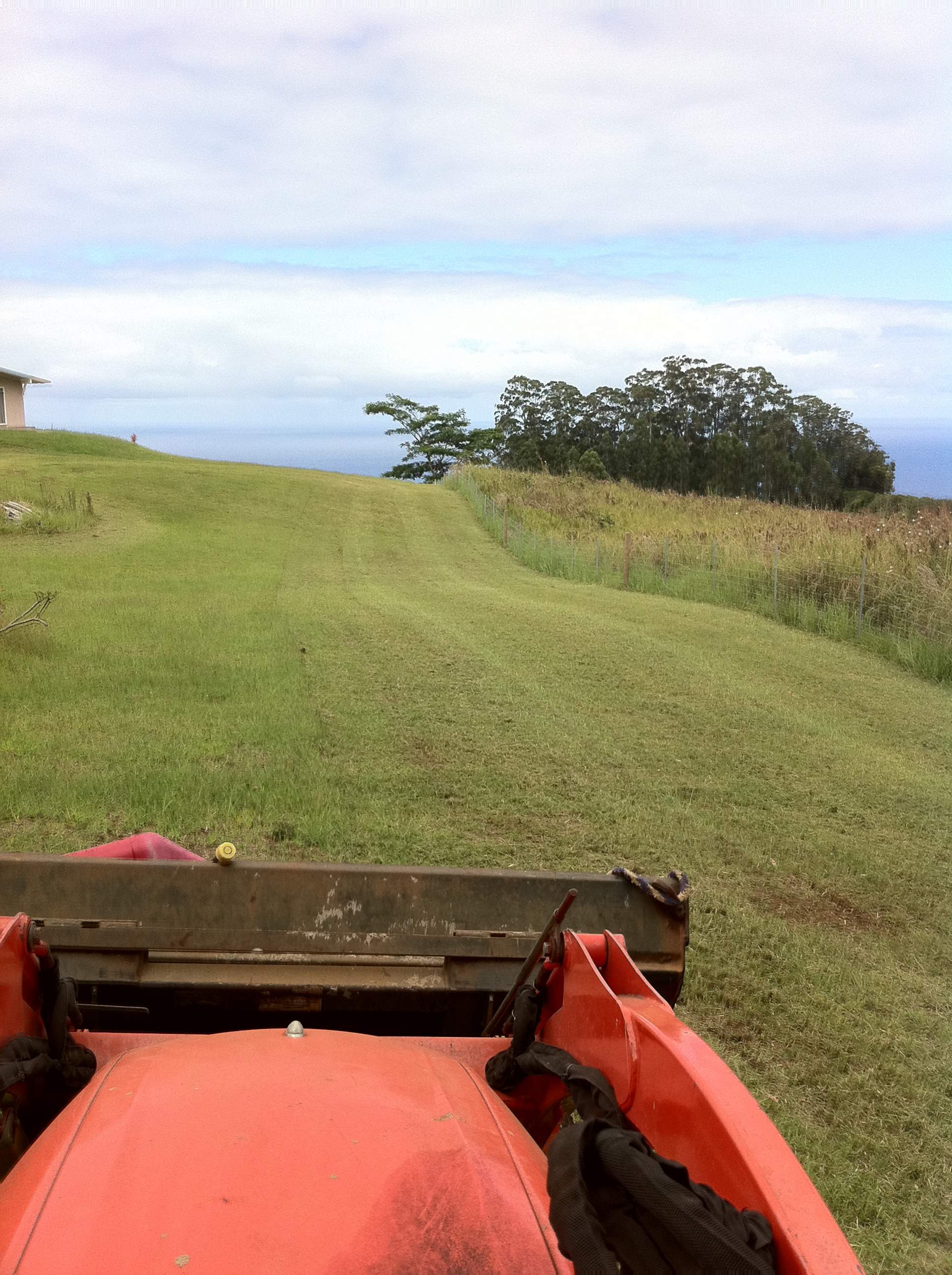

OK, here's the pics. If you don't see what you want, I can retry LOL
Notice, that I removed the hydraulic offset. Didn't have remotes installed.
I do like the current offset as I can get up close to my fences, go around plants, and my track is covered. I may reinstall the hydraulic after I do my rear remotes, but might not. I am curious to see how it works with the hydraulic toplink. I have tried using the slot instead of the pin hole, but didn't feel I had the control I wanted. :confused:
