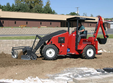

If you are serious about cooling the hydro fluid, then something like what the Power-Tracs use would be ideal. Some of our machines have a 20 gal reservoir, and an auto fan/cooler. The pump case drains is cooled by the cooler/radiator.Here is a picture of the cooler.

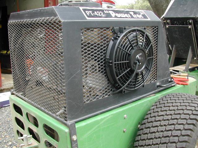

You could still do something like this. My hyd cooler/fan is on top of the engine cover. In the picture, the fan/hyd radiator is on the top, and just a fan on the side.
