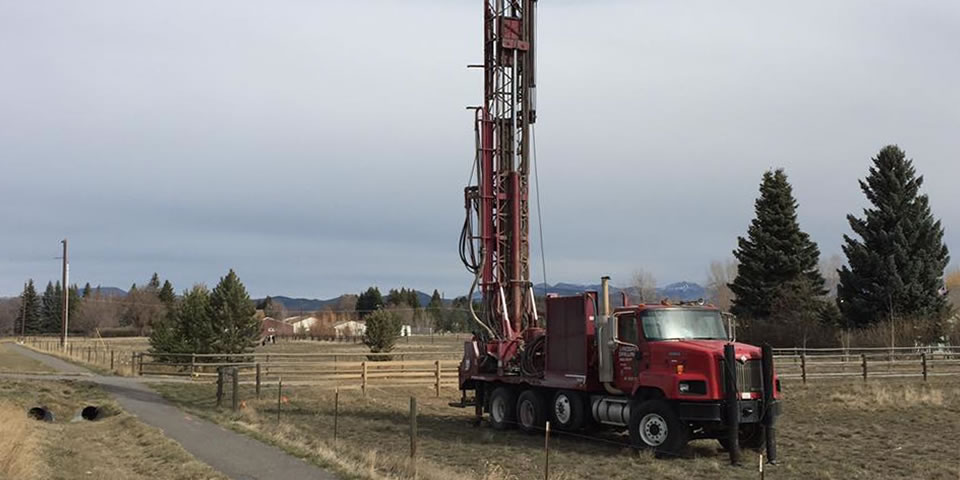

I hope you share with us your experiences step by step. I can't even begin to fathom using a modified post hole digger to drill a well. Around here they use a rig like this.
Whole different story when rocks are not involved from what Ive read. The small rigs are used throughout the world, the unit I purchased is supposedly capable of going 1200 feet.
