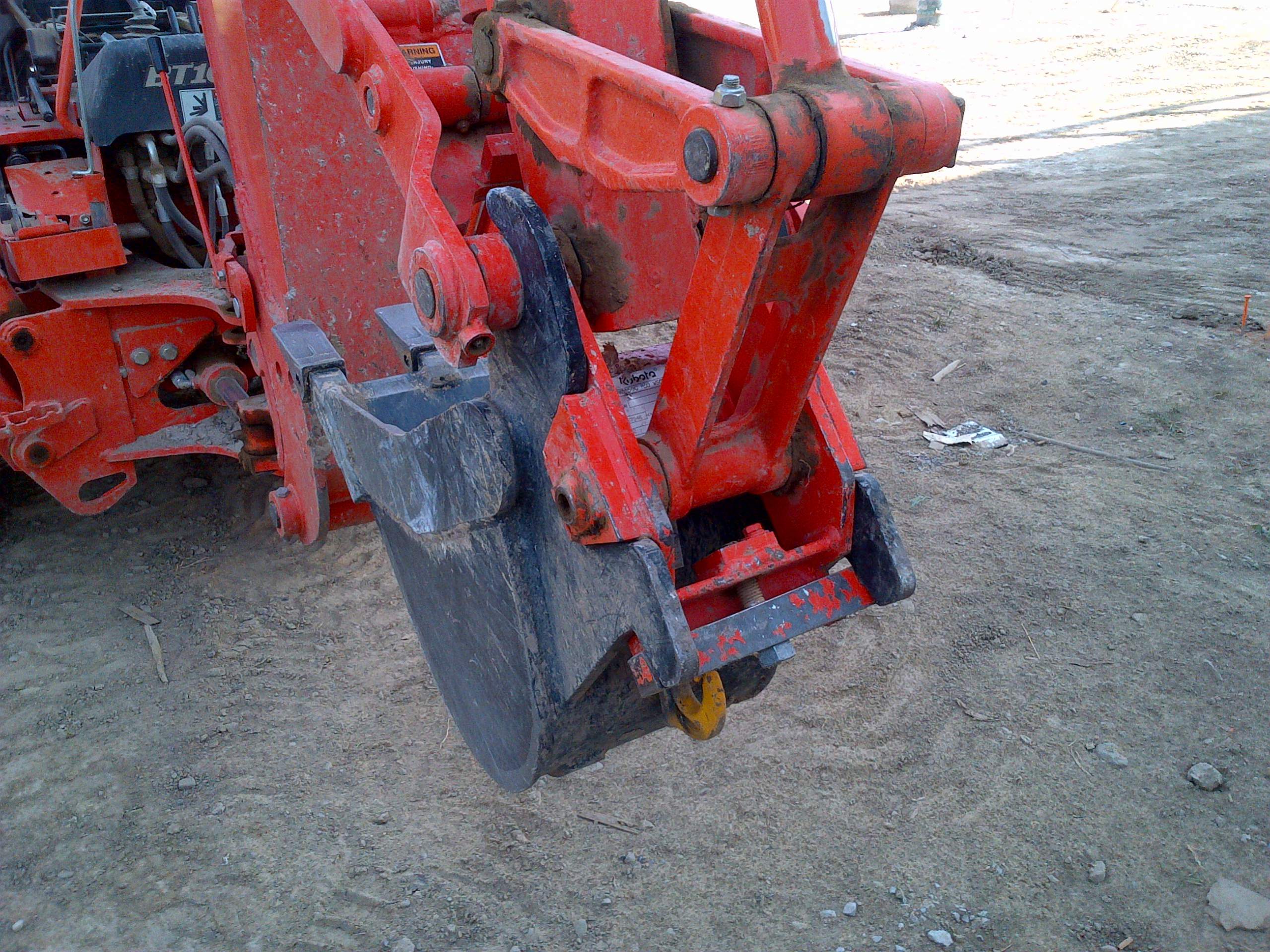

View attachment 273884View attachment 273885 The one thing you have to watch with a QA setup is how it the bucket sits versus the manufacturer's pin on version. Some QA setups increase the spacing of the pins which gives you a little more reach but also affects the leverage of the hoe because of the geometry change.
Thanks for your detailed and thoughtful comments. I was wondering about how the coupler might affect the bucket geometry. My Woods bucket has two sets of mounts for the bucket link pin. One is presumably fast and the other a more powerful position. As I am nearly always more interested in power than speed I need to make sure an coupler is designed to mount to the bucket power setting.
I already know that a coupler will disrupt the thumb to bucket geometry at least in length so the thumb teeth will no longer meet the bucket teeth and interdigitate (?interdentitate) properly. The malocclusion shouldn't matter for picking up logs or big rocks but it will mean that items smaller than the 6 inches or so (of added length from the coupler) will no longer be clamped. I guess I'll have to stop picking up dimes and pebbles.

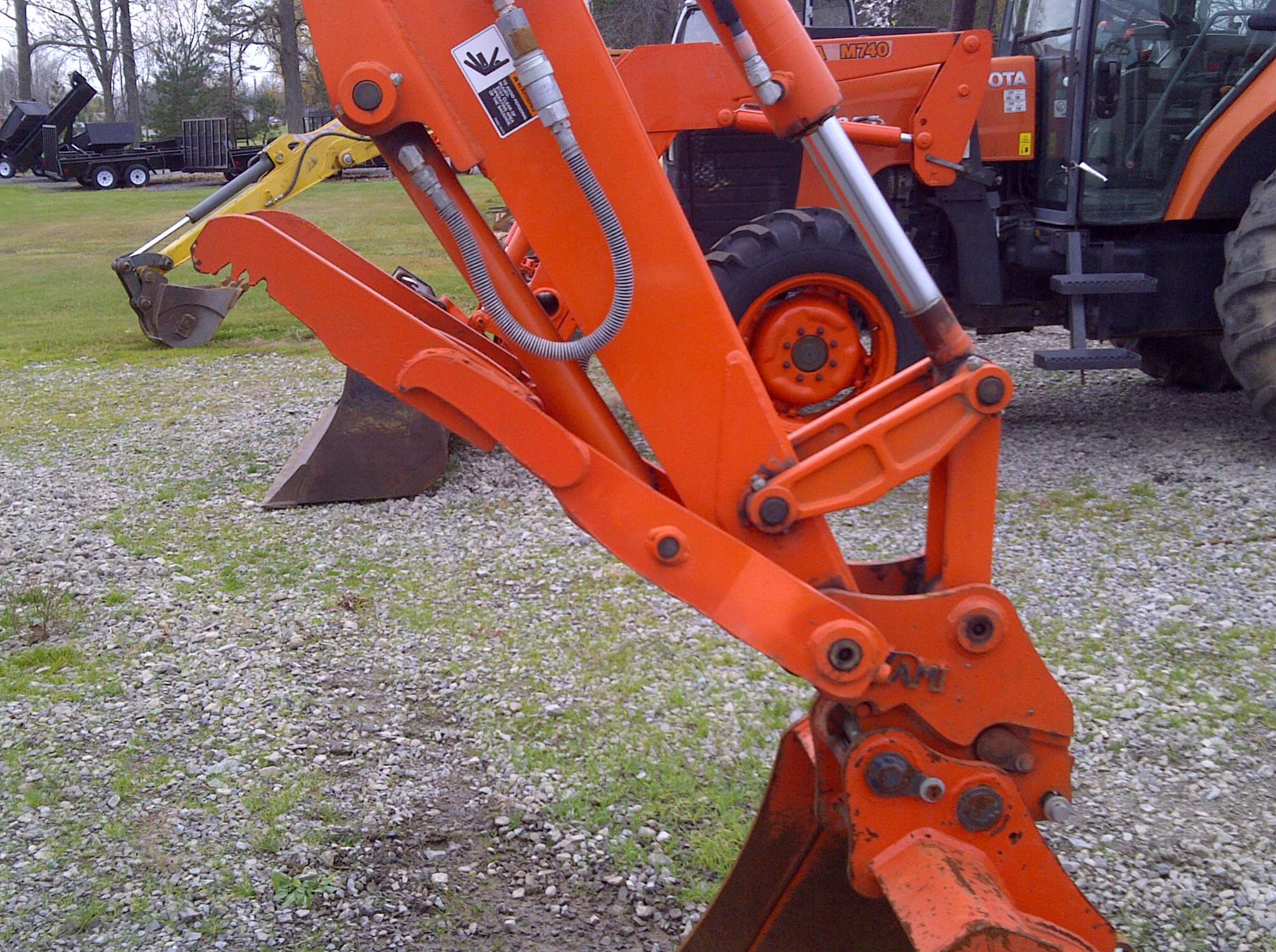

Hi IslandTractor
Attached are a couple of photos of a used M59 QA I looked at prior to purchasing my L45. The original owner had other excavating equipment that used a QA system from a company called AMI so he had an AMI QA coupler put on the M59 so he could share buckets among his machines. As you can see the pins are 4"-6" away from the original location and you can see the plates they had to weld to the Kubota thumb in order to have it close along the bucket edge.
Regards,
Lauren

Hi IslandTractor
Regards,
Lauren

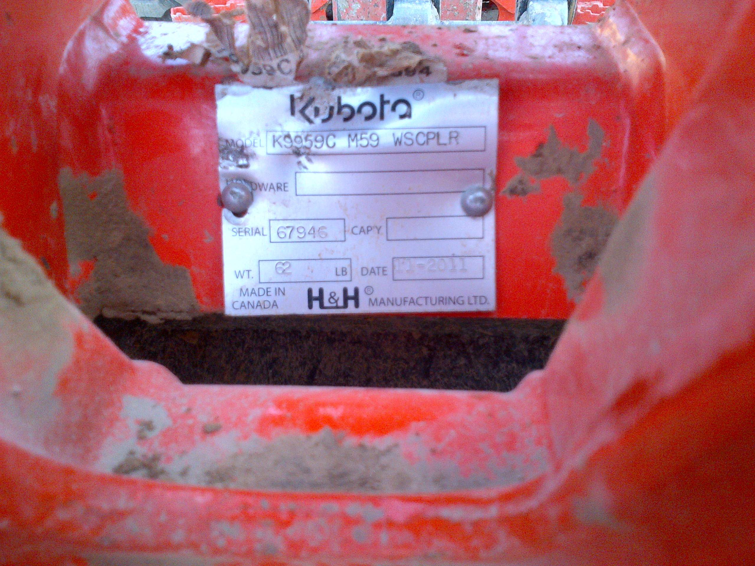

For those of you that are interested, attached is a photo of a set of L45 ears from H&H for the Canadian backhoe QA. These look similar to the QA on the JD110 so it would be interested to compare the dimensions on the Kubota L45 and the JD110. Can anyone post a photo of a US L45 QA bucket - I'm curious to see if there is a difference.
Regards,
Lauren

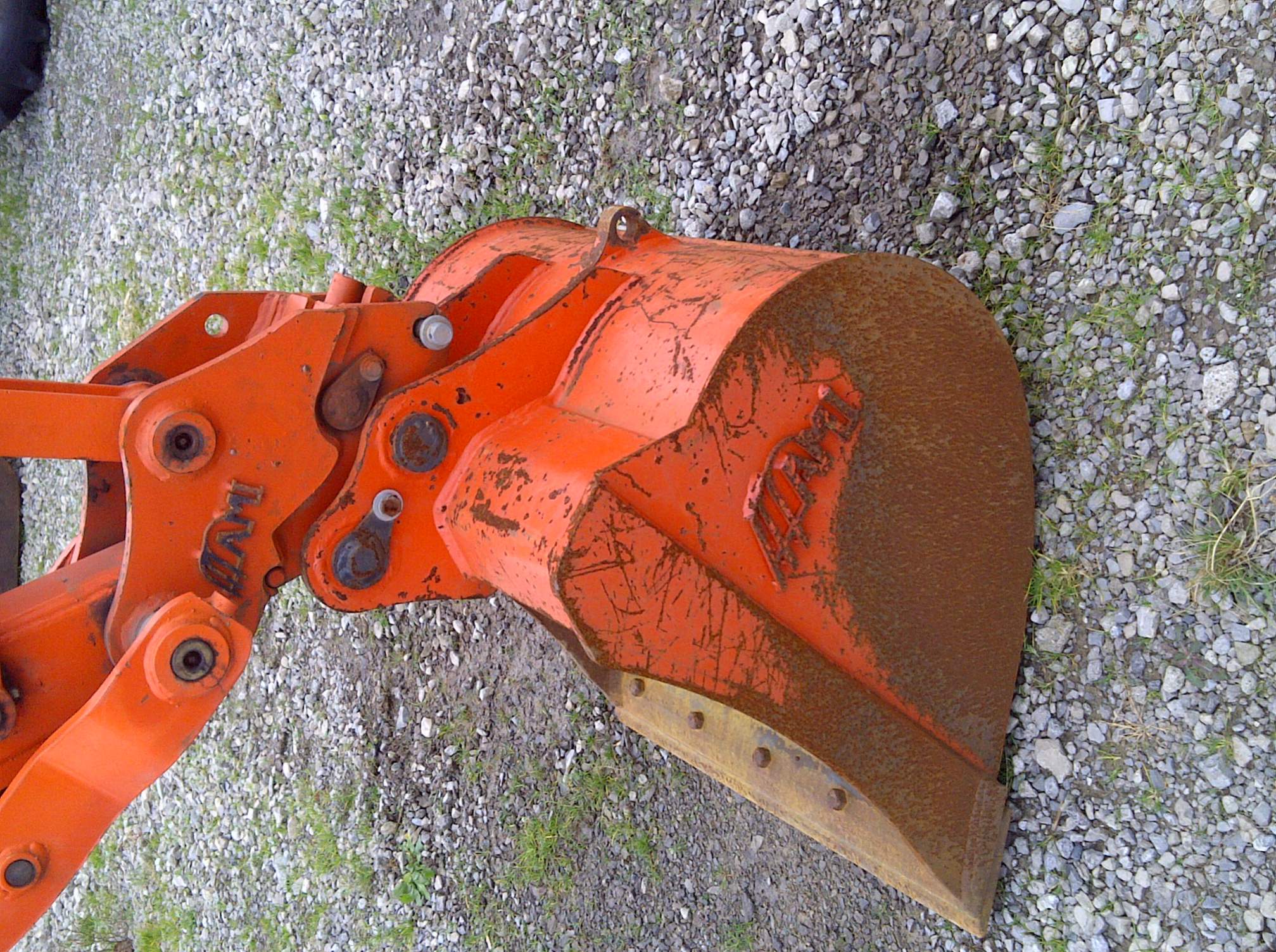

Here's a pic of a US L39 QA bucket

Thanks for the photo MBradey
Now that I see that, it wouldn't be that big a deal to modify my L45 buckets to take the pin and eliminate the PITA bolt and wedge. Unfortunately I have three buckets plus the ripper so it would be quite a bit of work. I guess I'll have to see how much wrenching I'm prepared to do rather than take the time and money to modify my current setup. The L39 sure looks like a better solution to me.
Regards,
