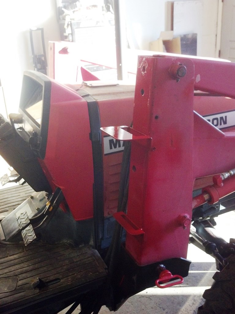

I was looking for ideas too, or for a mount I could buy for a reasonable price and just bolt up. I gave up and made my own mount this weekend. :)
Lower is 1/8"x2" angle, upper is bent 1/8" plate. Slot in angle to fit bar cover, and in the top plate to fit the felling dogs, which are on both sides of the bar on my saw.
Welded them on, painted it all red.
I still need to get a piece of stick-on rubber tread stuff from HF for the upper mount. The saw will rest on the rubber, not the steel.

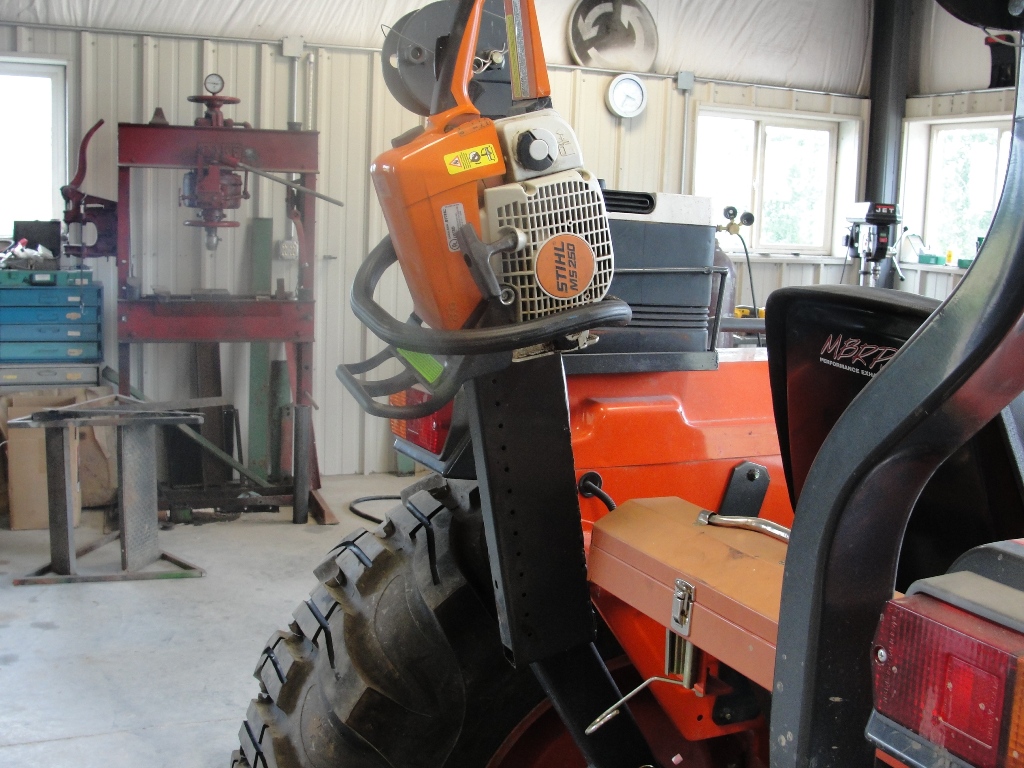

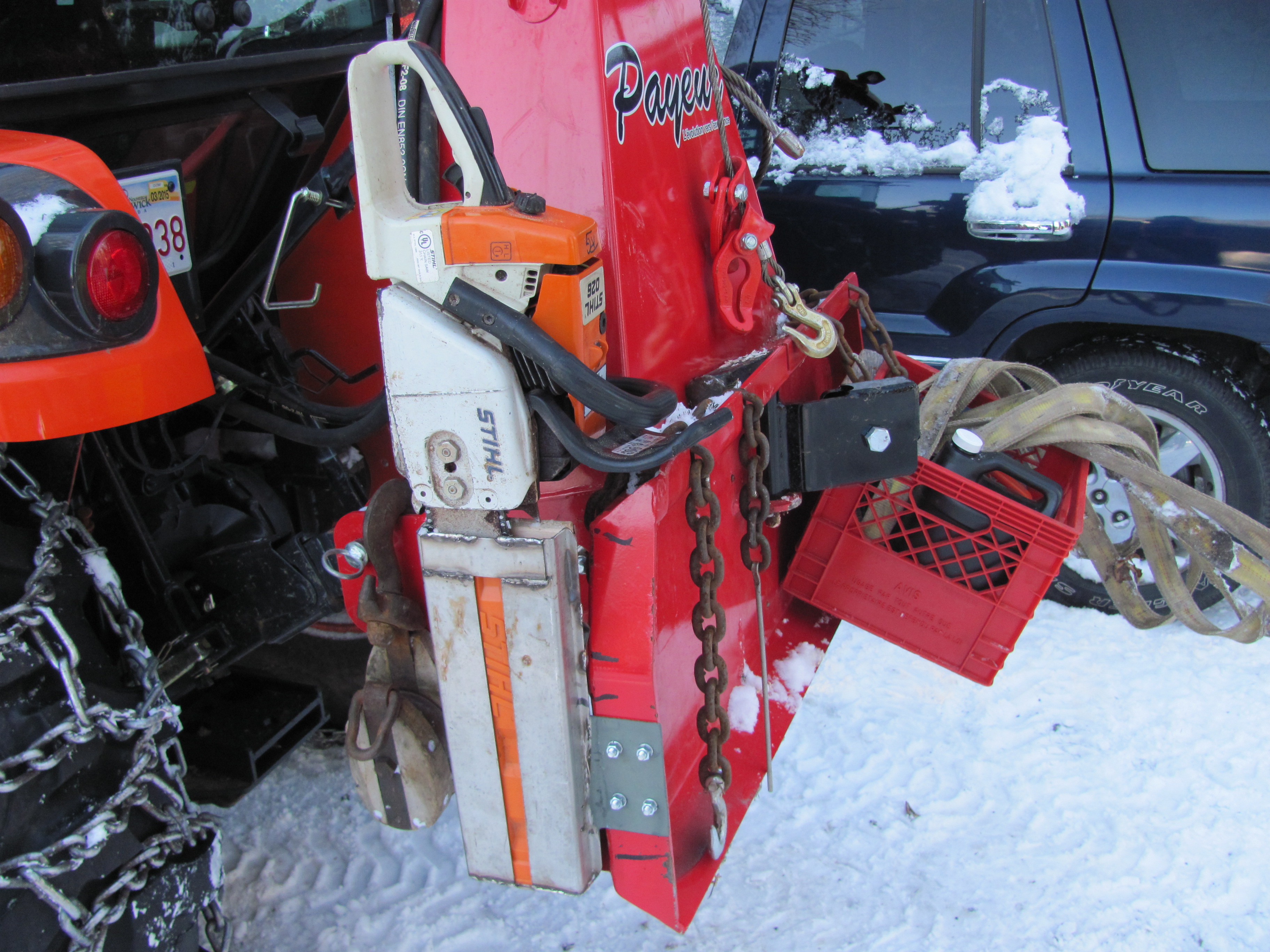

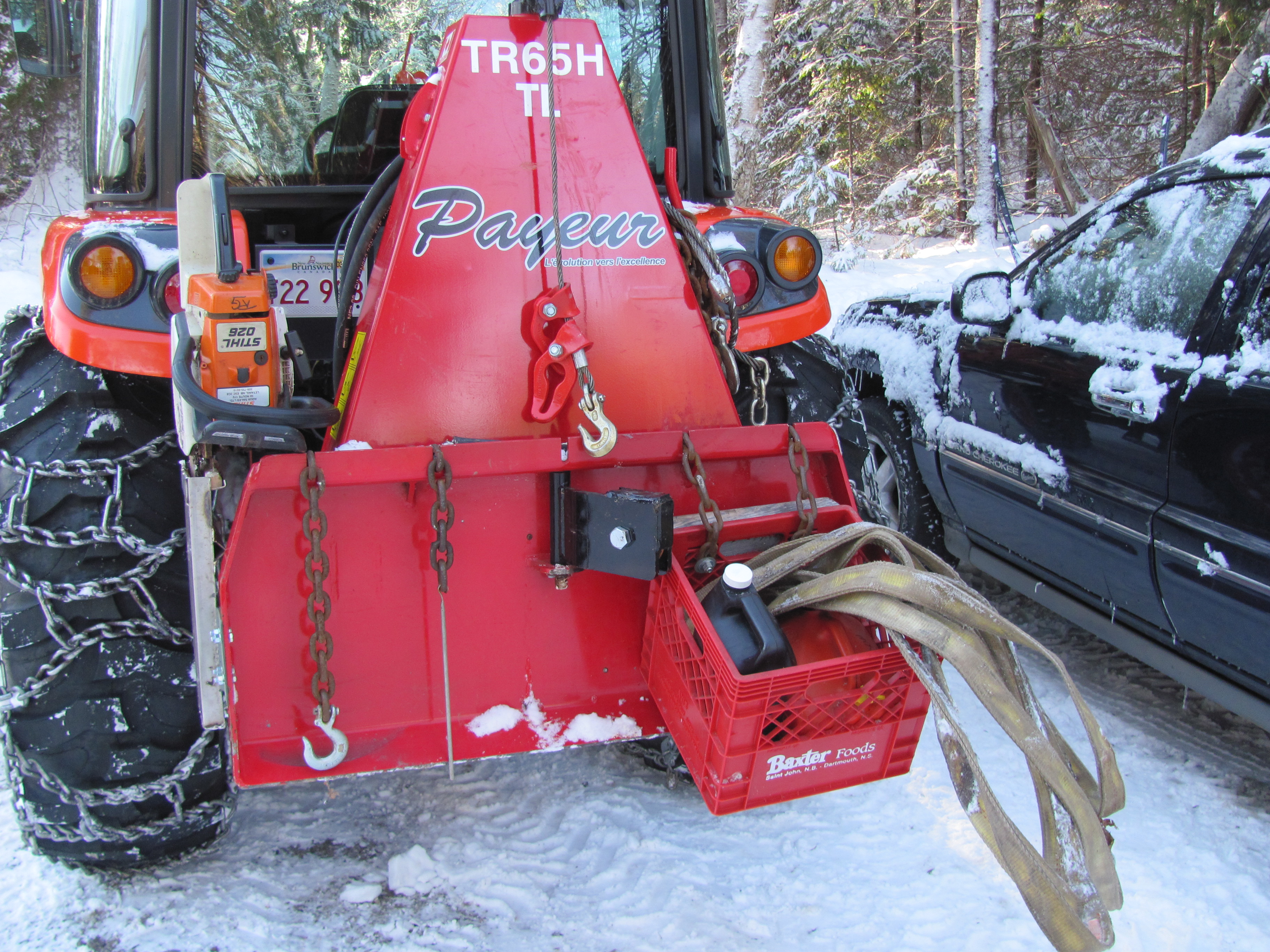

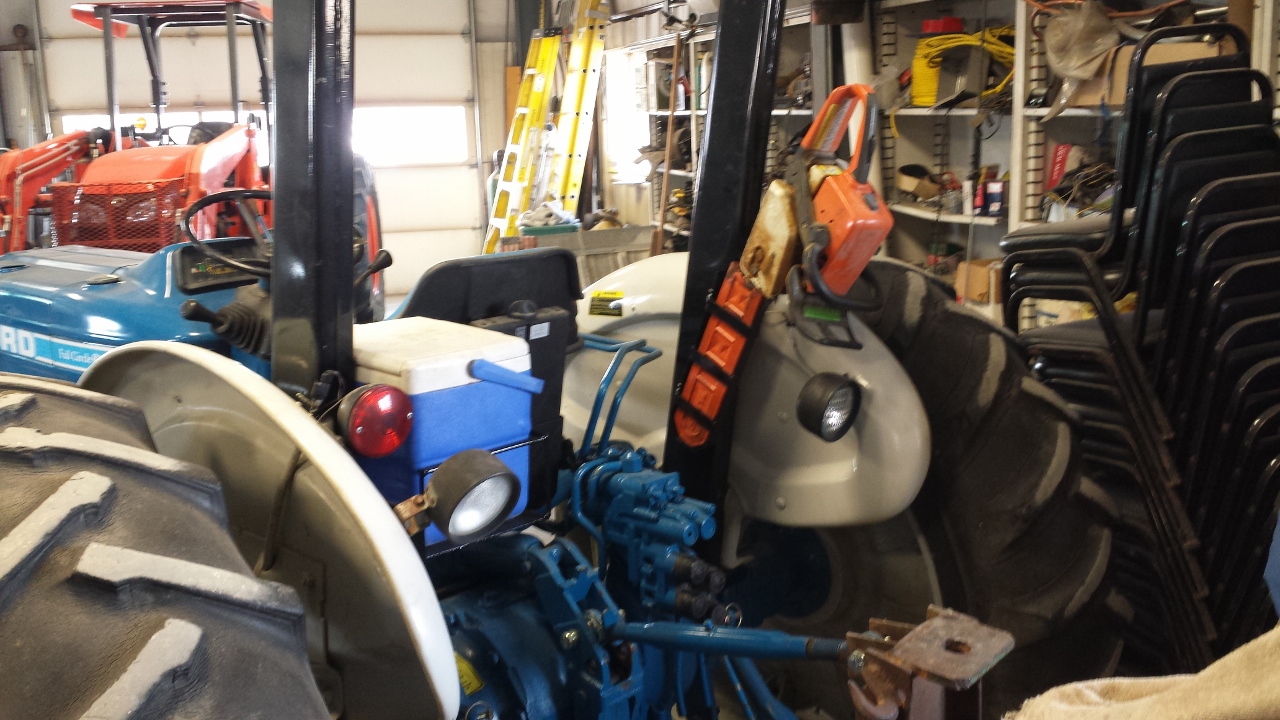

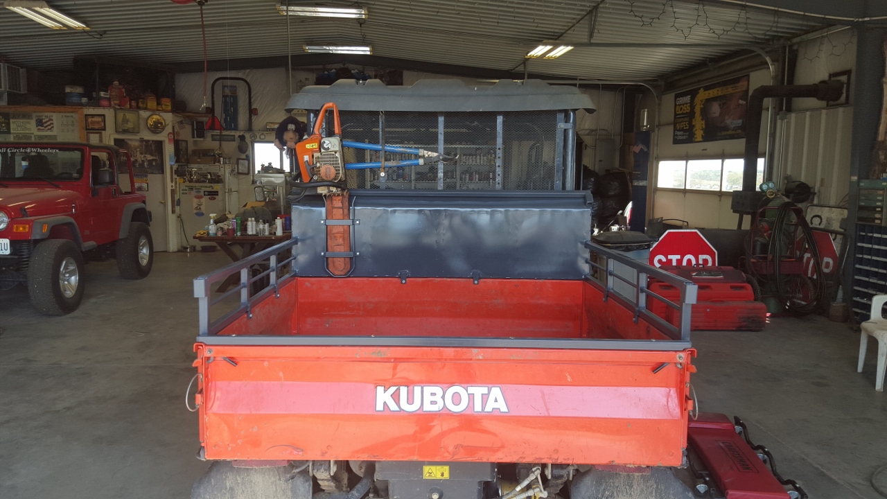

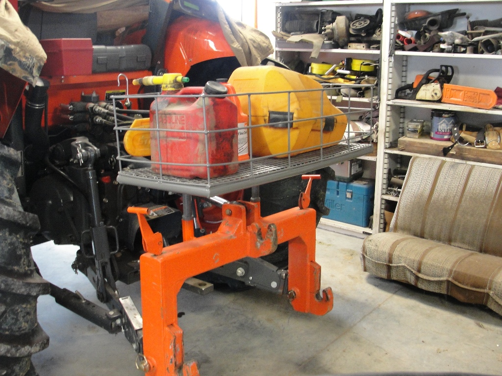

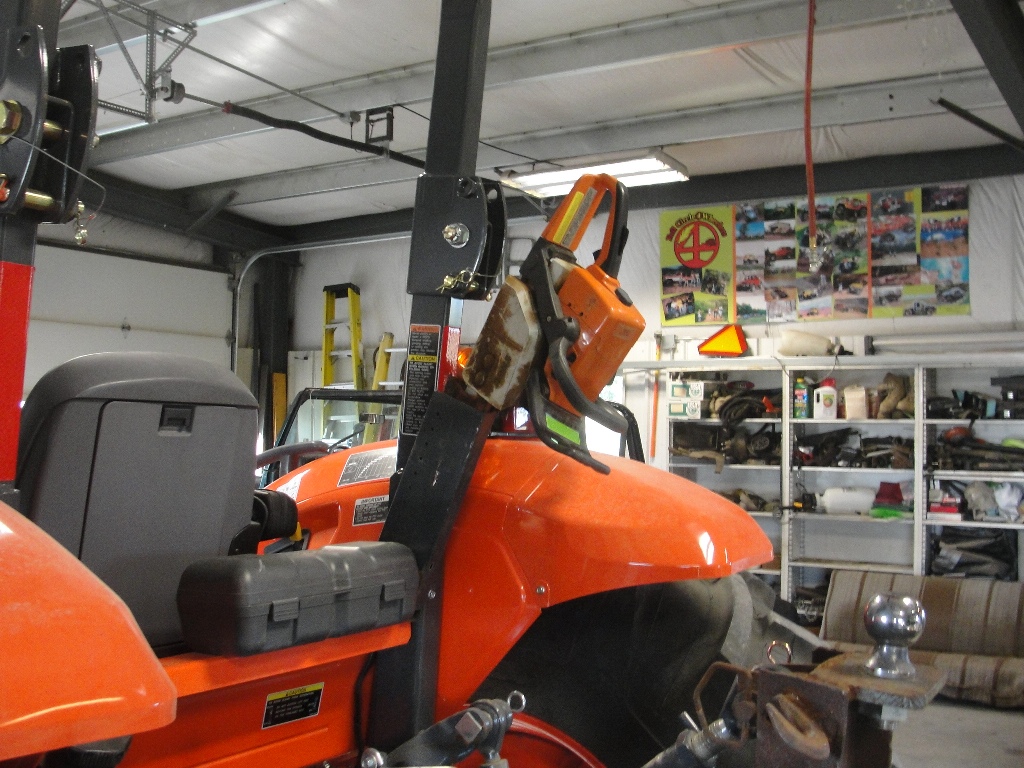

Some ideas.
   / Anyone have photos of a Chainsaw holder? #27
Richard, if your saw has a full tank and you put it in the ROPS mounted scabbard, does gas leak out the tank vent?
None of them leak fuel. One of them leaks chain oil.
