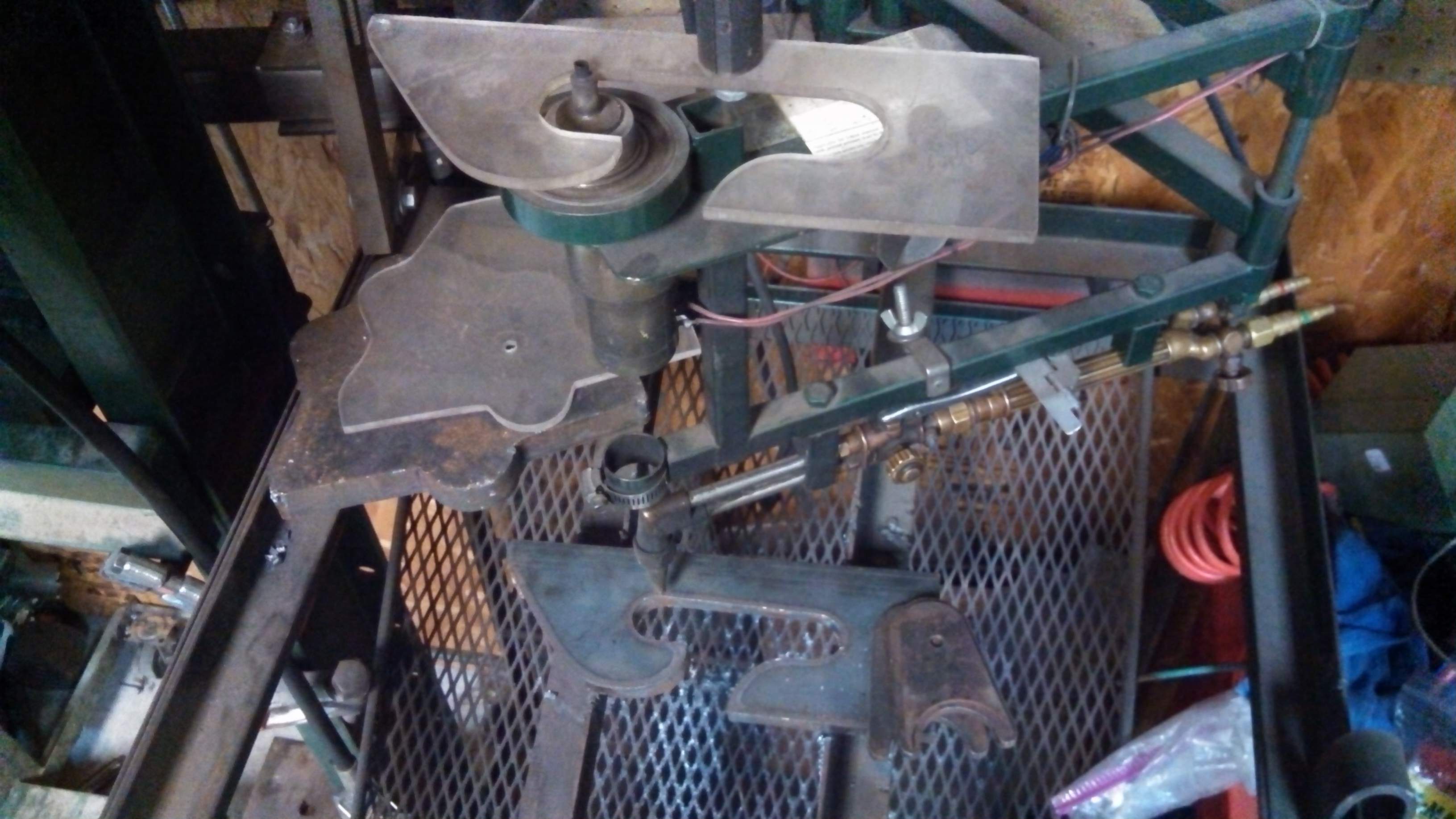

Simple stuff like that is why I built a pantograph. Sawing a template out of plastic takes less time than programming and setting up my CNC plasma. The $80 labor was because they don't like to set everything up just for one part. Order a few hundred and they would get real cheap.

This is the pantograph I was talking about in an above post. Should have made it 20 years earlier, very useful for many projects. And a lot of templates are quicker to make up for a few parts than making the program and loading it into the computer that runs the CNC.

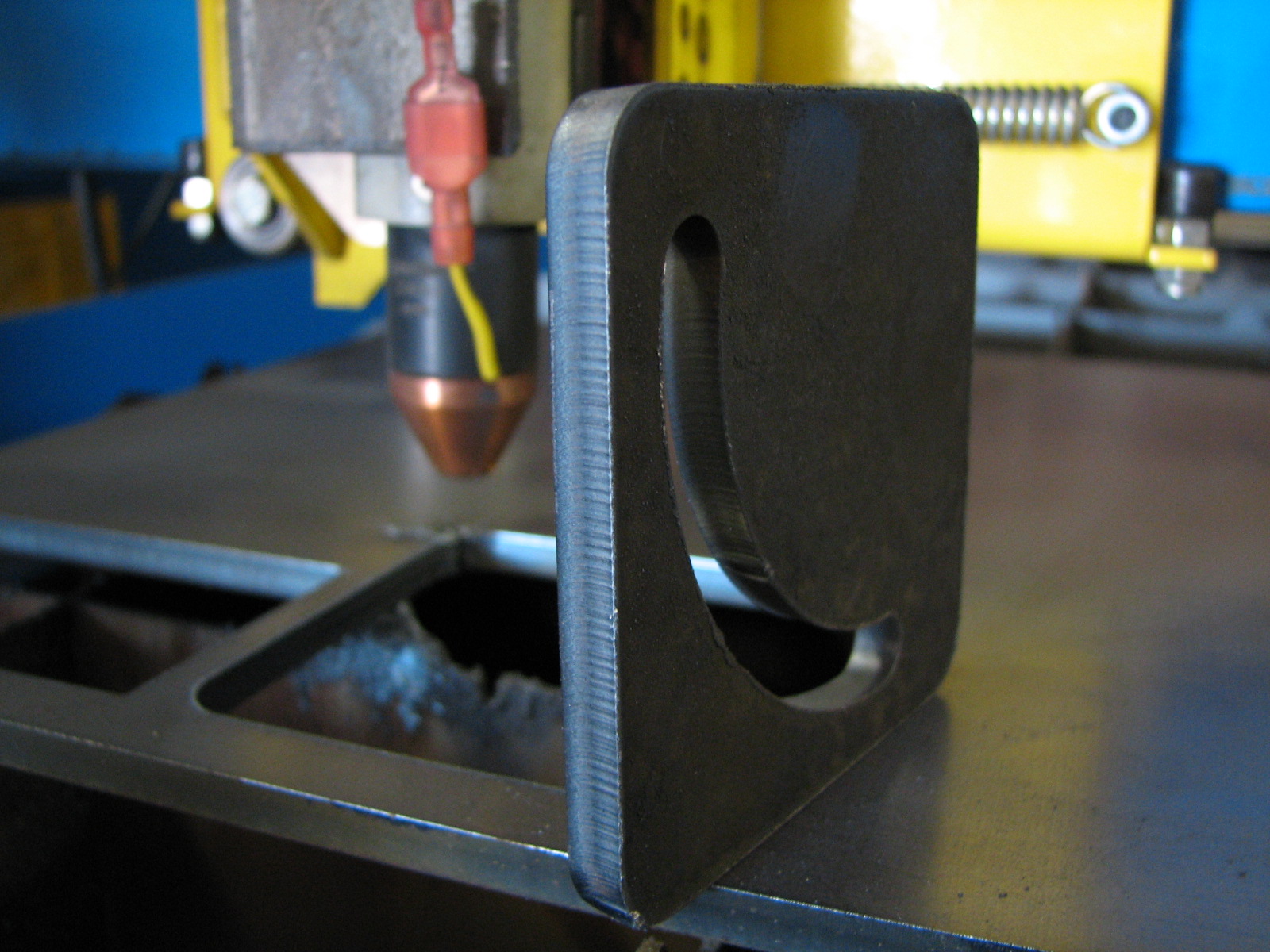

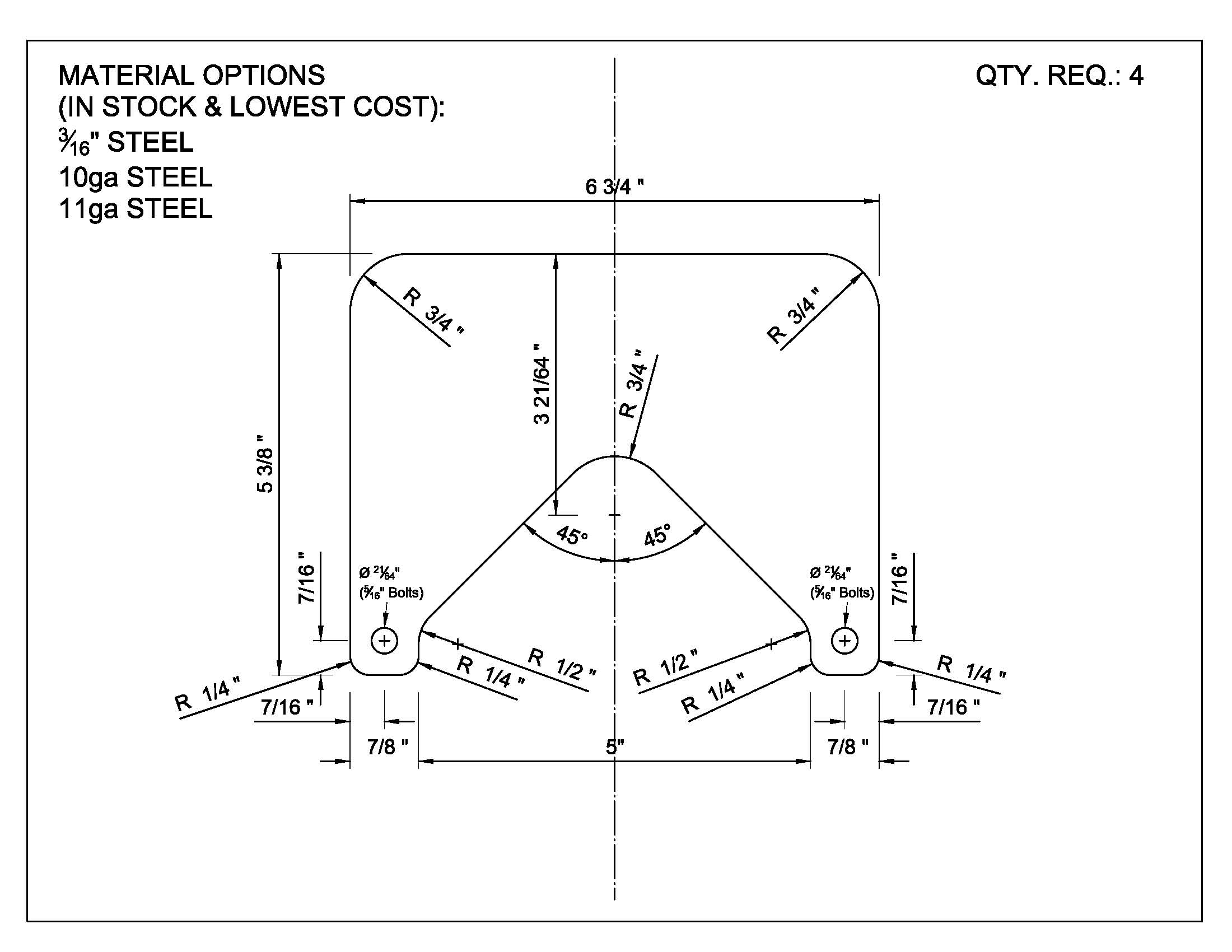

I have a home based metal shop with 2 cnc plasma machines. The parts you show would be around $12 each out of 3/16" steel......shipping via USPS flat rate (for 4 pieces) would be about $16. The parts would be within .020"....holes within .010".
I would use my PlasmaCam machine...drawing the part using PlasmaCam software would take me roughly 5 minutes, cutting the part with a Powermax85 (Hypertherm) plasma would take about 35 seconds. The holes would be cut slightly under, then drilled with the proper sized drill. I can do the parts tomorrow.

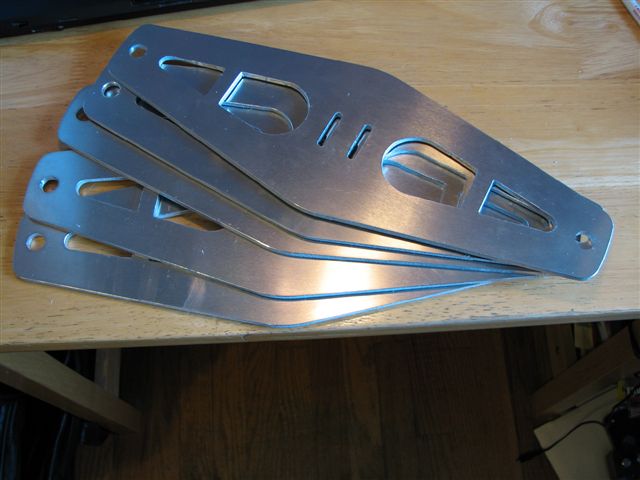

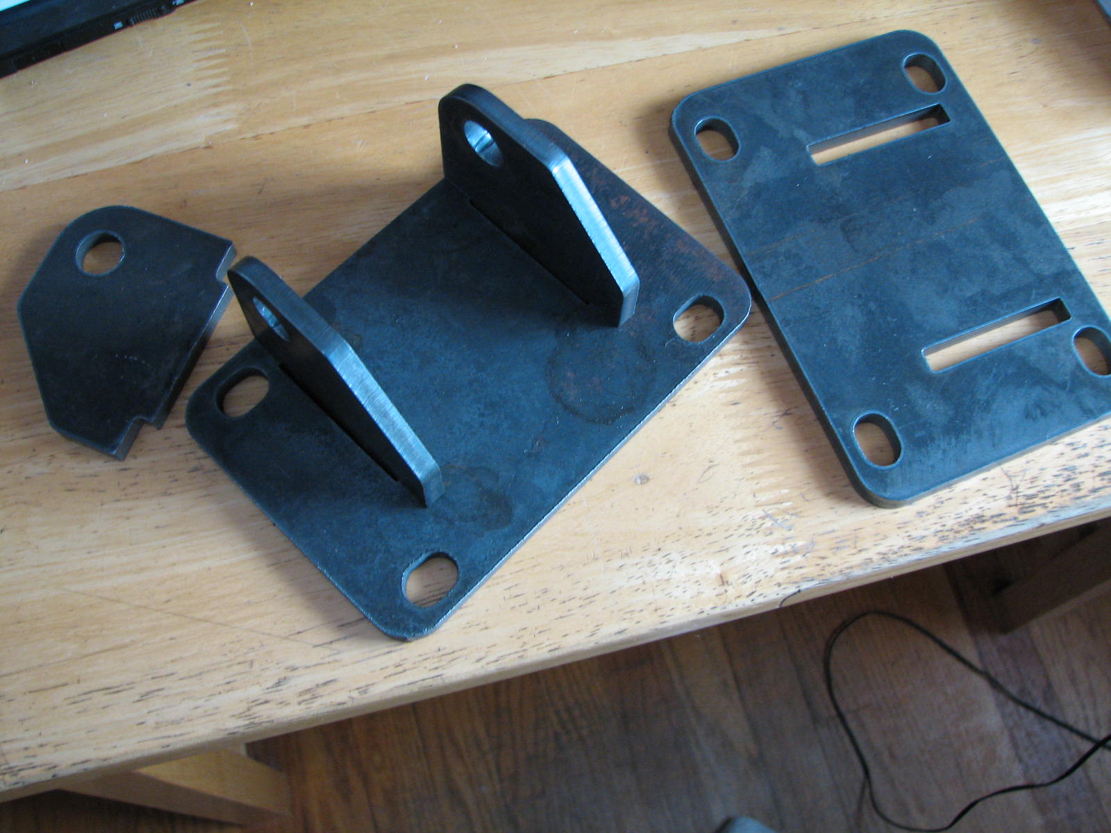

Here are some other similar parts done in my shop..250 cuts 001.jpgIMG_2766.jpgIMG_2421.jpg
Jim Colt I work for Hypertherm.....but have a home based light fabricating business that my son operates. jim.colt@hypertherm.com
Update....I had a few minutes so I drew the part in CAD as posted. The part cut from 3/16" steel will be $10.43 each. 4 of them will fit in a flat rate medium box ....which is $11.30 shipping in the 50 states. So, for $41.74 + $11.30 shipping....you can get your parts cut accurately and quickly with plasma. My son has no minimums....and will ship anywhere in the US and Canada
I'm making a bracket to mount my 15 gal sprayer to my ZTR mower and I need some steel sheet cut out. I already have some material and can do it myself with the few tools that I have (portaband, grinder, etc.), but I don't really have the time to spend on cutting these out. I got prices from a few local shops here, but they were all way more than I'm care to spend. One shop quoted $3+ for material and $80 labor (laser). I'm not saying they're out of line. These are large shops with large machines, so their overhead just to start the machines up is high I'm sure. I don't know of any other shop locally that is a smaller operation with smaller machines and lower operating costs. Does anyone here do this line of work or know of any place online that provides these services? I've attached a picture of the bracket.
