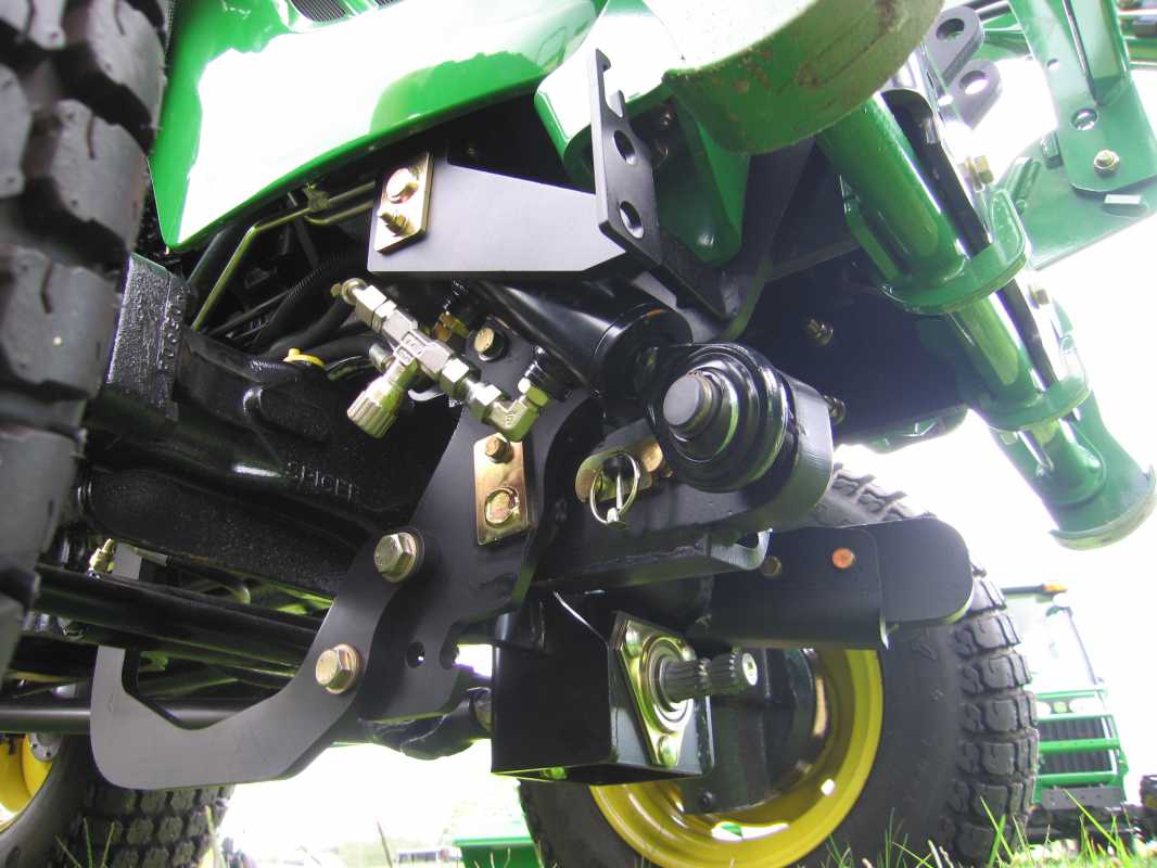

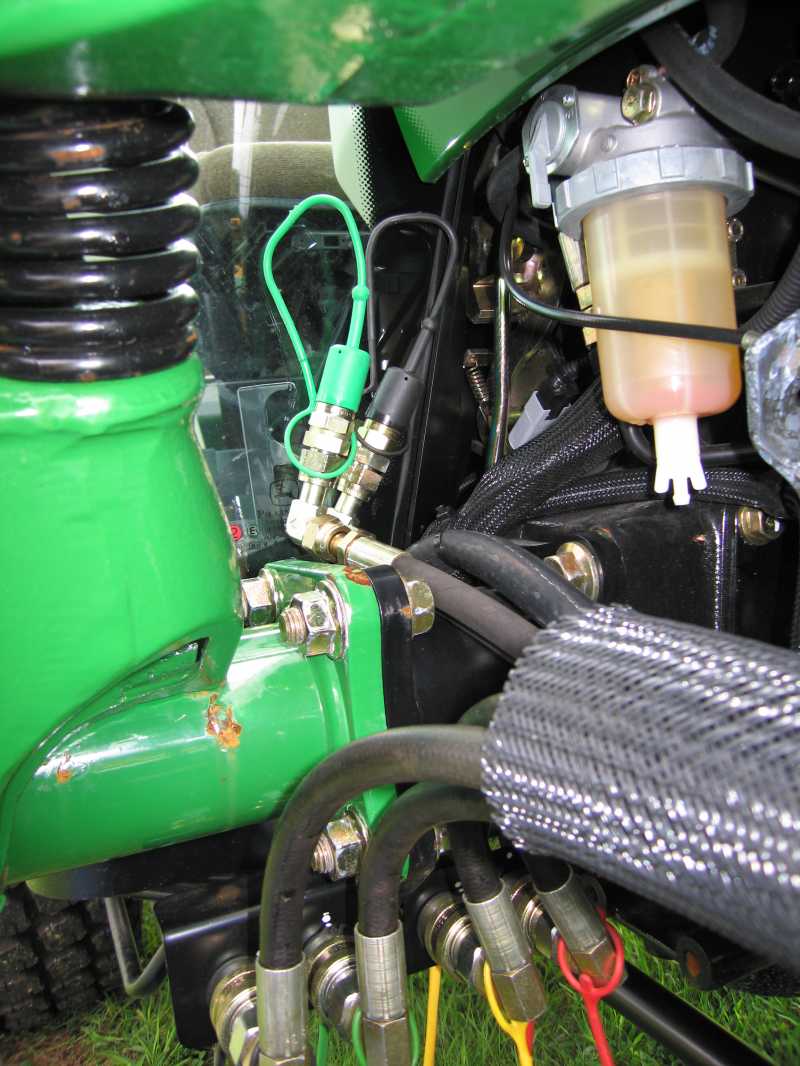

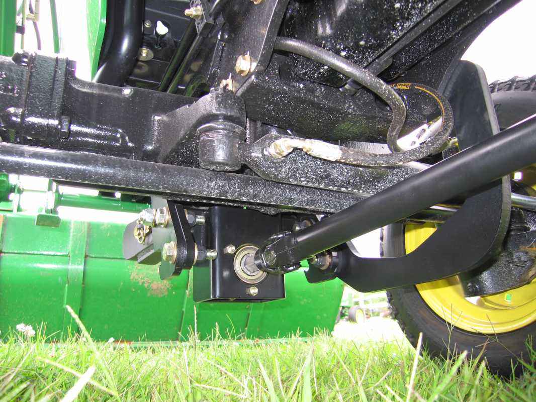

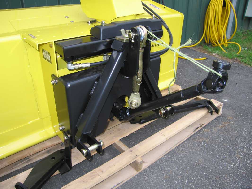

I recently talked with a dealer who has installed several of the new 59" Snow Blower setups on 3x20 tractors. He had nothing good to say about the new setup. He doesn't understand why Deere moved to this new design. He said he definitely preferred the old setup on the 55 Series and TEN Series tractors. He said the new setup is very difficult to install and it's not something you would want to remove in the spring.
I took some pictures of the new setup. It seems overly complicated to me. After talking with him and seeing the new setup, I think I'm going to try to adapt my 55/TEN Series hardware with my new 3320. He seemed to think it would be fairly easy to do but he has yet to try it. Has anyone out there adapted their old 59SB framework with their new 3x20 tractor?
Picture Comments:
* You can see that the hydraulic lift cylinder for the snowblower now remains on the tractor when the snow blower is removed. I don't like the idea of leaving this on through the off-season.
* With the new system, the hydraulic lift control lines remain on the tractor when the snow blower is removed. With the old system, all four hydraulic lines remained with the snowblower. Again, it seems odd to have these hanging around throughout the off-season.
* You can also see the bracket connections to the tractor are significantly more complicated. This is not something you would want to remove in the spring.
* I like the concept of the front 3PH but it would make more sense if you could leave it on during loader use. Even once you remove the Snow Blower, you still cannot use the loader. In order to use the loader you need to remove the A-frame, top link and lower link arms as seen in the last picture.
Again, I would be very interested in hearing from anyone who has adapted their 55/TEN series snow blower hardware to their newer 3x20 tractor.
