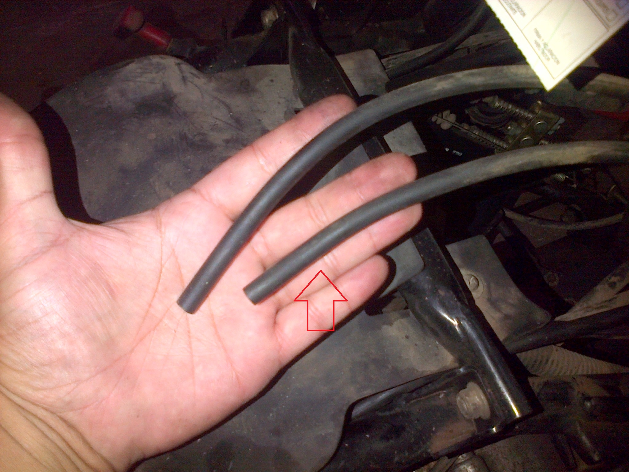

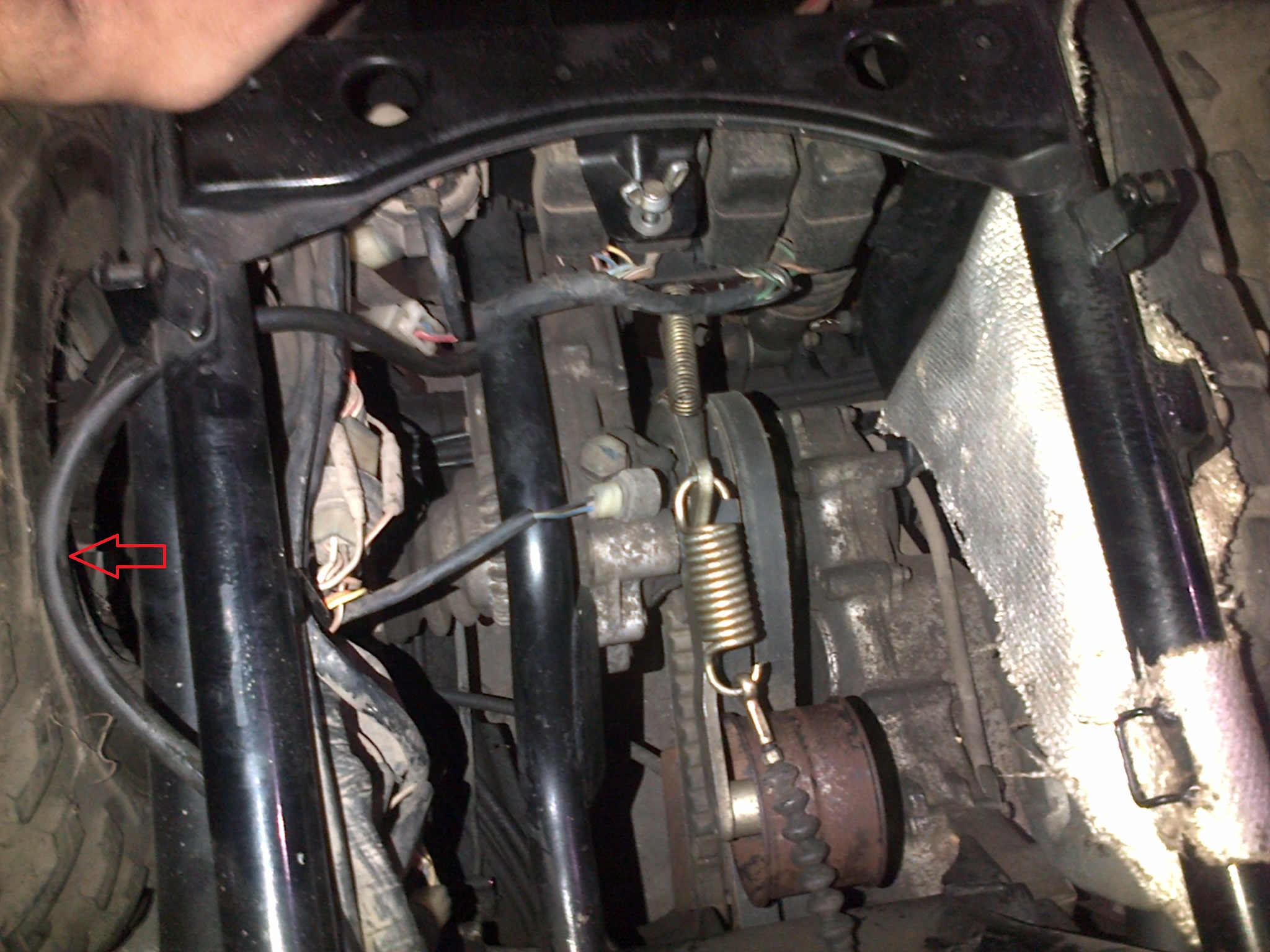

no, they are a MANIFOLDS leaving the rear wheel right and one that goes above the PTO, and go to the front of the quad, where are disconnected
Does it look like this?
   / Anyone have a Yamaha Terrapro? #63

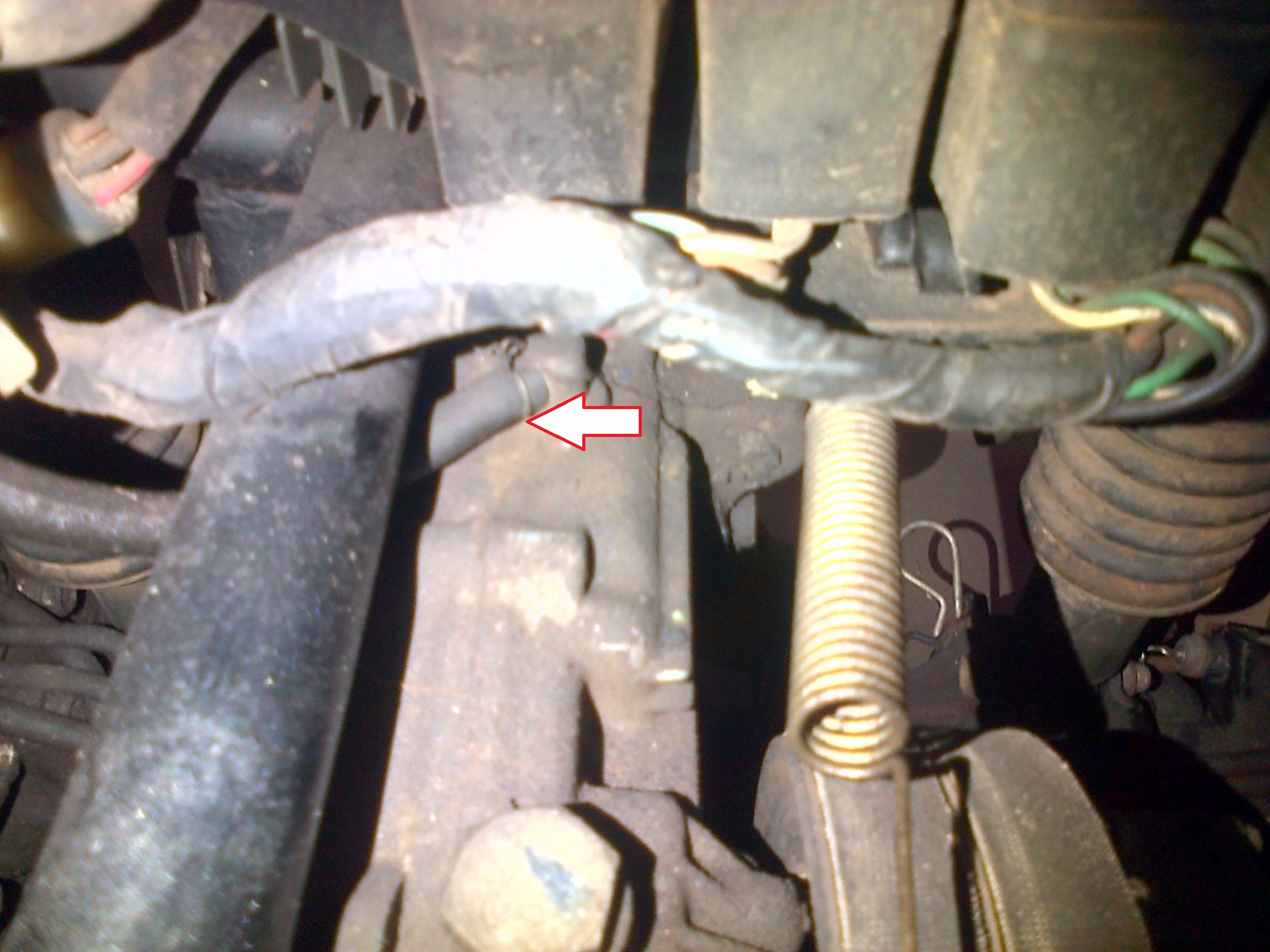

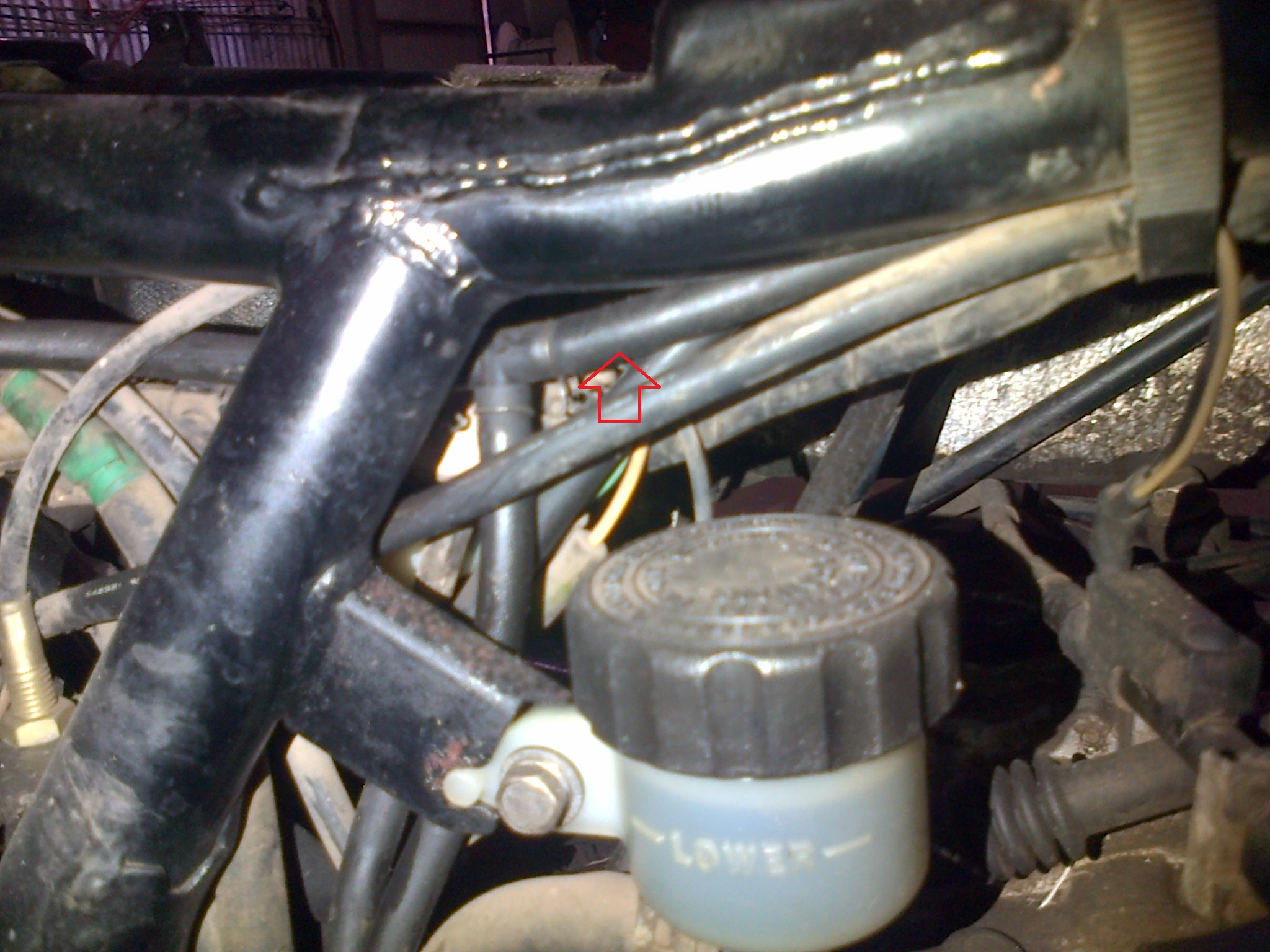

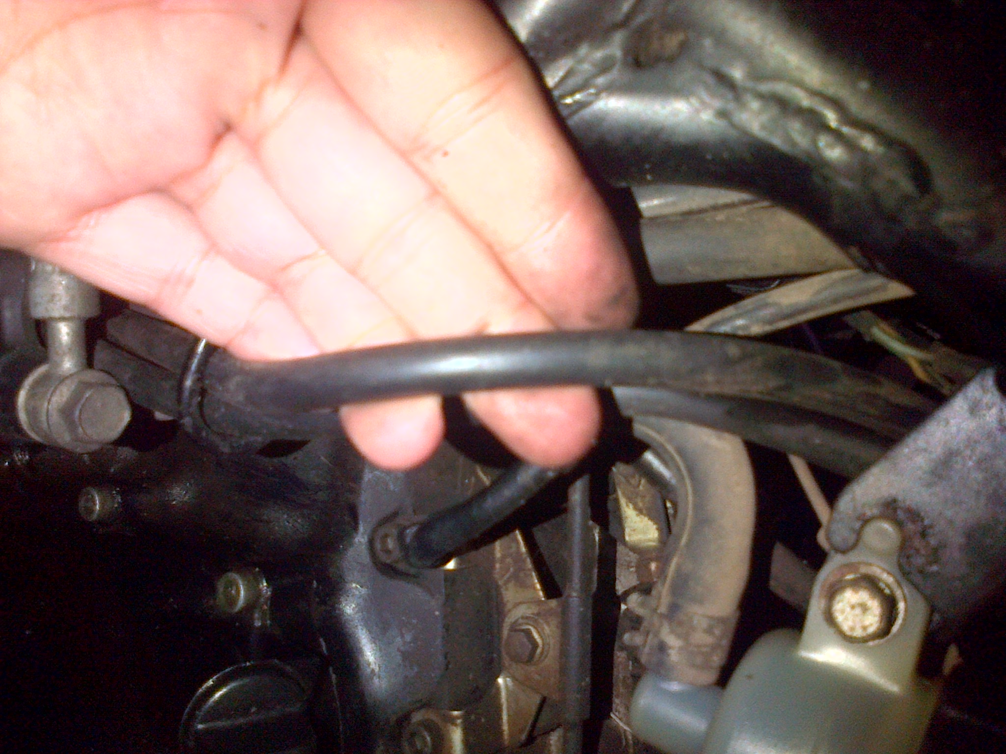

Hello Here are the pictures. hoses run from the back of the ATV and end at the front, where they are disconnected.
IMG-20140325-00055.jpgIMG-20140325-00056.jpgIMG-20140325-00057.jpgIMG-20140325-00058.jpgIMG-20140325-00059.jpgIMG-20140325-00060.jpg
   / Anyone have a Yamaha Terrapro? #64
Looks like breather hoses to me.
Me parece que son para premitir que el aire que esta adentro la transmisión, el eje y tal vez otras áreas se expanda cuando se calienten mientras la maquina esta andando.
Si no tuvieron estos mangueras, podría hacer que salia aceite por los sellos cuando el aire se calientaba y hacer que se chupaba aire (o agua si estaba bajo agua) por los sellos cuando se enfriaba.

If you notice the type of clamps that hold these hoses on are non pressure hose clamps. The wire clamps are only meant to hold them in place. As aczlan mentioned they are indeed vent hoses. The problems that arise with these hoses is that they get filled with mud/dirt from use or insects. You can easily crush the ends and shake the dirt out. The first picture is the vent hose on top of the differential that attaches to the right wheel.
I took all the fenders off mine including the fuel tank and went from end to end to check all those lines. Getting back to the differential. There is a hex plug on top to check the oil level in it. Same with the PTO gearbox.
The bike is purely mechanical and does not have any hydraulics other that the rear brake lines. There are no pumps either. -kid

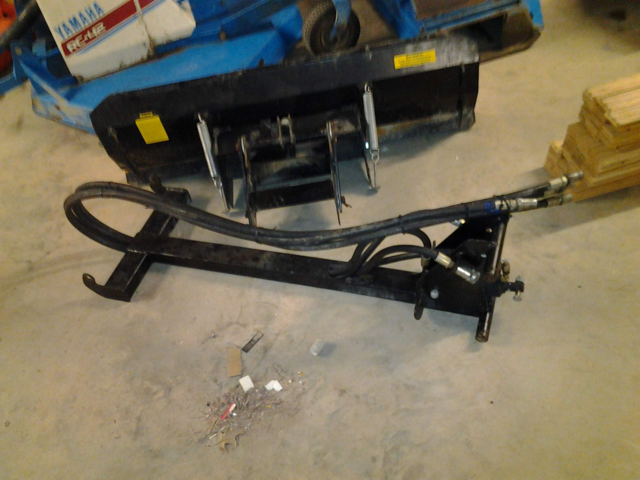

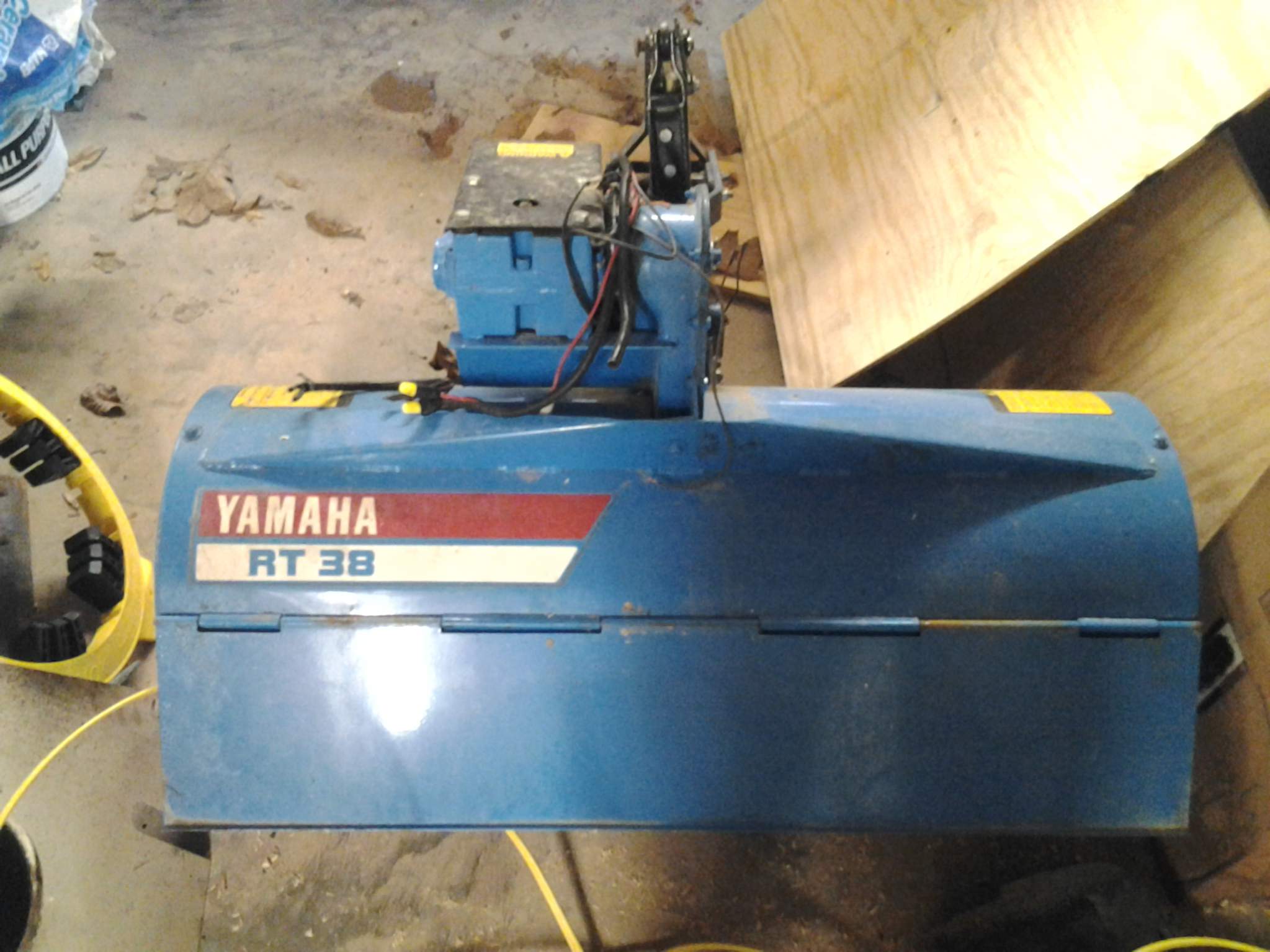

Sorry it took so long to get these. Started spring cleaning today and finally moved some stuff from the winter and a remodel project here at the house so I could get some pics.

Impressive collection of Terrapro equipment. Some of those implements look barely used. Assuming your location is in Alabama. You obviously don't need a snow blower. Good luck with your restoration which looks only to be cosmetic.

Most of the equipment was used very little. The tiller still had plenty of paint on the tines when I got it. The only thing that really needs work is the boom sprayer. I have contacted Broyhill and surprisingly they still had some parts for it.

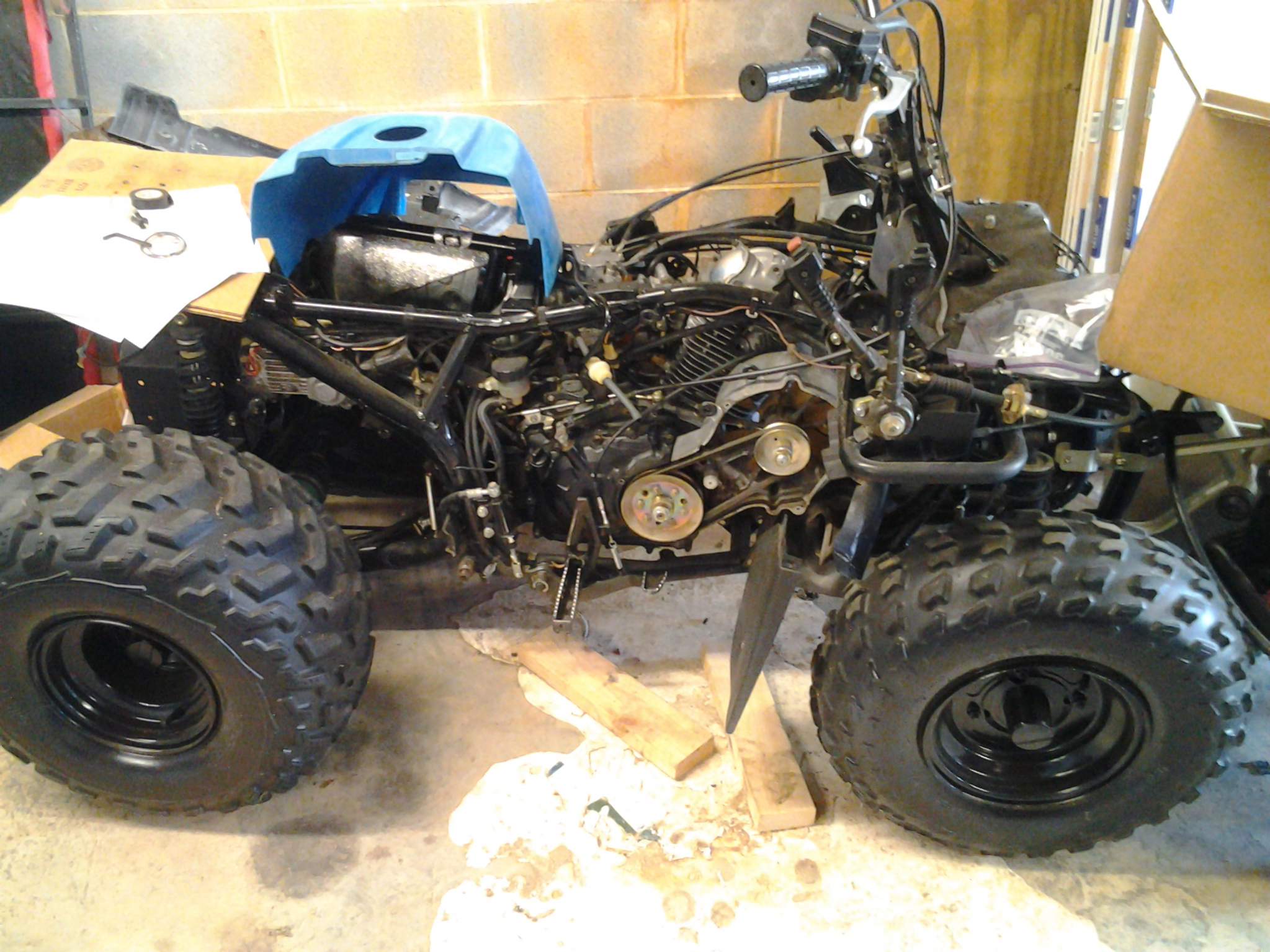

The pic of the Terrapro torn down is the one I am working on. It had sat for 20+ years and the cylinder had cupped where the piston had sat. It smoked bad even though it was a low hour unit. I had to take it apart have it bored and honed with new piston, rings etc. I have never had anything down this far so I hope I can get it back together and get it going again...
It had also been painted, so I will have to get the body panels back to their original condition. I have new stickers to go on it once the body panels are ready. The racks were painted with rhino lining. Not looking forward to having to get all of that off; may see if they can be sand blasted to get it off.

Here's a picture of my first one when I had it skinned down.
