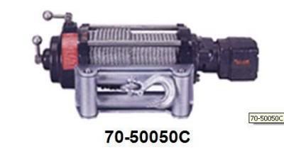

Hi,
Anyone with a Mile Marker hydraulic winch that can tell me what the make and model of the hydraulic motor is? Please let me know your winch's rating, too.
Thanks.
   / Anyone Have A Mile Marker Hydraulic Winch? #2
I just bought their 70-50050C series 10,500lb rated pull winch. It's at camp and I don't have all the details on the motor. Sorry. I haven't even made the mounts for it yet.
It does say it uses 3.5 gals/min at 1500psi and is a 17.9 C.I. hydraulic motor if that helps?

Thanks. The tech at MM claims that 1500 PSI is the absolute max rating for the motor. I am trying to find out enough information about the motor to determime or confirm its max rating. If it is higher than 1500, I will be happy. If it is truly 1500, then I may see if I can find a higher pressure replacement at a reasonable price. If I can, I will order the winch.

My hydraulics' relief valve setting is 2275 psi. That is my concern. I have thought about putting some sort of relief valve in the winch circuit, but that is an additional complication and added plumbing. It might just be easier to change out the motor.
First step is to find out what they are using for a motor.

I have a 75-50050C, which is the same as 3RRL's except it powers in and out. I just looked and the motor housing has "Roller Stator CF" cast in relief on the end. Otherwise, there is a plate with a Mile Marker Model number and serial number. In addition to the pressure, you will also have to make accommodations for the solenoid valve as it is rated for 3.5GPM max...
