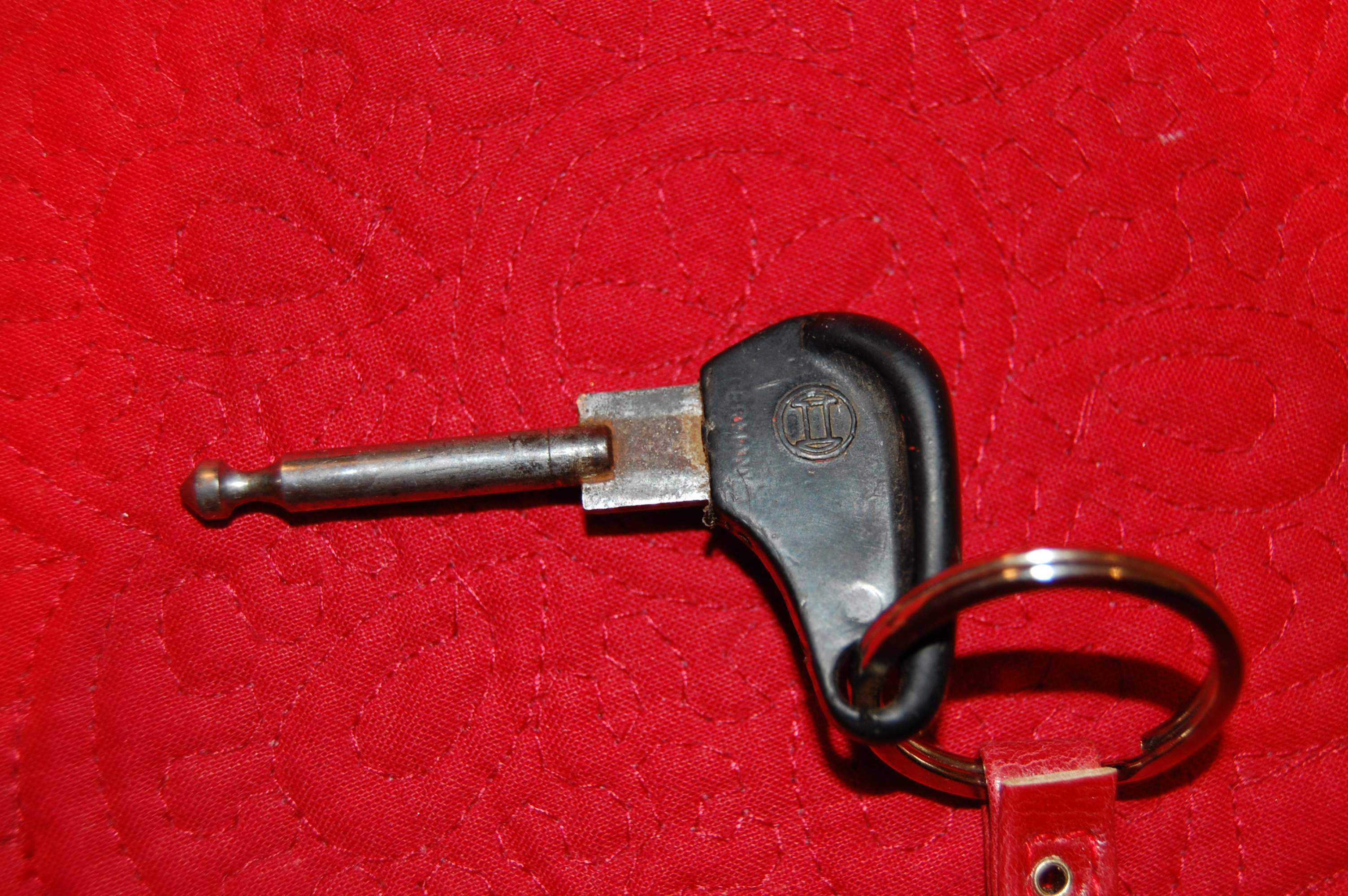

Hello all. I have a 1020 that was made in Mannheim, Germany with a serial number of 020238. It is a 3 cylinder diesel with a loader. I was told that it was built in 1969. It only has 1 key and it is very strange looking. The local JD dealer told me that they had never seen a key like that and many parts for the German made tractor are different than the Iowa made ones. Anyone familiar with these tractors? It looks the same as all the rest. I will be needing to have some leaks fixed, etc this coming winter. I hope that the hydro pump in the front of the tractor can be rebuilt with new seals, because it is leaking. I would really like to have a spare key also. Thanks

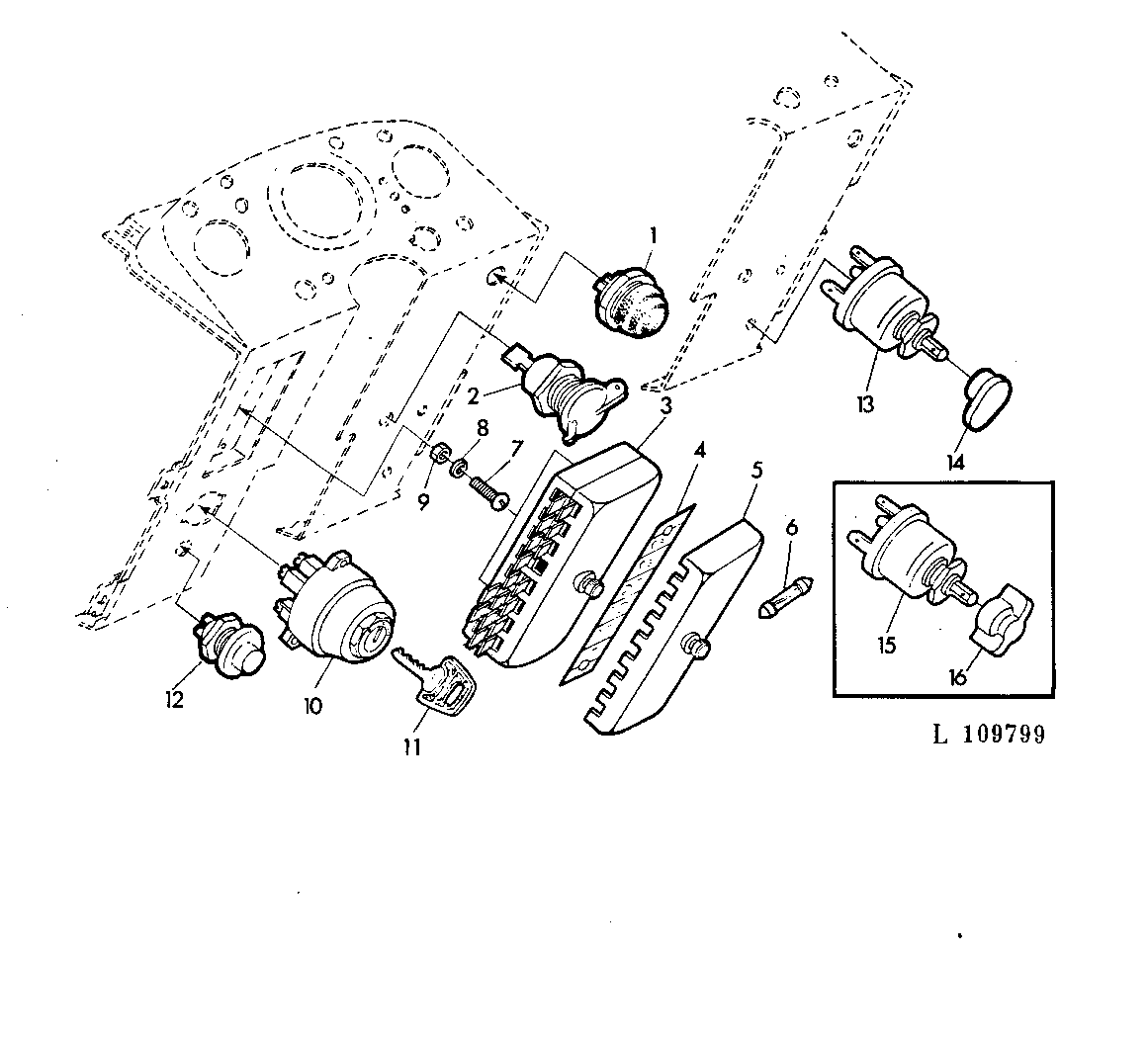

Here's the ign key for your tractors SN L22964 Key - KEY ADD 12.40 USD
RE228042 Hydraulic Pump - HYDRAULIC PUMP, HYDRAULIC PUMP OVER View/Update 43.99 USD

I vaguely remember changing my ignition switch to one I bought from NAPA, solved that problem. Your dealer should have most of the parts you will need for this tractor as quite a few of these were sold in the USA. These were built for the US market so nothing to be concerned about as far as being oddball.
   / Anyone have a German-made 1020?
Wow. Good news about the pump and tractor! I will post a picture of the key. It must not have the original ignition switch, even though it looks very old. I saw a rebuilt pump on Yesterday's tractors for over $1000!
