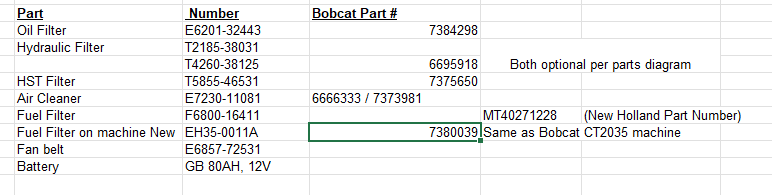

It appears my local dealer has went out of business and the other dealers are over an hour away and I would like to be able to source the fuel filter for my CK4010 from somewhere else if possible. Preferably a Wix or similar. Has anyone had any luck with crossing this to a more readily available part number? Thx.

Sorry to bother you but I have an issue with my CK3510 fuel filter. The stock filter has a visible cup for checking water or debris but non of the new filters have the cup. Any ideas what to do with the electric cable that was on the filter?

The new one should have the water sensor on it as well. I have never see one made for the CK without it. I would double check that you got the correct replacement filter.

This is what I have in my notes for my CK3510SE.

Per mitch8628's list, the MT40271228 actually crosses to Wix WF8395... $10 from RockAuto so you bet I'm gonna try it.. :LOL:
