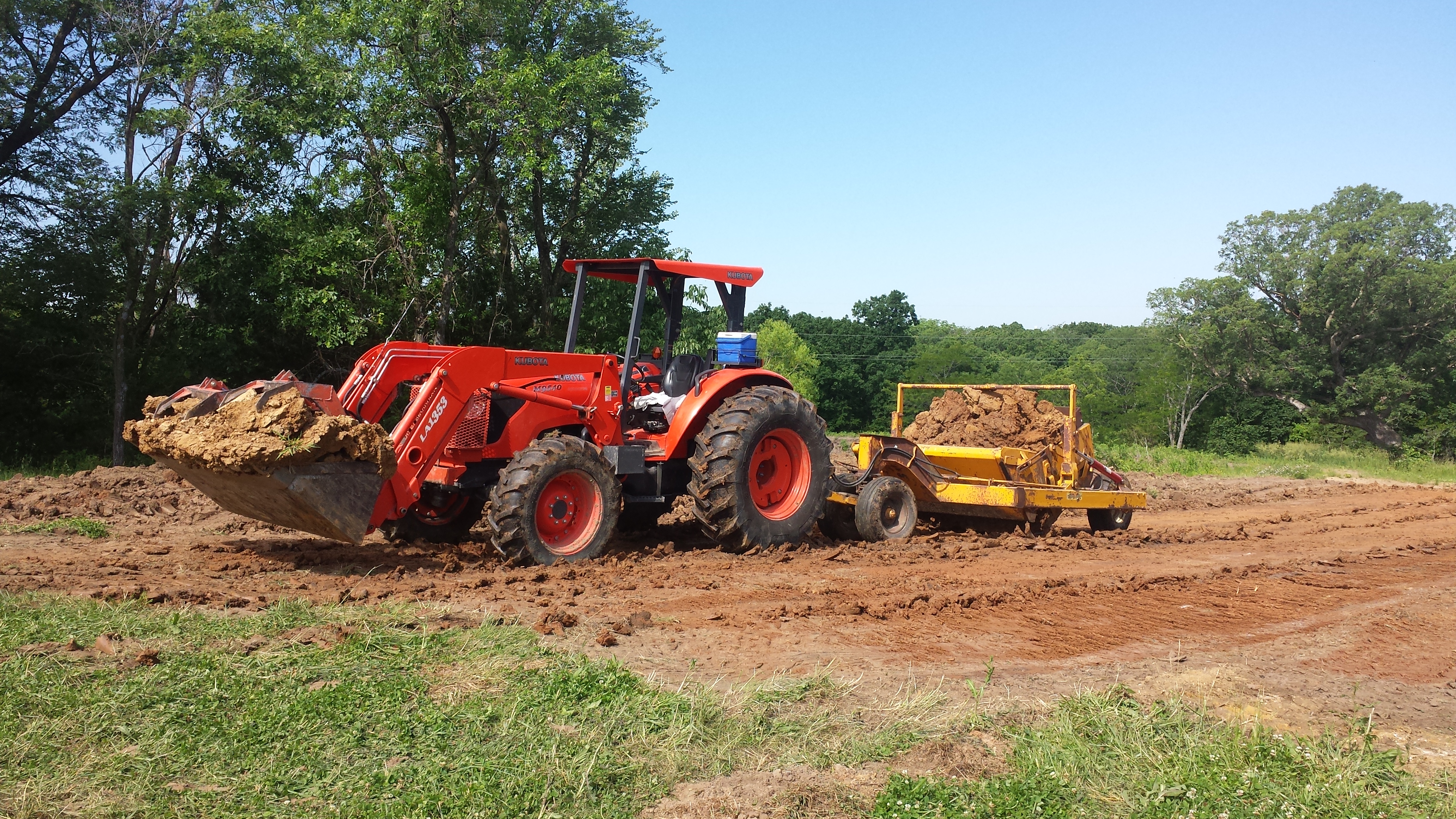

Not that I can afford anyway. I paid $4700. Thought that was plenty til I started using it. "Dirt Cheap". I've hauled hundreds of loads of dirt. Nothing can do what a Scraper can do. :)

That is amazing! What type and size is that? What is the "proper" or common name for these?

It's a Midland brand. 5yd. In this size you can find this type or "no front tires type. Tractor carries half the load. That's actually what I was originally looking for. Much better for small ditch filling in fields cause you straddle the ditch. I like this type just fine and learned how to approach ditches and fill them with minimal issues.
These are considered "Clam Shell" Scrapers. They dump by tilting the bucket forward. Doesn't have an ejector gate to push the dirt out the front. Only requires one set of rear remotes. Simple. Effective. Efficient. :)

Never seen one of those before. Neat. Along this line here the tractor pulled dirt pans using two with one behind the other to replaced the self propelled machines. Forgot the HP tractors they pull them with but think it was 400 something.
