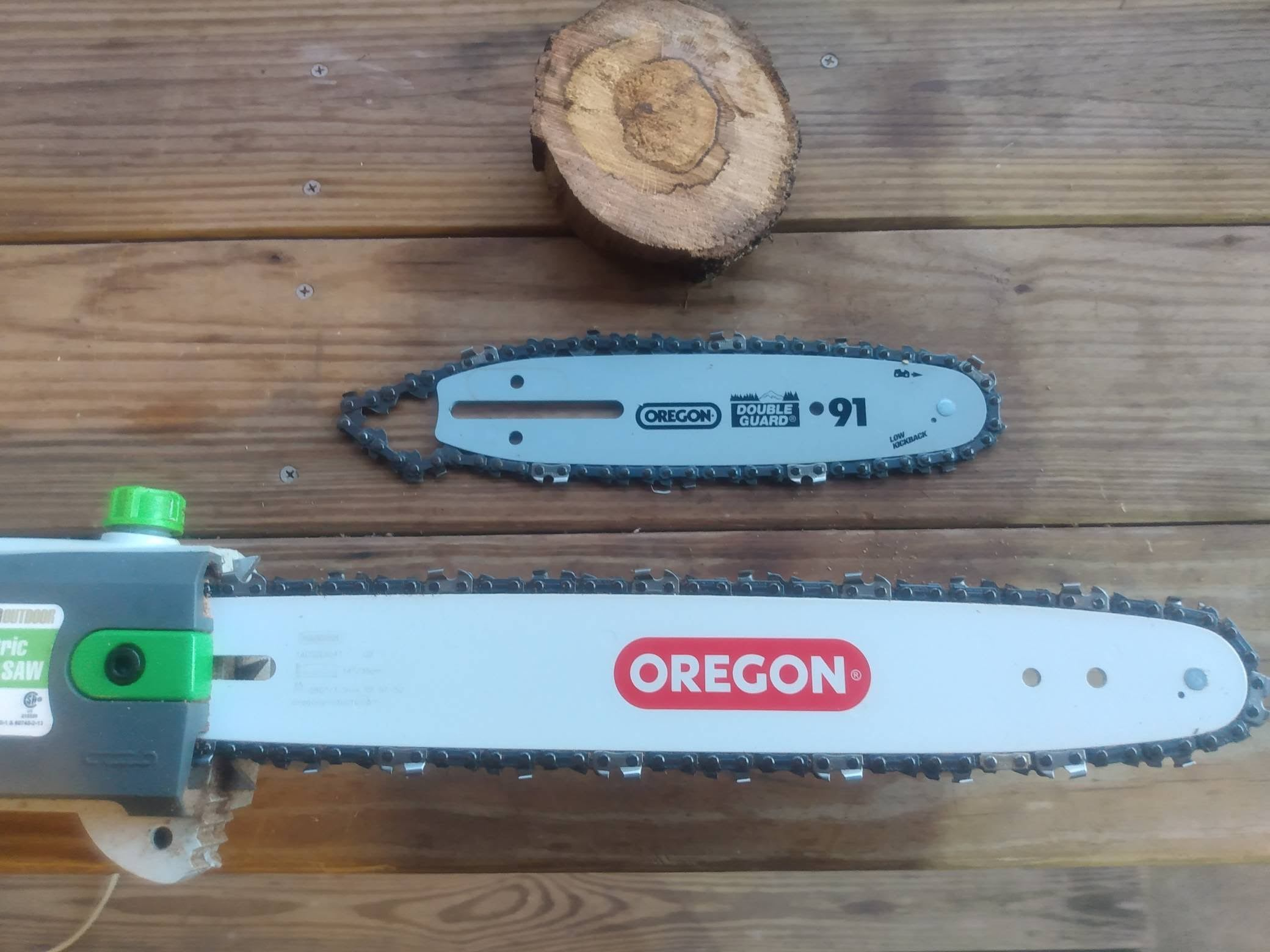

I recently cut down and removed two 30-inch trees (Oak) which were 60 feet tall. No gas involved. Used a Ryobi 40-volt, 18-inch saw, a couple of 120-volt saws and a modified Harbor Freight corded pole saw - added an 14 inch bar to it. Threw in an 18-volt Ryobi reciprocating saw now and then.
The battery powered manlift has power in the bucket - That Harbor Freight pole saw allowed me to be "away from the action" without having to worry with starting, fuel or batteries. It's also great for bucking/limbing on the ground - NO bending over. One of mine is 11 years old and has been through hell - Even strapped to a piece of fence top-rail and hauled up into a tree, on a rope, to cut some 25 foot high limbs a time or three! (You need a helper to plug/unplug it on command, though. And, the ability to judge/dodge falling limbs!)
Even rigged up a 2000 watt inverter to mount on the brush-guard of my tractor so that Harbor Freight saw can go anywhere the tractor can.

Forgot I had this before/after photo of the Harbor Freight pole saw. Sort of a Big D and Little D thing, huh?
