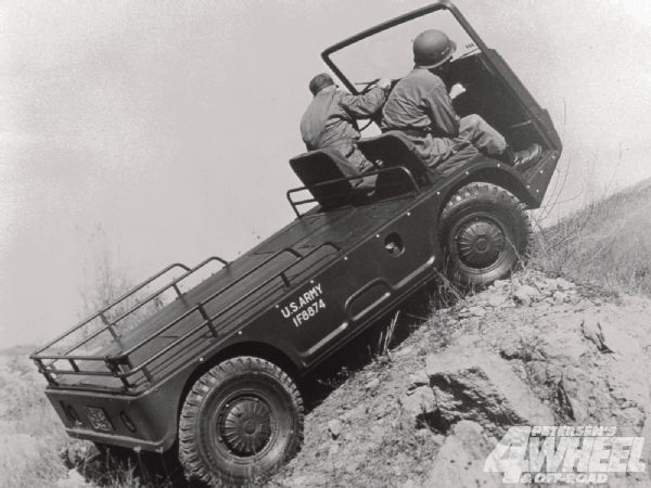

"Super Mule"

This picture makes me think of those UTV's that Torro sells. I see them at commercial sites and if there was a dealer close by, I would have looked at one for sure before buying my Mule. The bed is much bigger, and for me, that's a huge selling point!!

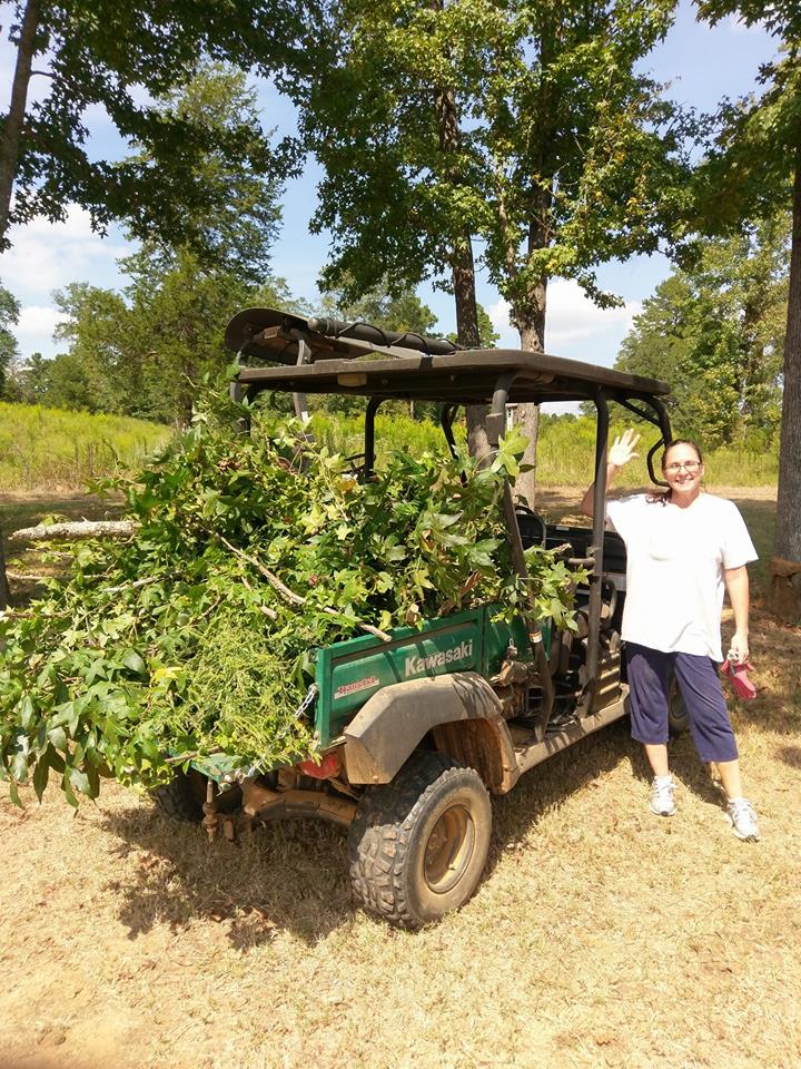

This is one of many loads of branches, weeds and cuttings from over the weekend that my wife and I loaded up in our Mule. Just backing it up to the burn pile, pushing a button and the bed lefts, and dumping it, is something that once you do a few times, you will never want to to do it any other way. Almost as nice as a loader bucket!!!

Good points on the size of the bed on these vehicles.
If they can lengthen the vehicle to add room for a second row of seats why not lengthen to make a bigger bed?

My back seat folds down and my metal bed is big enough to hold a pallet. With the tail gate open, I can haul full sheets of plywood, with about 3 feet hanging out. Same with 8 foot boards. Longer then that and I'm either weighing them down, or using something else to haul it. T posts and corner posts are easy to haul around with it.
I have an 8 foot bed on my truck. If I could get a longer bed, I would. Might get a flat bed for my next truck, I always fill it up and doubt there is such a thing as too big. I just couldn't live with anything less.
