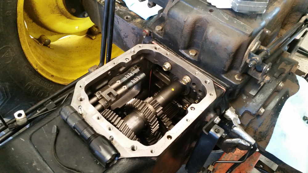

Looks like you can get to the parking pawl through the side access plate. Still not sure if the broken parts can be replaced without splitting the transmission from the rear differential but at least I can inspect it from there.

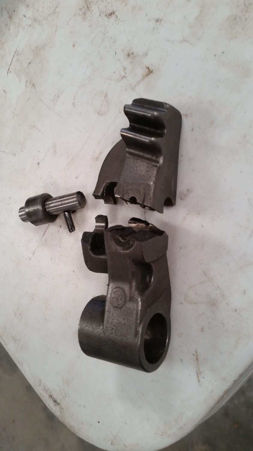

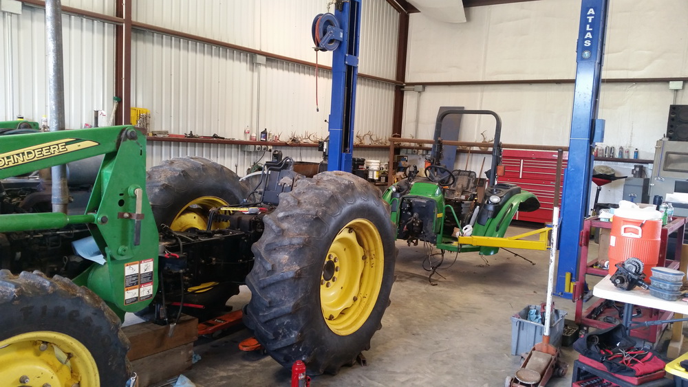

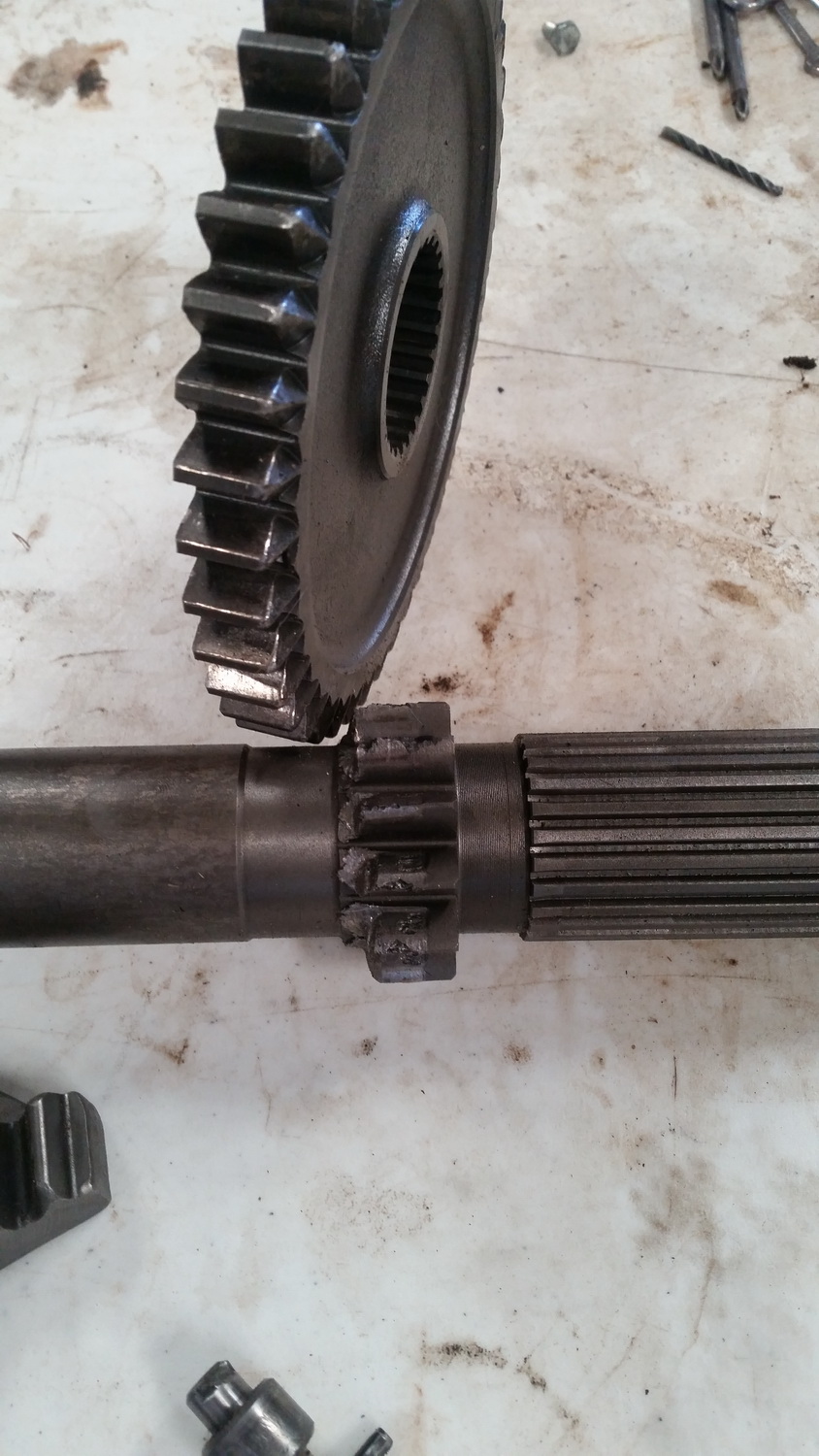

Here is the conclusion to this story. Parking pawl was indeed broke off. The two big pieces made their way to the back and bottom of the transmission where they stayed for about a year while I continued to drive the tractor without any more damage. However, a couple of smaller pieces got ground up in the transmission. I had to replace the A range drive shaft and one other gear. They worked just fine and I probably could have gotten by, but if you are going to split a tractor, might as well do it right. The platform with the seat, ROPS and dash came off as one piece and had to be lifted off the tractor. Then it was split at the rear of the transmission where it joins the rear end. Parts, including parking pawl, gears, new O-rings for all the lines and gaskets came to $1200. Labor was $2000 so it ended up being a $3200 repair.
As to how it broke, well the tractor was being driven by someone other than me. They said "it just broke" but I'm sure it was jammed into park before it was fully stopped. That's how they break.
Gary
   / Anyone ever replaced the parking pawl on a John Deere 5420?
And some pictures. This is not a simple repair. I hired an experienced transmission mechanic to do the work. Took him the better part of two weeks although he was doing some other things during that time.

At first glance that casting broke in its thickest portion. But the thing is full of cavities! I imagine you'll be gentle with it from here on in. Thanks for the follow-up.
