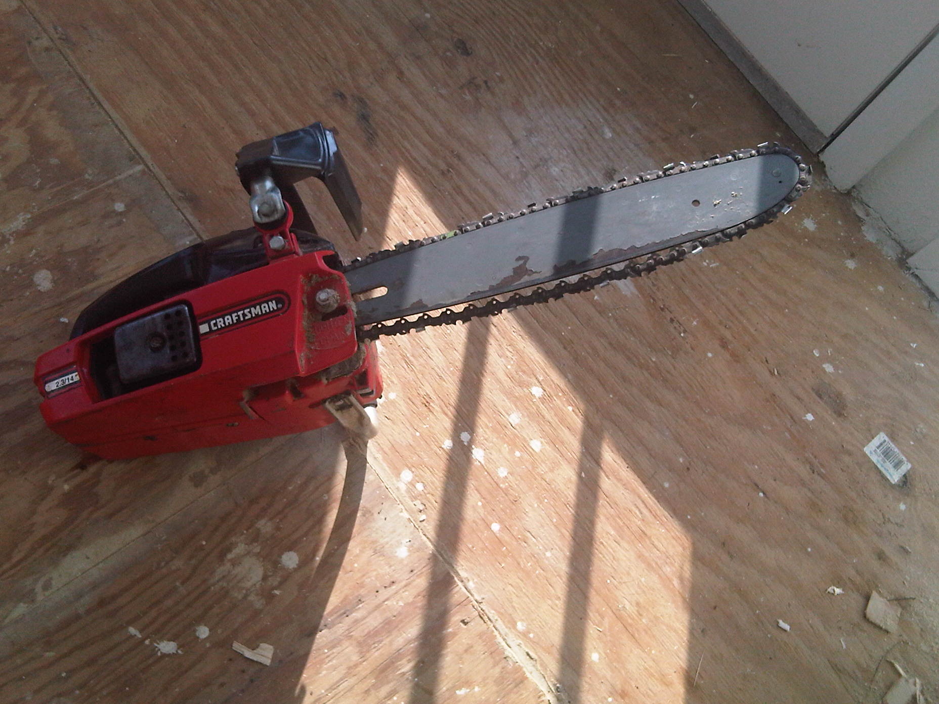

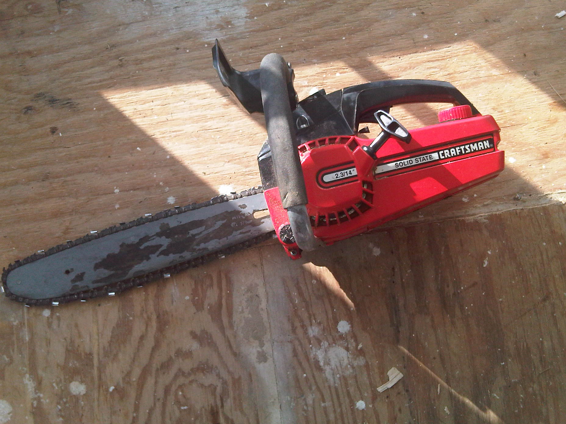

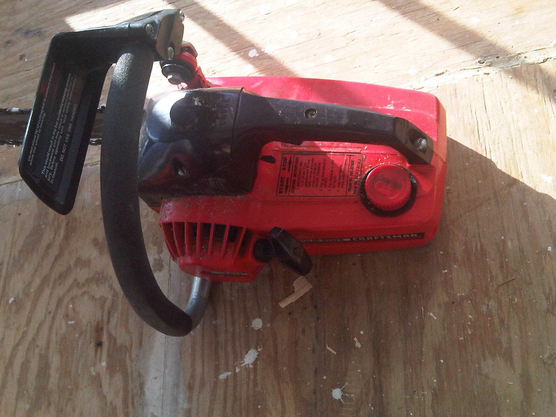

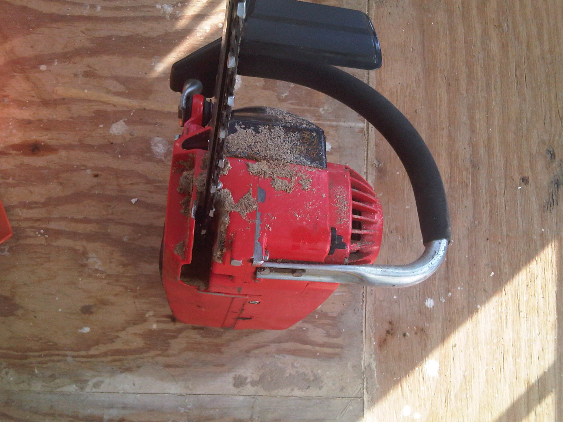

As requested, here are some pictures of the "dearly departed".
On the left side (as you would be holding it) it says 2.3/14" then "solid state Craftsman"
Model number and serial number are on the top below the grip, next to the gas cap. Model number 358.353660 Serial #20513062

Tenn_Blue, the saw you have is the same a the Poulan microXXV; plenty of parts still available for these. Do a search (internet, not necessarily TBN) on the poulan model, you should find plenty of info; you may want to try jacks small enginges, they do have a website, you will also be able to see all of the moving parts when you use their site.
