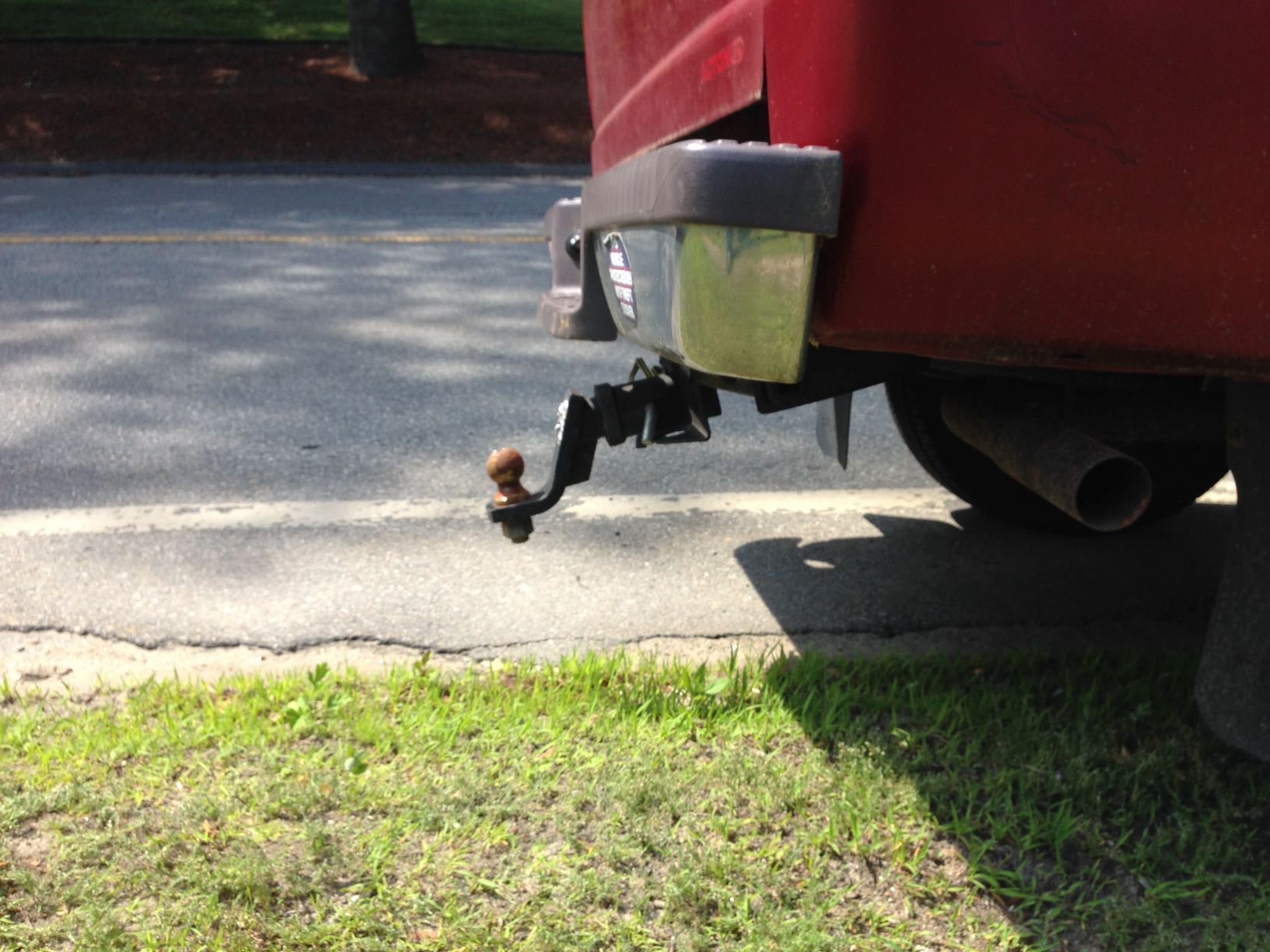

Anyone ever purchase something like this??

I wouldnt use it. Your vehicle bumper is designed for impacts, your hitch isnt.

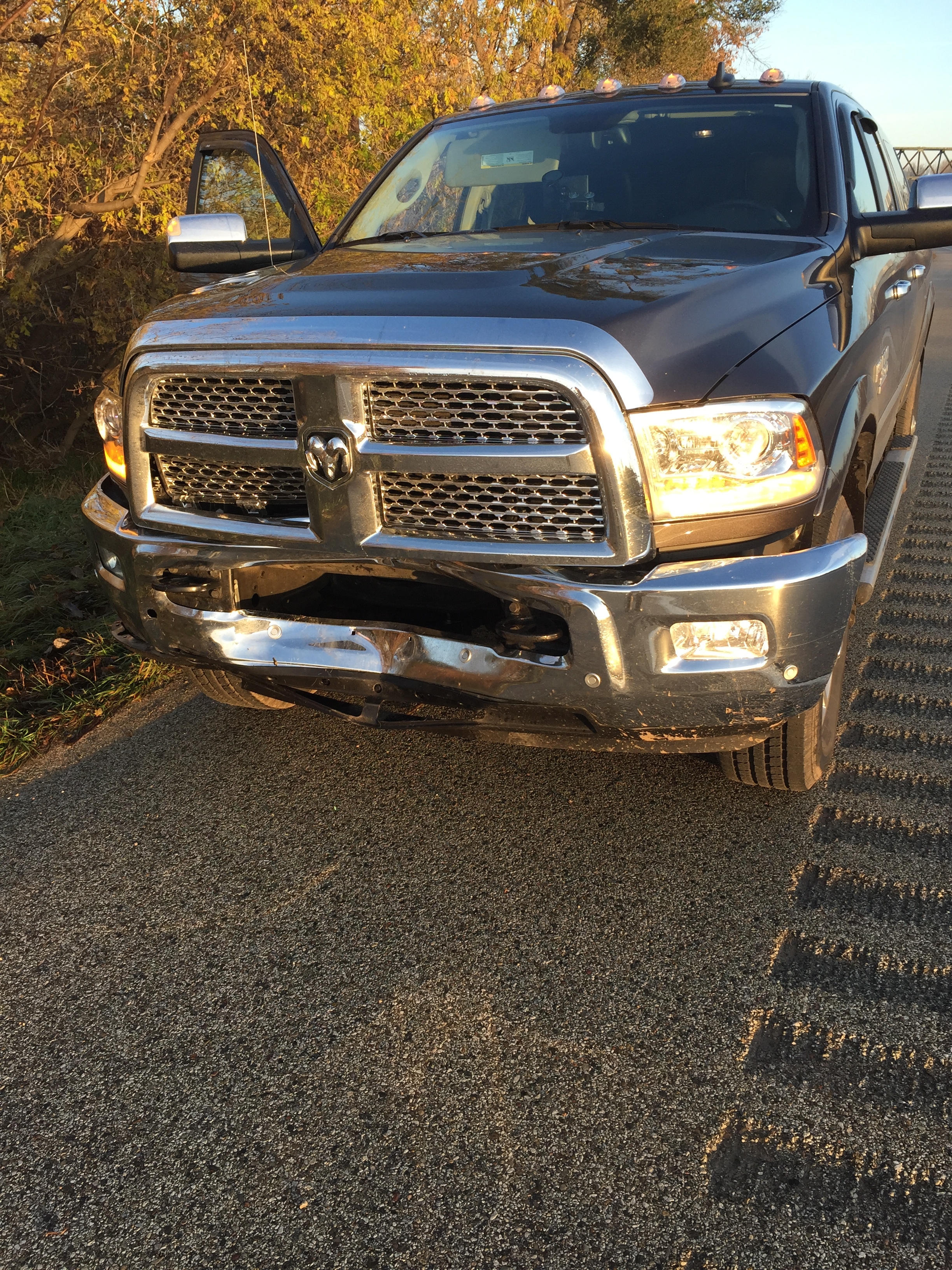

Agree on that.As stated in a earlier post looking for the idiot texting (SLOW SPEED 5-10 mph)on there phone that gives the ***** end of my truck a love tap.I believe my bumper might be the winner in my 3/4 ram if they hit me a little harder.Pics of the front bumper hitting a deer going 70-75 mph.

From experience I would not trust it.
In stopped traffic lady hit me from behind. Said her flip-flop slipped off the brake pedal. Her frame rail end to hit my hitch. The hitch bent down twisting the end of the frame rails.
Had she been centered would have been a clean radiator shot.
Without the hitch it would have been shock absorber or crumple piece in the bumpers. And a bunch of plastic on the car.
That’s not the first time I’ve seen that happen. Do you think it would have still bent the frame with a straight hitch vs the drip hitch?
