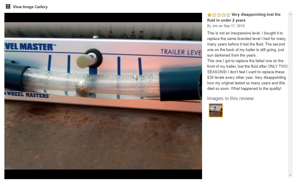

I'm actually intrigued by that level in the picture since it looks to be indicating level with the center at the bottom than the top of the arch, which makes me think it's using something other than air for indicating level. From what I've typically seen levels using air bubbles would normally be bent the other way in order to use the buoyancy of the air to indicate level. In that picture it almost looks like an object/substance denser than water is being used to indicate level with center point being the lowest point rather than the highest.

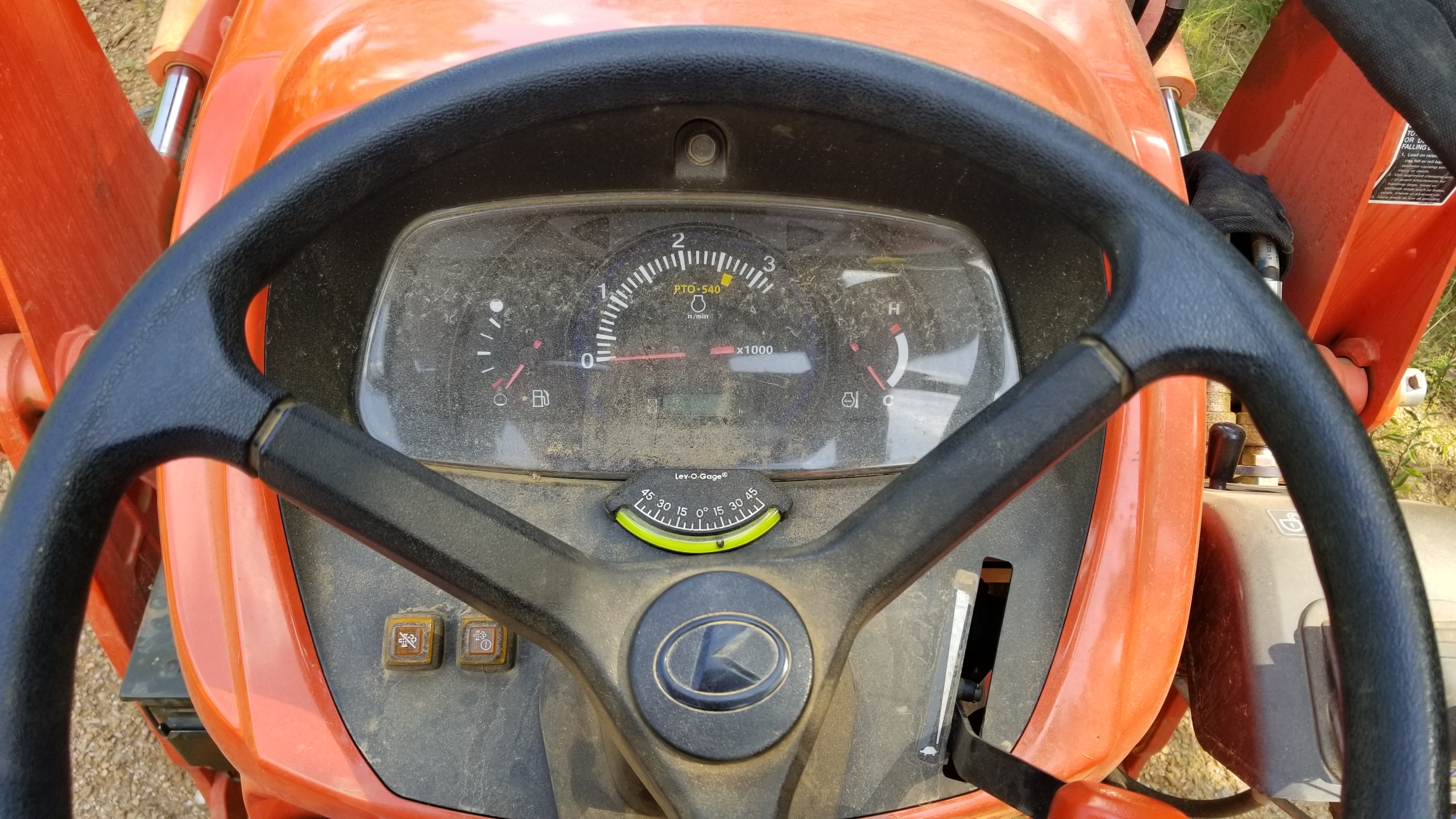

Then I'd have to get on and off the tractor repeatedly. I've already tried a magnetic torpedo level, it falls off almost immediately.
@8182, that plumb bob ain't a bad idea
