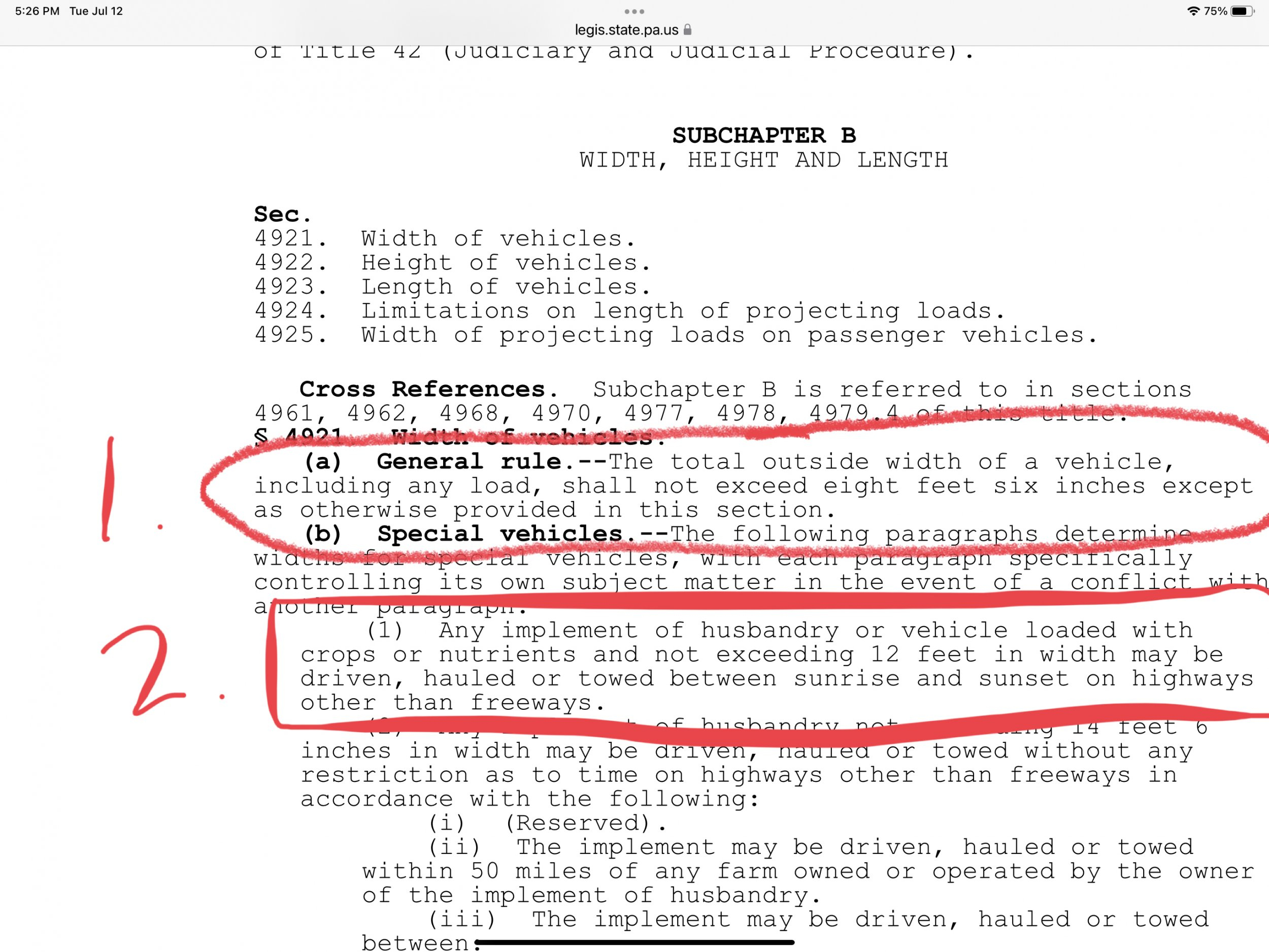

Here ya go genius.
1. Last time I checked 8 feet 6 inches is 102 inches. I live in PA and follow PA’s laws. See below.
2. Furthermore, 12’ IS LEGAL legal for vehicles carrying crops like hay bales.
Look who’s FOS now?

From the DOT/FHA website:
WIDTH REQUIREMENTS​
The maximum width limit for CMVs on the NN and reasonable access routes was originally established at 102 inches, except for Hawaii where it is 2.74 m (108 inches). (See discussion of Reasonable Access on page 12.) To standardize vehicle width on an international basis, the 102-inch width limit was interpreted to mean the same as its approximate metric equivalent, 2.6 meters (102.36 inches) (Figure 1).
Federal width limits do not apply to special mobile equipment, which consists of self-propelled vehicles not designed or used primar-ily for the transportation of persons or property and only incidentally moved over the highways. Special mobile equipment includes the following, when moving under their own power: military or farm equipment; instruments of husbandry; road construction or maintenance machinery; and emergency apparatus, including police and fire emergency equipment. Federal rules do not require States to issue overwidth permits before allowing operation of special mobile equipment. However, if States wish to allow other vehicles more than 102 inches wide (i.e. non-special mobile equipment) to operate on the NN, then States must issue special overwidth permits.
So, unless you operate in Hawaii, maximum width is 102 inches.
HOWEVER, having operated a couple of trailers with Conestoga kits (sliding tarp systems) on them which were ~ 106 inches wide, I have never heard of anyone with one installed being written up for being over width.

The regs say 102. Have a copy here. Various states can alter the max width requirement but on an interstate highway, the 102 applies.
Why I called Hay Dude on his comment. I know what it says. No way anyone is legal on any road (without permits) hauling round bales side by side if they are 5 footers. You might get away with it for a while but sooner or later you will get pinched. Not legal and never will be but then it's up to the officers discretion.
