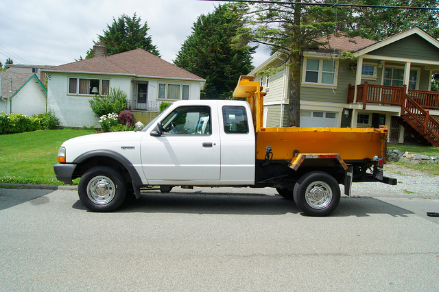

   / anyone ever convert a truck be to a Dump bed?
#58
Now here's one I would've never imagined,
