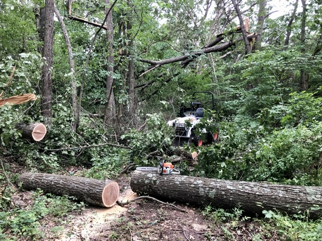

So far, so good. I’ve got it to work. I just have to really push down hard on the brakes. It stays locked. From the warnings on the above posts, I’m being much more careful about lowering the bucket and using that for a brake also. For whatever reason, it seems like a lot of my tractor time is getting in and out of that seat. Hooking up chains lately, and hauling out all the downed timber from this summers wind storm. 100 big trees down.
