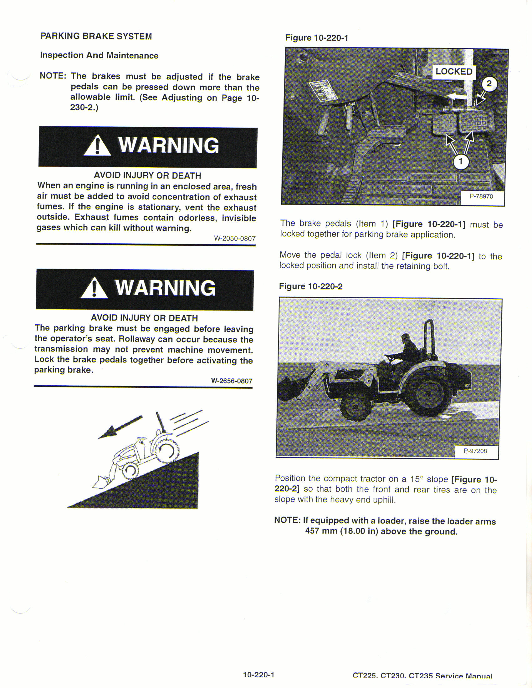

What’s the secret to adjusting the brakes, so the parking lock (or whatever it’s called) work? Wouldn’t stay on at all, tried some adjustments and now it will hold, but it’s really sensitive. Plus I’m pushing down pretty hard. Only have 220 hrs on it, I doubt It’s worn out. Lots of hills here. I need that parking brake, plus starting the engine again and again, can’t be that good for it.

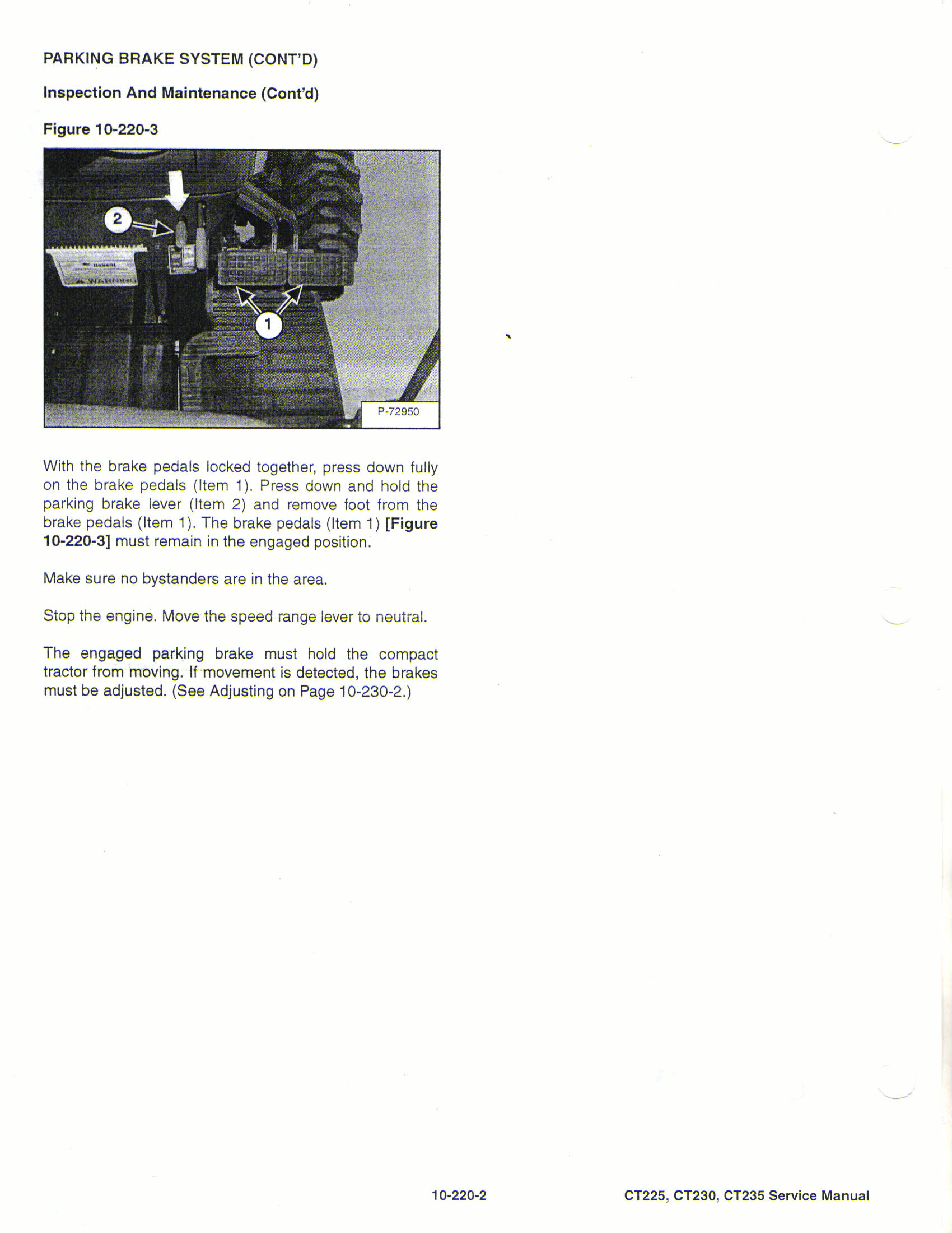

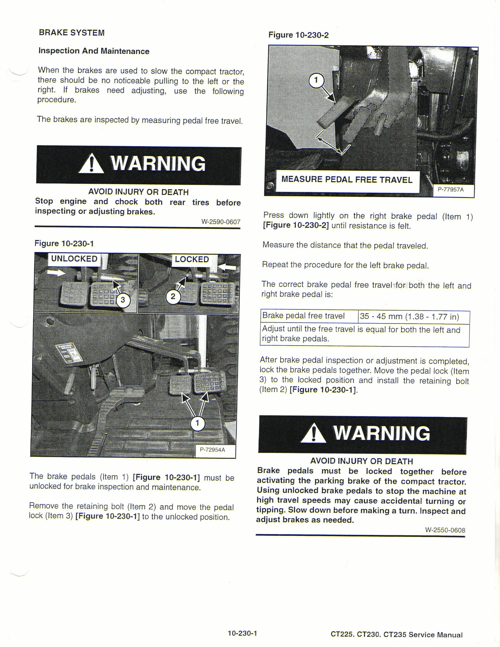

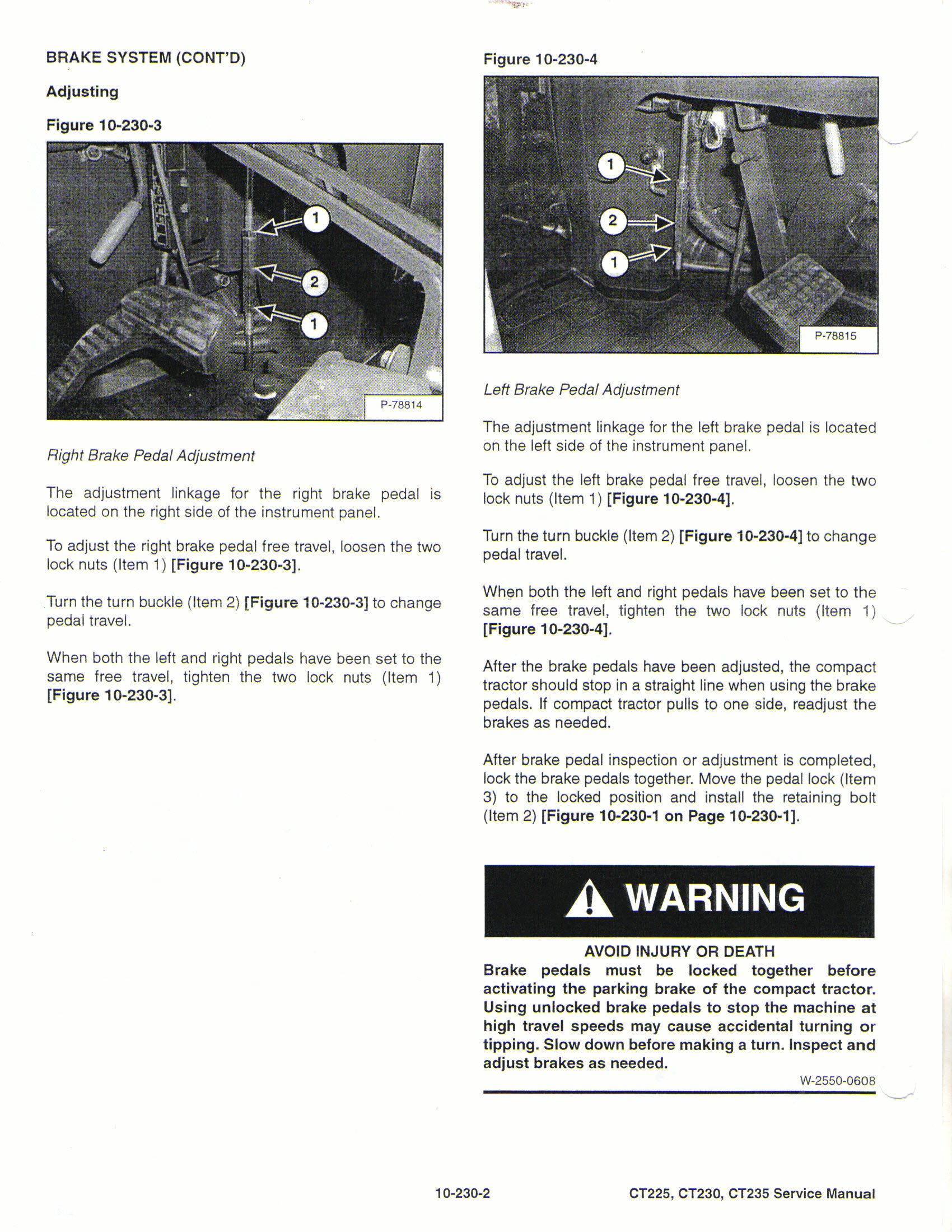

Not sure it will help you much but here are instructions from service manual. I have them in reverse order.

On most tractors the brake pedal hold down is just a bar that has notches in it. Check the bar. If needed modify the notches to be a more positive contact to the pedal
   / Anyone else have trouble with the brake lock?
I’ve tried to get a good look at it. There are three notches in the bar. They appear to be fine. The plate that drops into the notches looks ok. Mine started off popping off a time or two. It evolved into just not holding at all. I’d shut down and use the loader to hold the tractor as best as I could. I have it now where I can get it to lock the brake. It’s just very tricky.
