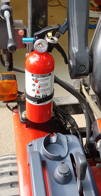

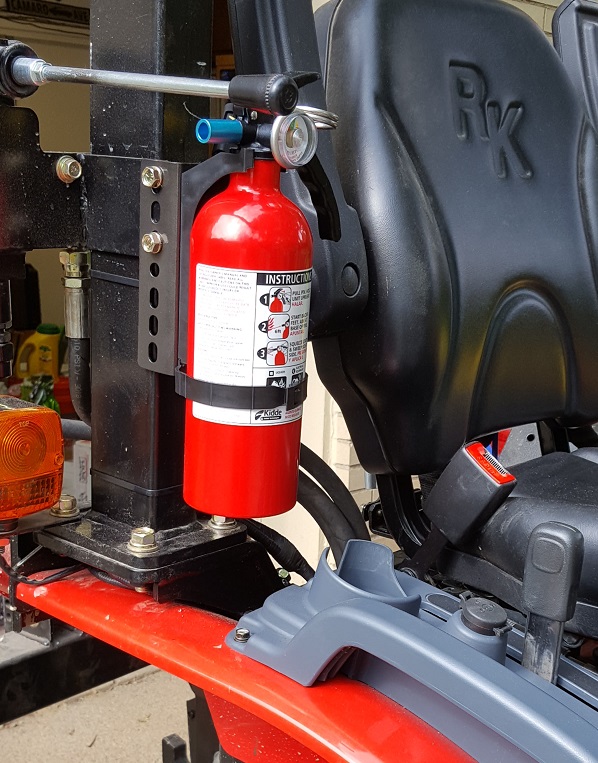

New addition to my RK24 this weekend.
Extinguisher: [$25] https://shop.advanceautoparts.com/p...60mtl/11842354-P?searchTerm=fire+extinguisher
Bracket: [$4] https://www.lowes.com/pd/Hillman-1-ft-x-1-5-in-Plated-Steel-Slotted-Angle/3053613
SS Hardware to Bolt Extinguisher to Bracket: Had On Hand
Hammer-Black Spray Paint for Bracket: Had On Hand
Total Cost: ≈$35
Total Time: ≈30min

Reasons I located mine where I did:
1. Within reach from seat. (In case I can't get out of the seat for some reason and need it.)
2. Within easy reach to grab when hopping off tractor. (Don't have to reach near potential flames (engine area) to grab it.)
3. Within envelope of ROPS in case of roll over. (To prevent damaging it.)
4. Out of the way of passing low branches. (To prevent damaging, dislodging, or discharging it.)
5. Pointed away from operator. (In case of accidental discharge.)
6. It fit there. :laughing:

Good thought process, and install
