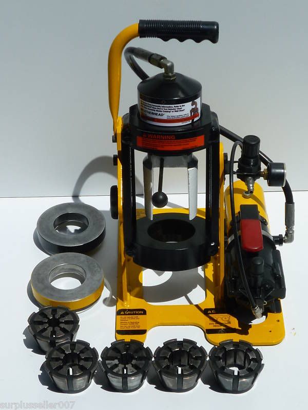

There is a Coll O Crimp setup available for shop presses, here's a link to Eaton's info for it:
http://www.eatonhydraulics.com/products/pdfs/W-HYOV-MC002-E2_Equipment_368-447.pdf
They aren't inexpensive though. I was watching one with four die sets on eBay a while back and it ended up going for ~$400. That's not outrageous, but we paid about $700 for a complete portable Coll O Crimp with three dies on eBay. We use it every day at work....very handy. The portable ones are available with hand pumps, or pneumatic hydraulic pumps. Ours is pneumatic, and we use it on jobsites with a carry-around DeWalt gas powered air compressor. Our crimper is like this one:
Used crimpers are on eBay all the time for under $1000, and can be found elsewhere as well. Before we bought the machine we are using now, we were dealing with a gentleman here on a couple of used, (but like new), machines:
Used Surplus Crimpers
